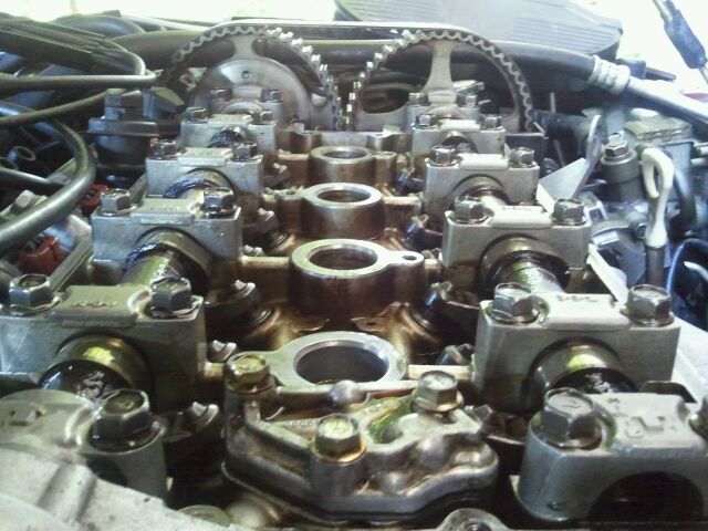

well compression test results are #1 162 #2 158 #3 0 #4 149..going to pull the valve cover tomorrow morning and see if any rockers fell off and also look to see how the valves look. Wet test (for the hell of it) made no difference for the #3 cylinder
BW8776, e-85

Re: 3/4 cylinders
Well all the rockers are still in place. Coolant level is still good and no oil is mixed in and vise versa. During the test it cranked over way faster than all the other cylinders, just because no compression i'm guessing.
BW8776, e-85

Re: 3/4 cylinders
With zero compression I'm going to guess a bent valve. Any broken springs? At this point you pretty much have to take off the head anyway.

Re: 3/4 cylinders
No broken springs from what I saw at a quick glance.

Old 08-16-2013   #17
Re: 3/4 cylinders
Just take the head off.
