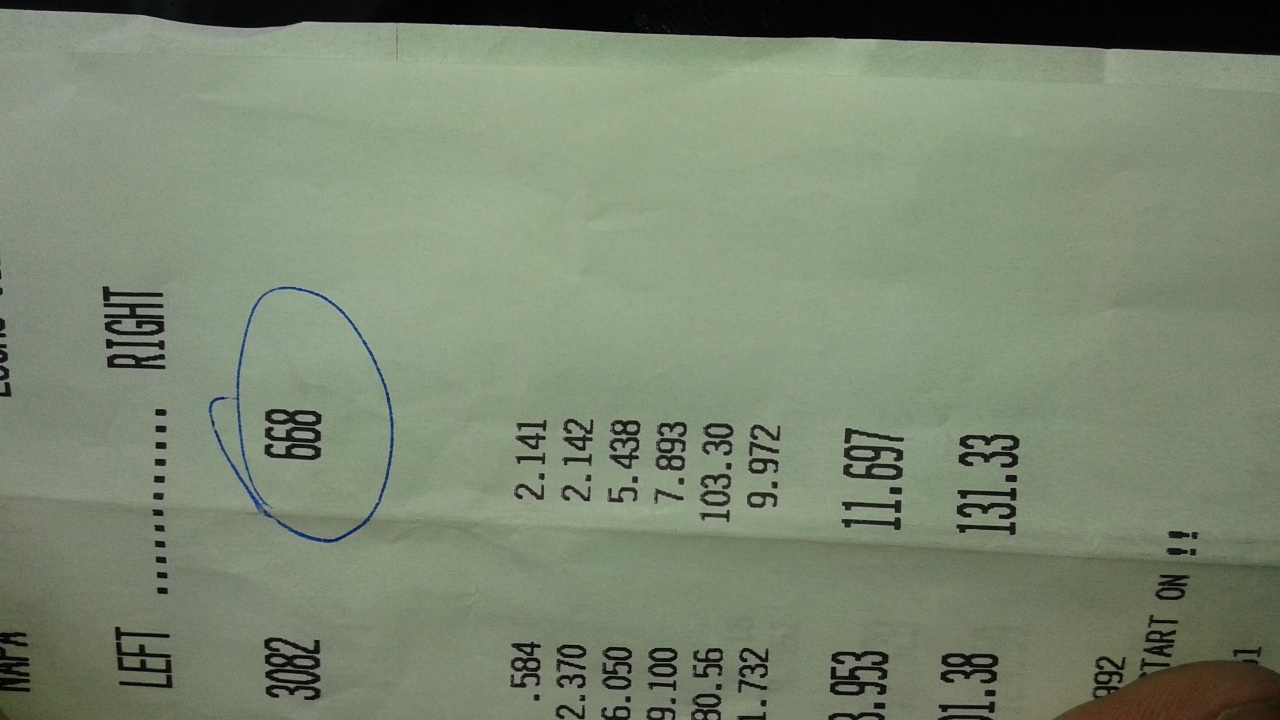

11.6 @ 131 mph, 2nd run (best run) in this car.
Real happy with the trap. 60' obviously needs work, been spoiled with awd in the past. RWD feels like a different animal. Either way still happy with mid 11's.

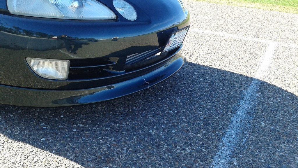

First "thing" that happened was we fucked up the front lip taking it off the trailer. That was super sucky, but it sort of fell back in place fine so it's not so bad. maybe I'll just get some carbon fiber band-aid stickers or something as a funny fix.

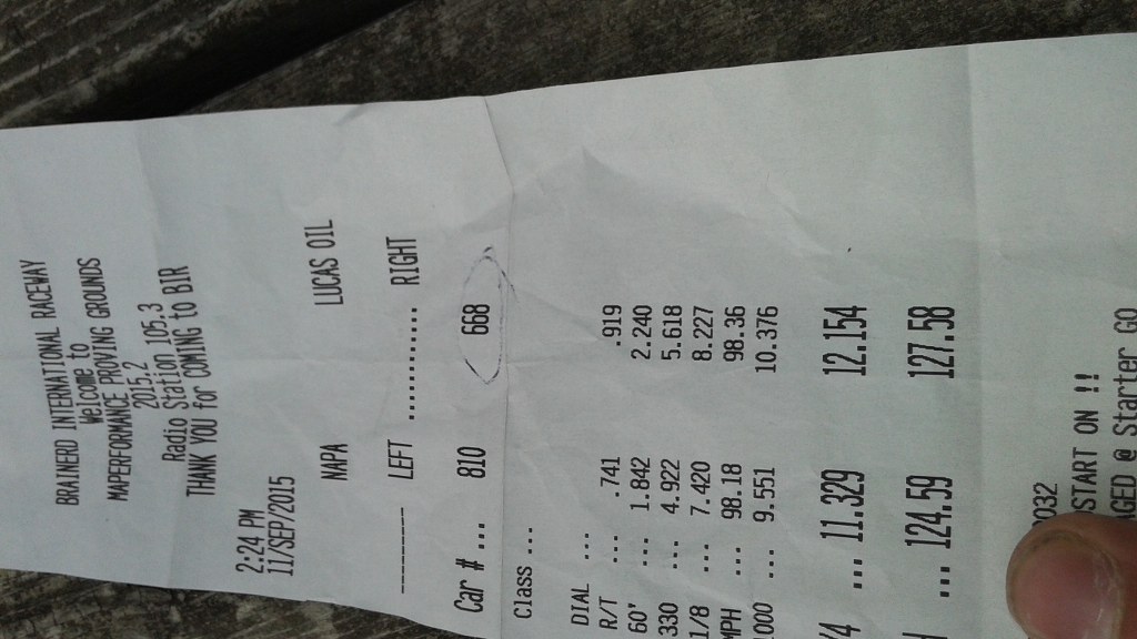

First pass was a 12.1 @ 127.5 with a 2.2 60'. This was in full street form (even still had the sub in the trunk). Car weighed in at 3460lbs. Launch was horrible, lots of wheel hop, NT05r's still at 30psi.

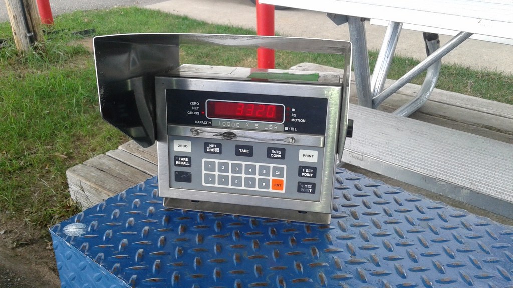

Second pass was an 11.6 @ 131.3 with a 2.1 60'. I removed a bunch of weight for this. Pass seat, sub/amp from trunk, all trunk carpet, rear seats all came out. Car weighed in at 3320lbs. This was my best pass of the day. Launch was a hair better, I had lowered the rear tires down to 20psi. The weight reduction had an awesome effect on the trap.
Third pass was an 11.7 @ 131.8 with a 2.2 60'. I removed the entire exhaust from the downpipe back. You can tell in the video it is significantly louder. It's stainless so I bet removing this put me under 3300lbs, unfortunately the scale was closed at that time so I didn't get to re-weigh it. I'd guess probably a good 40lbs was removed though, so probably right around 3280lbs would be my guess. I thought the reduction would have had a bigger impact on my trap, but I gained almost a mph with it. I put the tires down to 18psi. Lots of wheel hop again. Still was happy that I was able to basically duplicate the previous run. This was the end of Friday nights fun.
