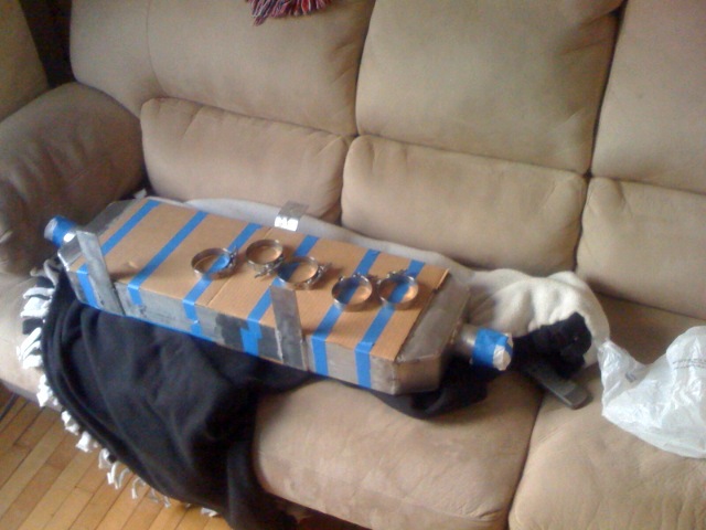

Got the intercooler and pipes yesterday, this thing is huge! It nearly takes up two couch cushions with the endtanks.
It appears to be a legit spearco 2-216 core, the pipes are very nice as well (no dings or anything), and I got a complete set of multi layer silicon couplers with tbolt clamps. Very happy with my purchase, the extra 4" wide should look sweet when it's installed.
Edit: question about exhaust manifolds, will a ported 2g one be enough? Or should I look at the FP cast mani since they are on sale for $175 without coating and $235 with coating. Will it be worth the upgrade?

What turbo?
Old 02-20-2008   #157
Re: Make slowboy not so slow
Dual ball bearing SCM61 with the S cover.
