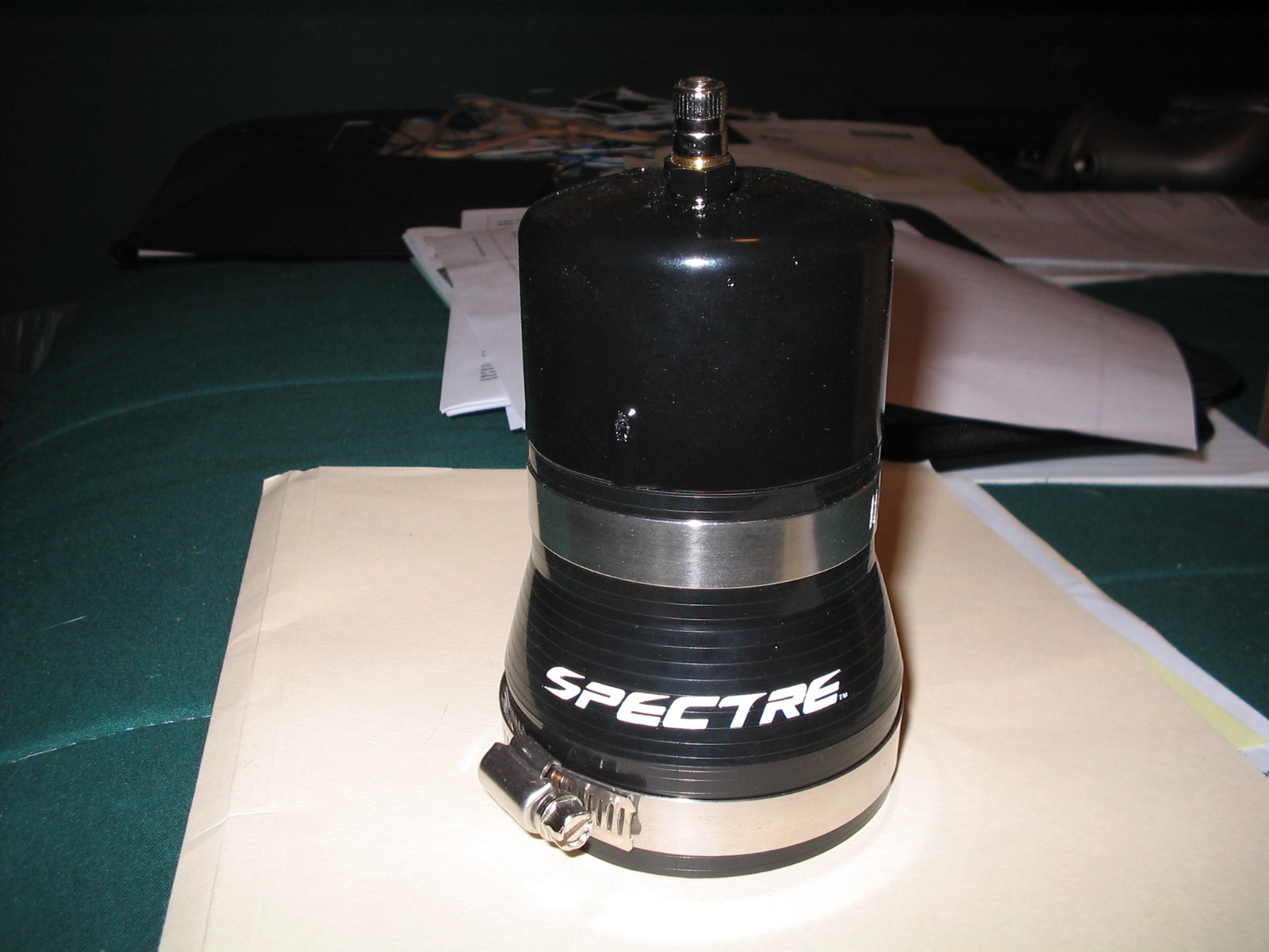

Here are a few pics, I can mass produce these for about $15 a pop if that is OK with Scheides...

Re: My Boost Leak Tester
Weak... You need a PSI gauge on there to watch the pressure instead of having to run into the car to see what its at!

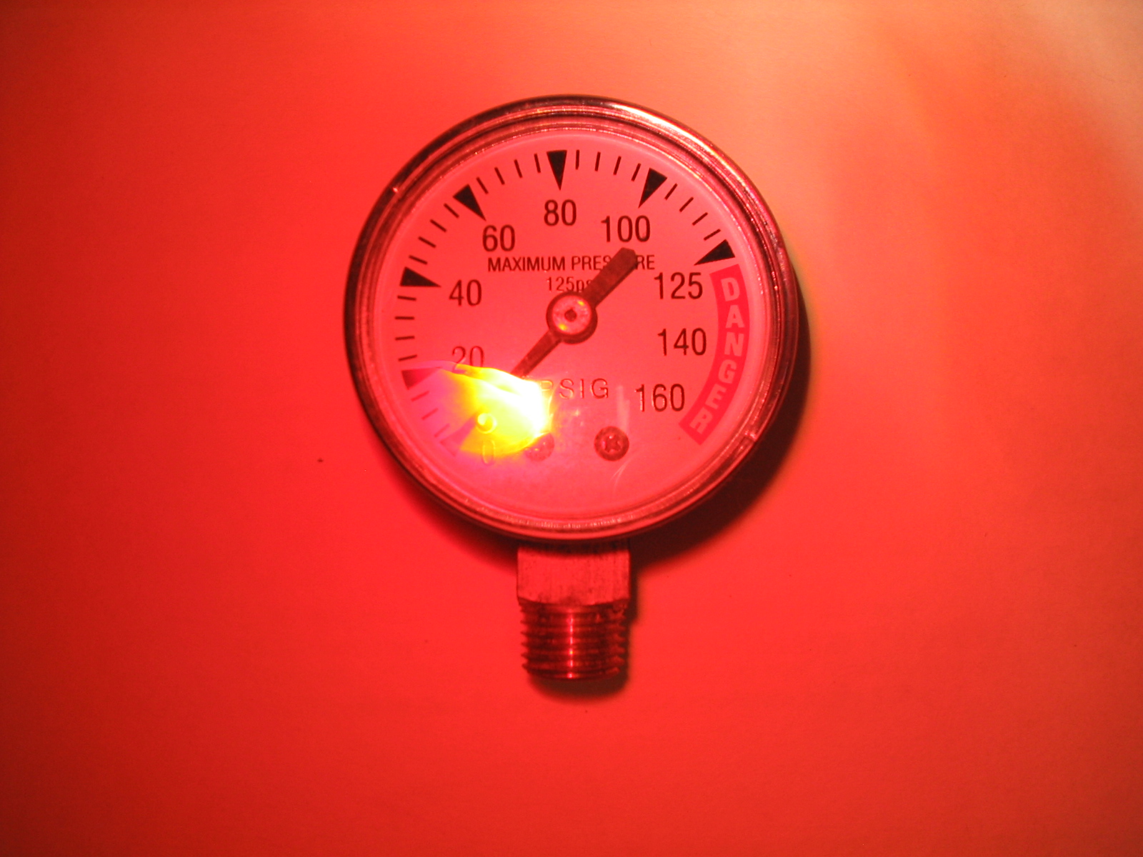

I fucking have one lol!
But my stupid drill is too basic / small to fit the drill bit I bought to make it work...

Here... If I can just get my hands on a drill that will hold a 7/16" bit...

Danger to manifold.

lol you only put it to 25 psi... that is the only one PSI gauge Napa offered.

25? Shit... I always check mine to 50.
yea, someone told me they once forgot to lower the PSI on the compressor when doing a boost leak test and let it rip at 120 psi... BOOOM!

http://www.siliconeintakes.com/index...8d091a8df783b6 better
Old 06-01-2008   #10
I always T-Bolt the boost leak tester on now. Scares the shit outta you when it blows off the inlet.

the one i linked is half the depth of yours, and uses Tbolt Clamps. Much safer. its also got shiney metal. not plastic.

Mine is PVC, I will be picking up Tbolt clamps when I'm in town this weekend from Napa. Mine is also about 4.5 inches long, nothing outrageous.
Edit - The reason I don't already have the t-bolt clamps is because that stupid spectre coupler came with those clamps and I was on a huge budget at the time.
