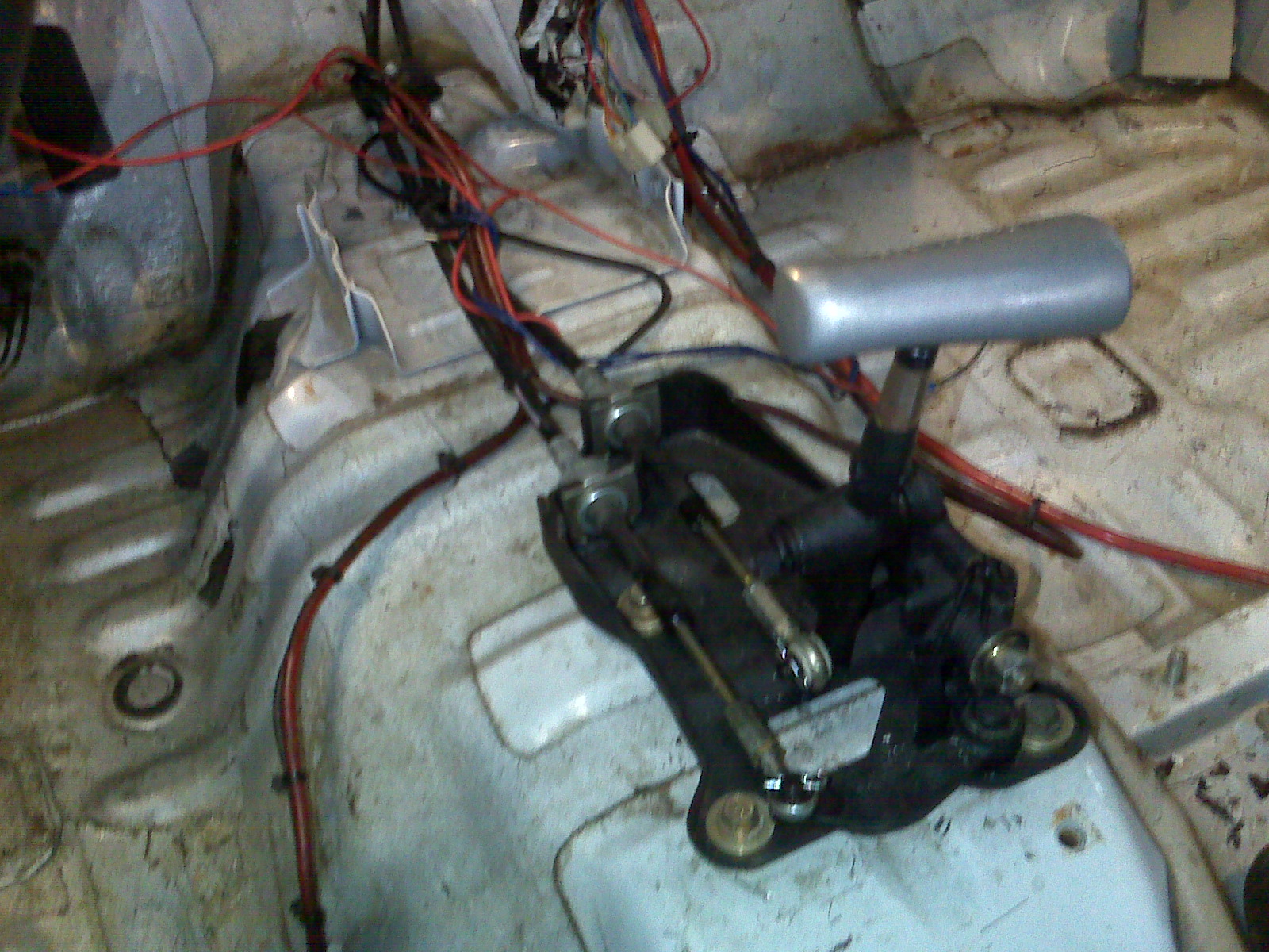

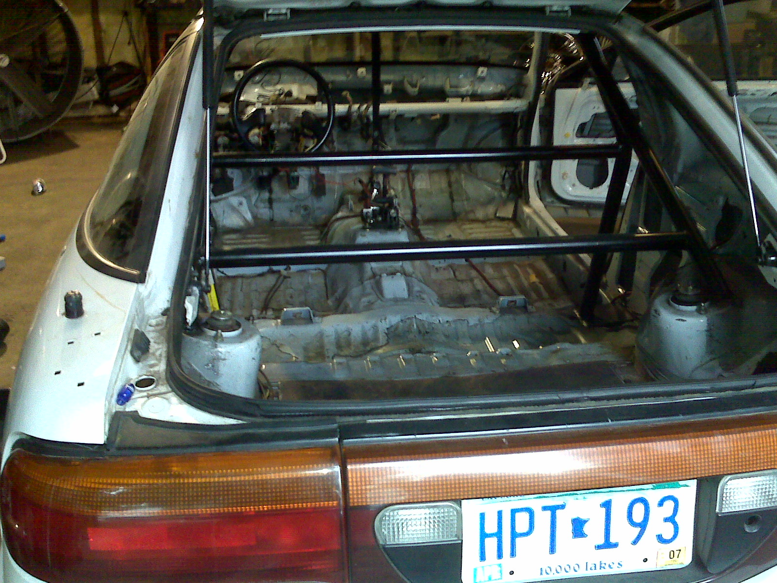

Something I've Been Working On...
I wont go into specifics but it will give you a good idea
The Shell... 1992 Talon TSi
KYB AGX's W/ B&G Springs
Welded 4 Bolt Rear end
Prothane Suspension Bushings all around
Gutted Interior
Unfinished Cage
Front & Rear Powerstop Drilled and Slotted rotors
Symbroski Bushing set, And SBR Prothane Trans Bushings
Motor...
Still a 2.0
Im hopeing to pick up Johns (Pushit2.0) Manifold and 4202 by the end of this weekend so i will be posting up pictures as soon as i get it
I'll try to post progress as i go but im currently un-employed so its kind of hard to buy parts, Im hopeing to make it to a fall dyno day and see what kind of power i can throw down... Should be interesting.
-Stephan

Old 06-03-2008   #2
Re: Something I've Been Working On...
Looking good man! No need to be throwing money at a car while you're unemployed, but looks like it will be a LOT of fun!

Originally Posted by blageo23 View Post
Looks like it did a year ago
What kind of tranny/clutch is in there?
What about your 92 to 91 front end coversion?
Yea it hasn't changed too much, although ive done a lot of little tedious things here and there to make it a little more unique. The front end conversion still isn't fully complete, I'm still waiting to find a near mint set of 1GA fenders...
As far as a Flywheel / Clutch setup, I have the ACT Streetlight 12.5# flywheel ,Exedy street disc, and a 2900# PP And a stock tranny.
I'm hoping that the clutch makes it through break in and by that time i should have enough money for a twin disc setup.
Hows your car been? I see Kevin driving around all the time i just ever get to say what up...
