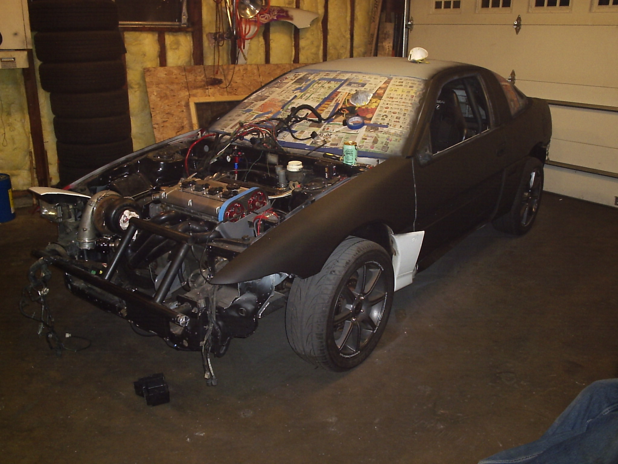

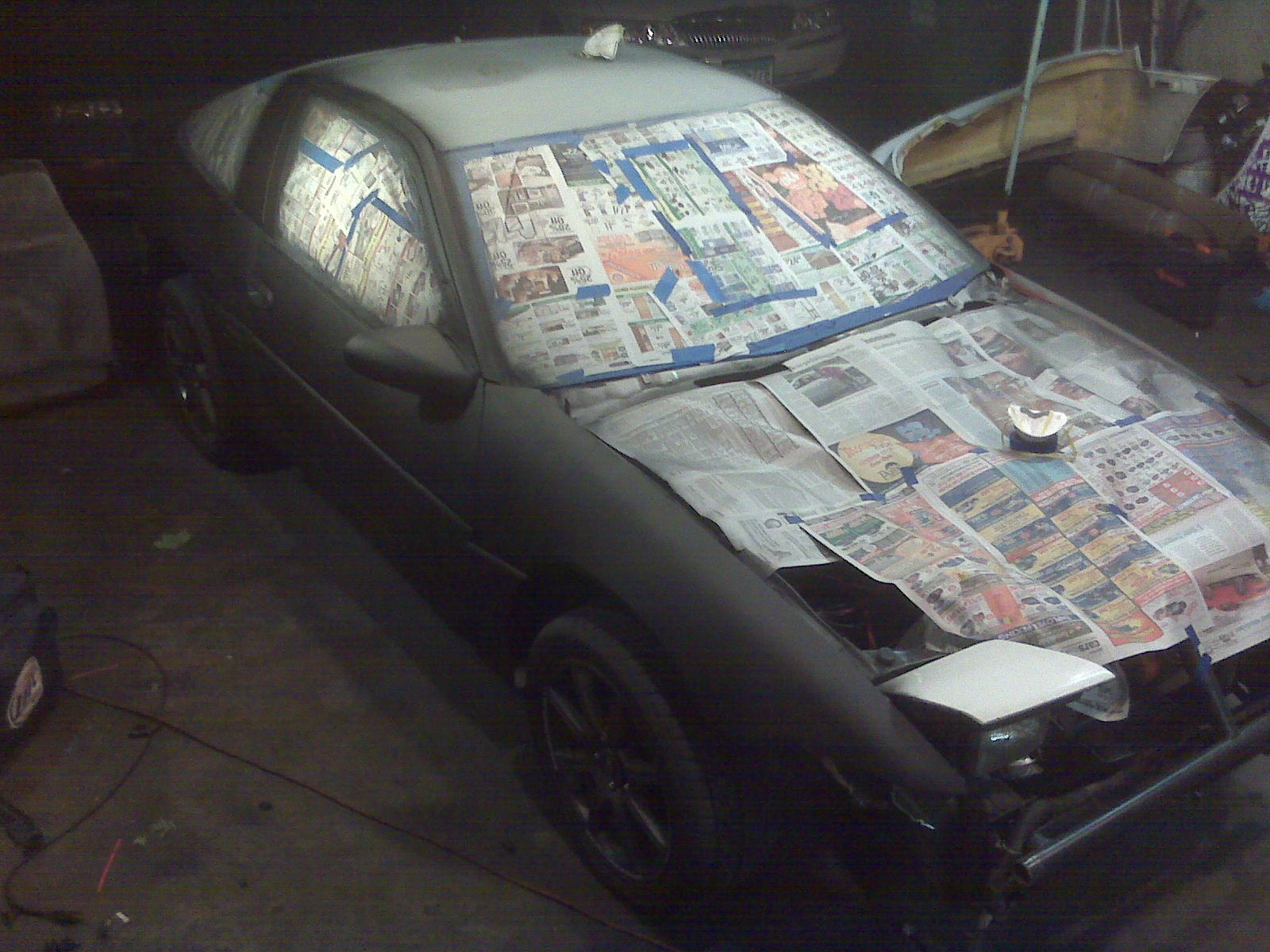

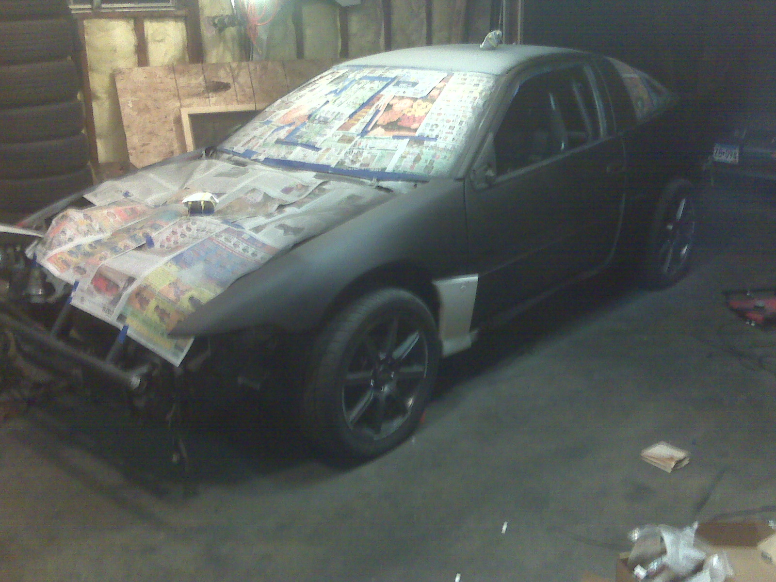

Funny that you asked, Here are some new pix as of today, I have a couple more coats to put on but it doesn't look to bad so far.
Thanks to all that commented, After being at a bunch of events this summer and riding in everone elses car it started to give me some motivation to get this thing on the road.

After clicking on the pictures i realized how shitty they were i will charge my digital camera and take some quality pix tomorrow.

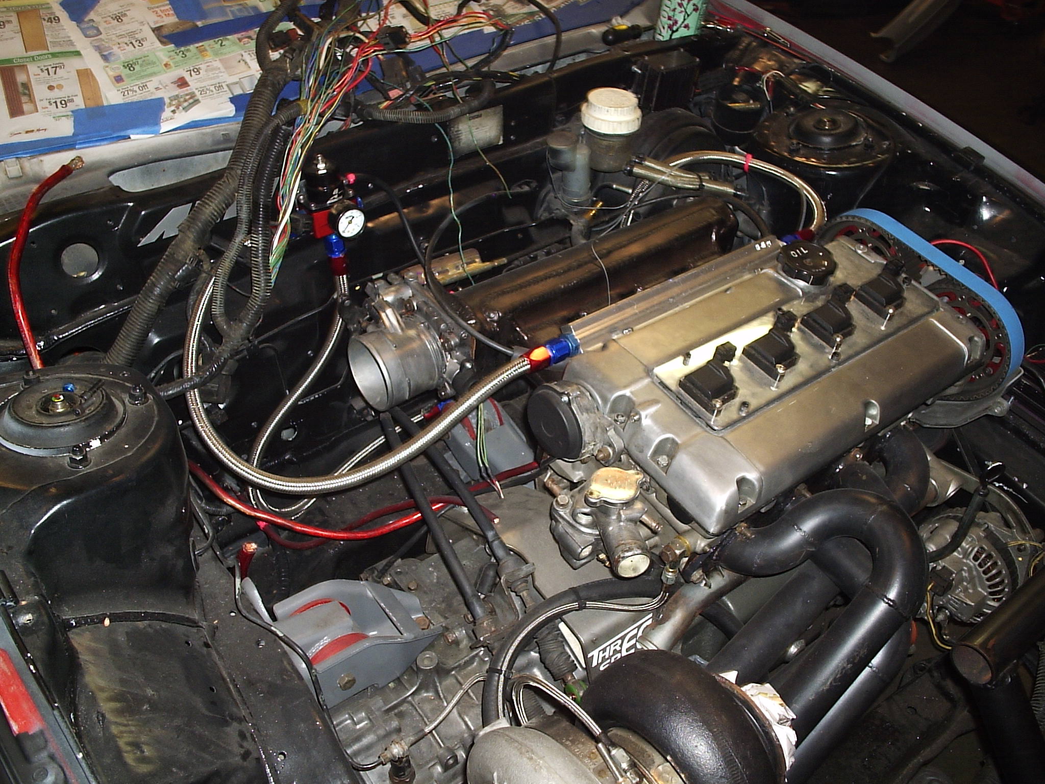

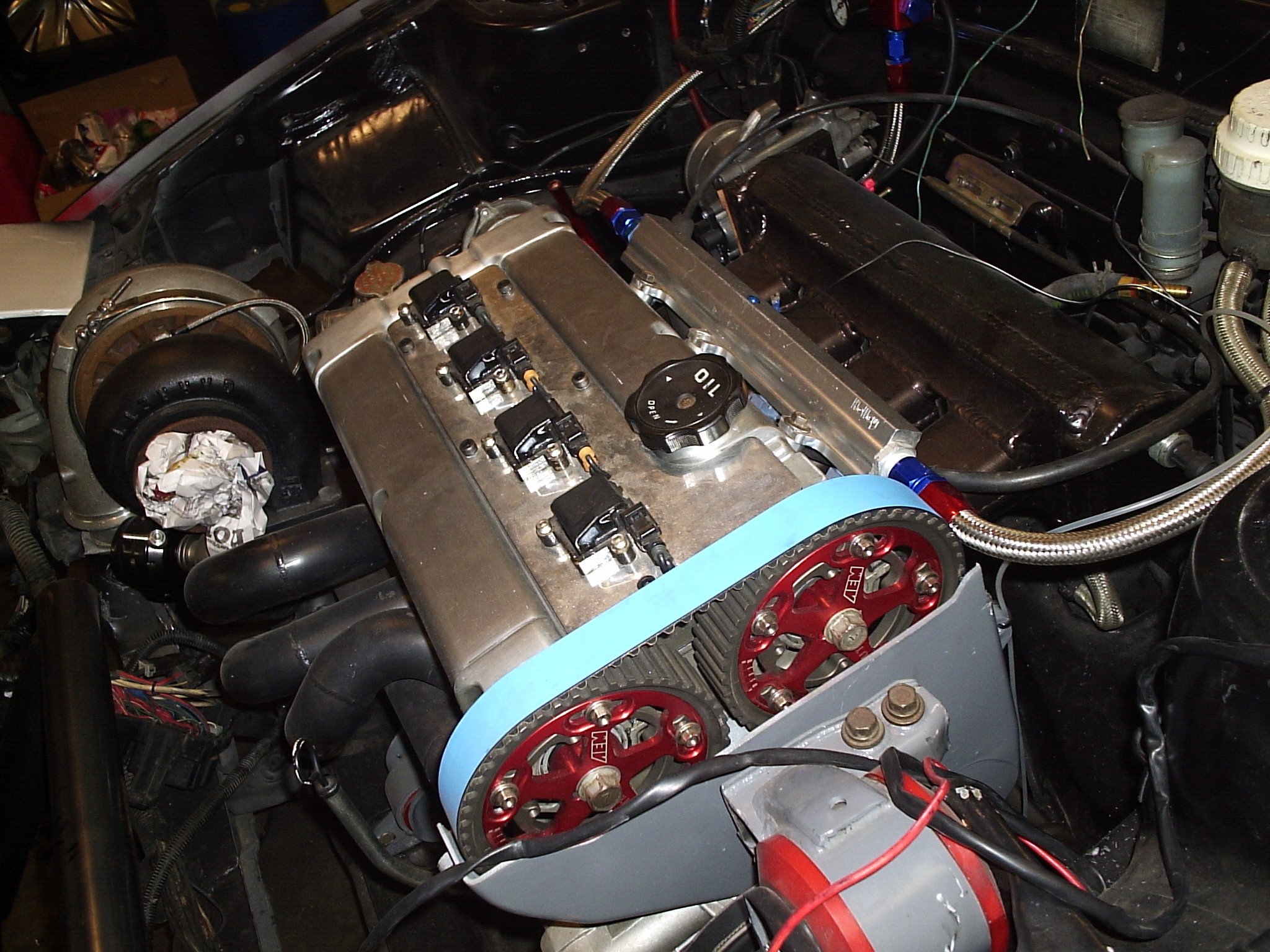

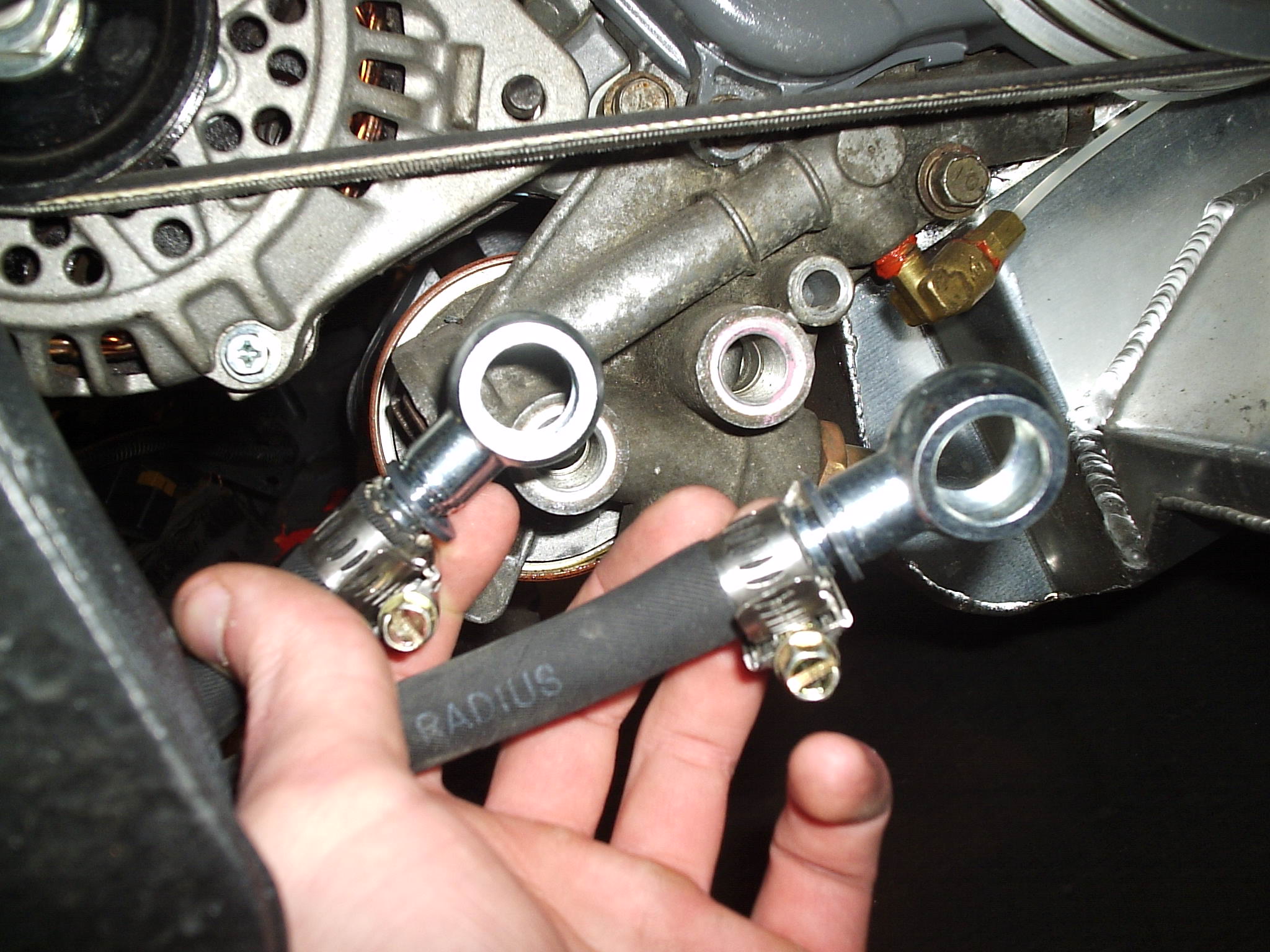

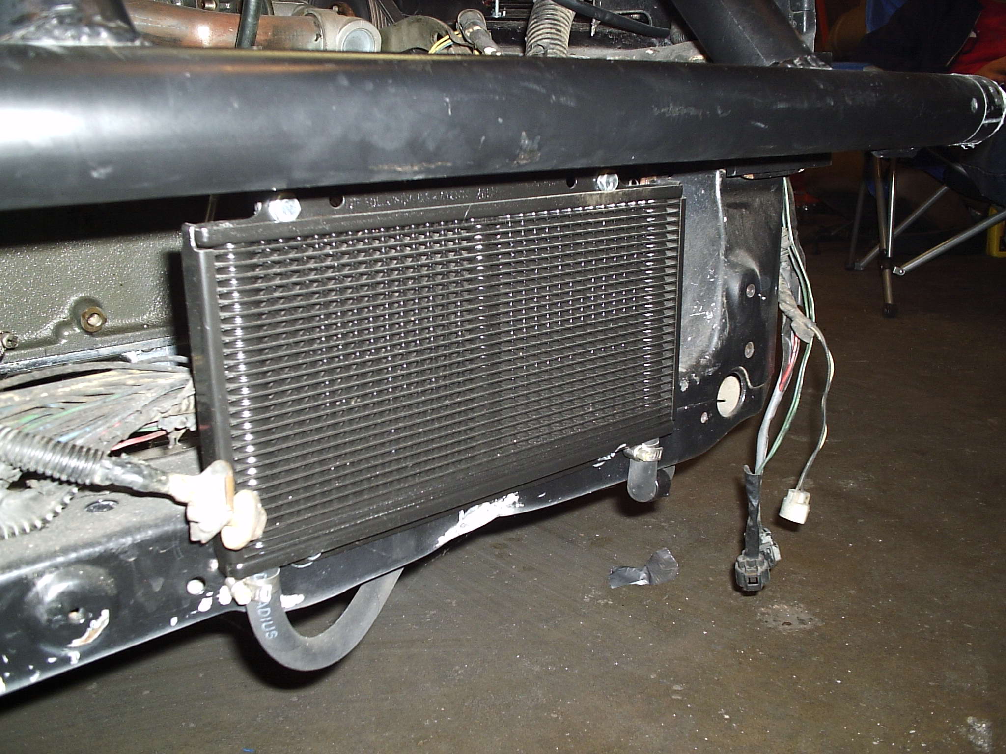

Yea hopefully this weekend i can finally hear it run, It's been under the knife for a year and eight months now... Thanks for all the help and parts!
Some better pix

Did you get your EMS yet? If not I have one or sale with sensors and everything at a good price. It's looking good! Is that primer or is the car going to be flat black?

It will be flat black, I have a buddy that works at welle and he was telling me that they make a "muscle car flat black kit" so im going to go swoop that up and see what i can do with it.

Looks great, although that throttle cable mounted to the firewall is going to give you problems, like a non-linear throttle opening when the engine tilts a bit under load. Personally, I'd mount that bracket to the manifold. Everything else looks great, can't wait to see it out on the road. I'm also kinda glad you didn't have it done for the dyno shootout, I like my trophy.

I dont think i will have to many problems with the motor tilting, Its in there pretty solid. Does anybody else on here have it setup like this? Any issues?
I have all prothane mounts right now and i was thinking of fabbing up a solid front one this weekend but i dont even know if i need it. I will probably just make it and wait to see if i need it.

Lookin Good, I would also worry about the throttle cable on the firewall.
Go to the Mitsu Dealer and spend $13 and get an EVO oil cap!

The engine still moves even with poly mounts, if you make any real powah.

Make solid front/rear mounts, thats what I did.
