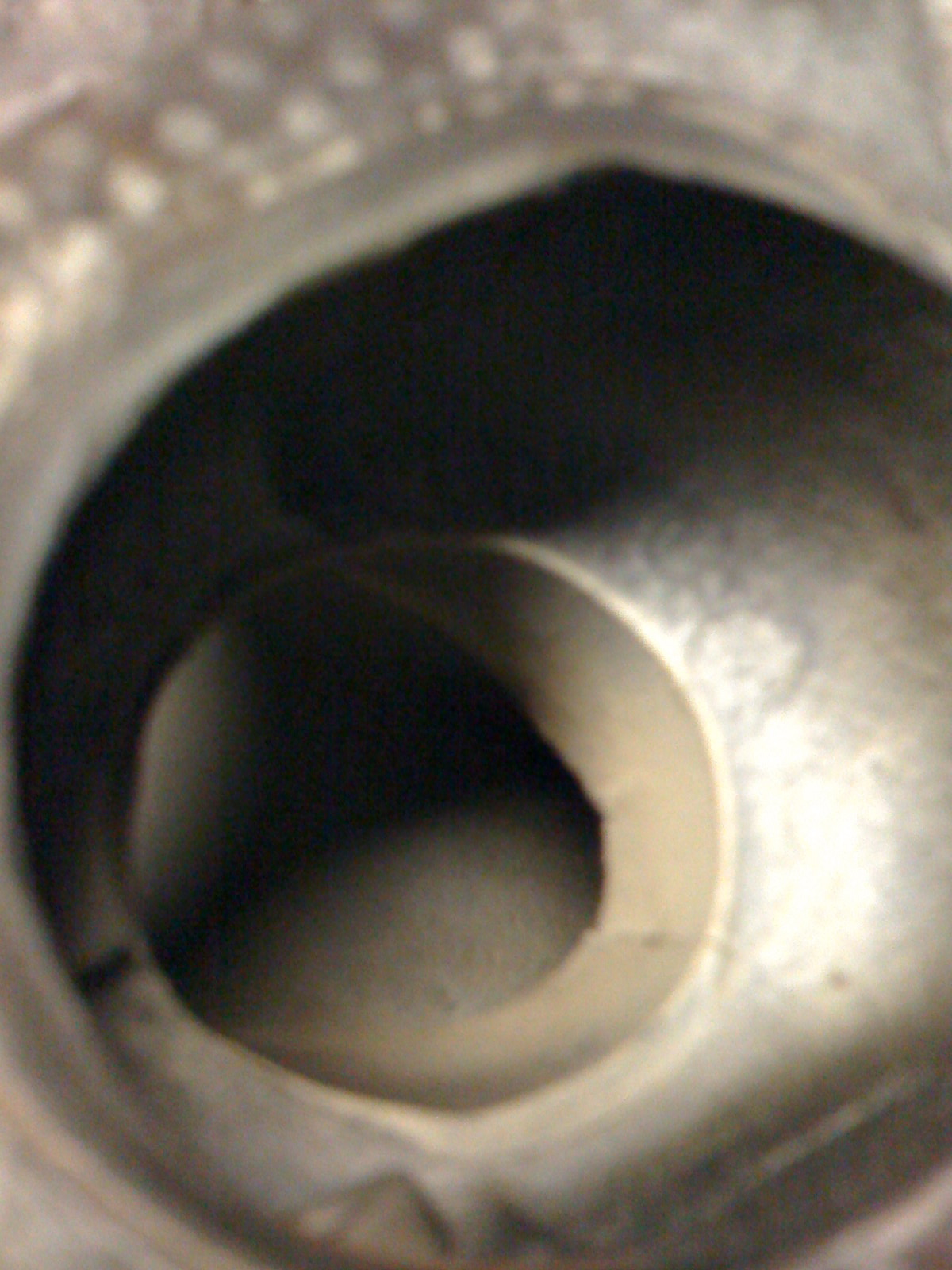

Hey everyone, I took off my turbo tonight because somehow the threads got messed up on my turbo. That caused the bolt to get loose and the gasket is basically disintegrated now.
I really have no idea how this happened, yea the bolt got loose because it backed out (bad lock washer), but now that the turbo is off, the bolt actually will slide right through the hole in the turbo, but it still looks threaded inside... how does this happen?
Anyway now that it's off I was just going to retap the threads and use a new gasket, but noticed that the exhaust housing looks cracked. It looks like it's just on the surface, but who knows. Should I spend the money to ship it to FP and have them check it out while it's there? Any ideas on how much they take to look at a turbo even?

How bad is the crack?
On my last turbo I had a crack that got worse but the turbo was fine didn't act different.
But mine wasn't in the location that yours is in.
Old 11-25-2008   #5
Re: Turbo problems
If it doesnt leak exhaust Id leave it alone, unless you have money to toss at it.

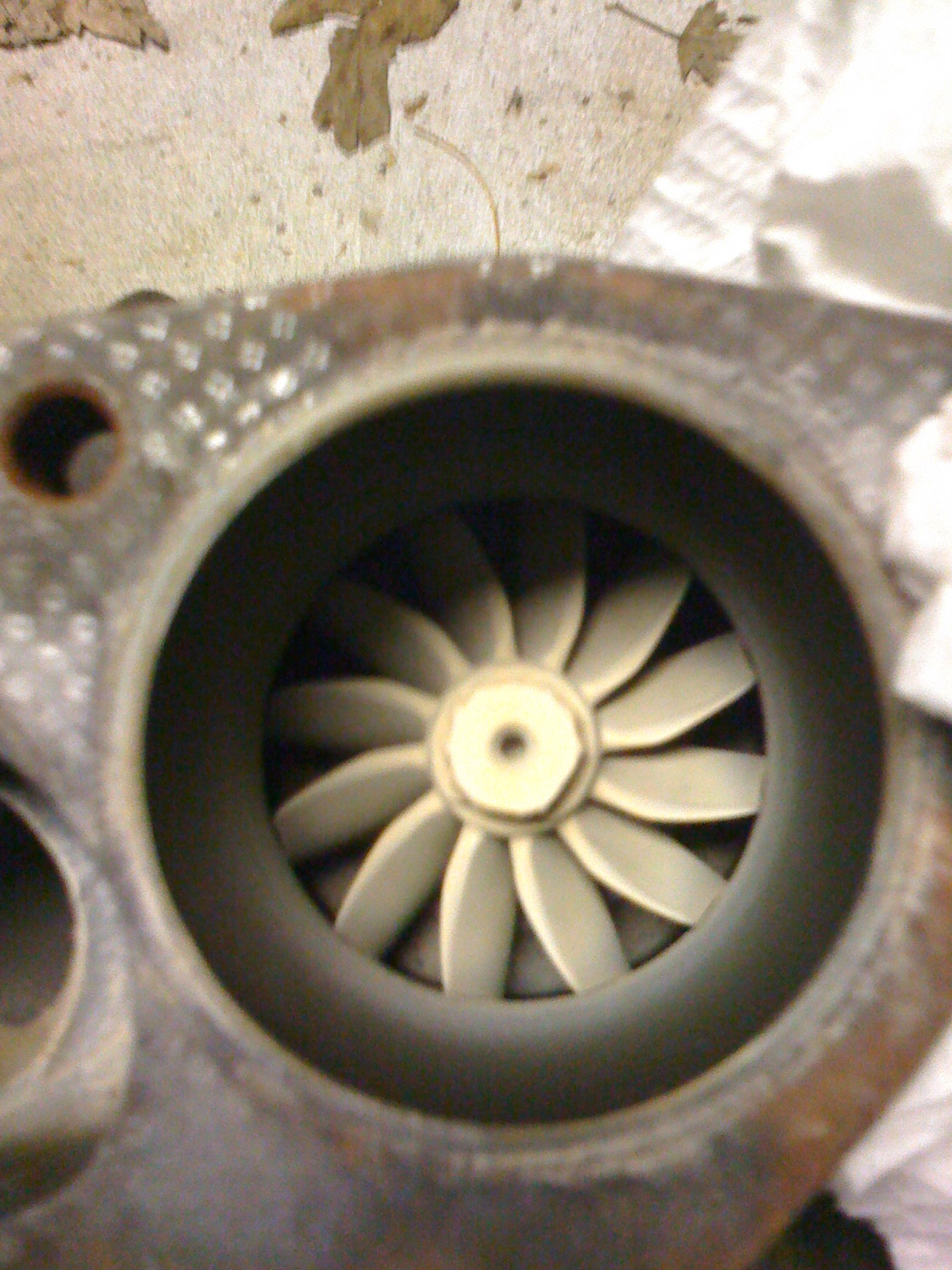

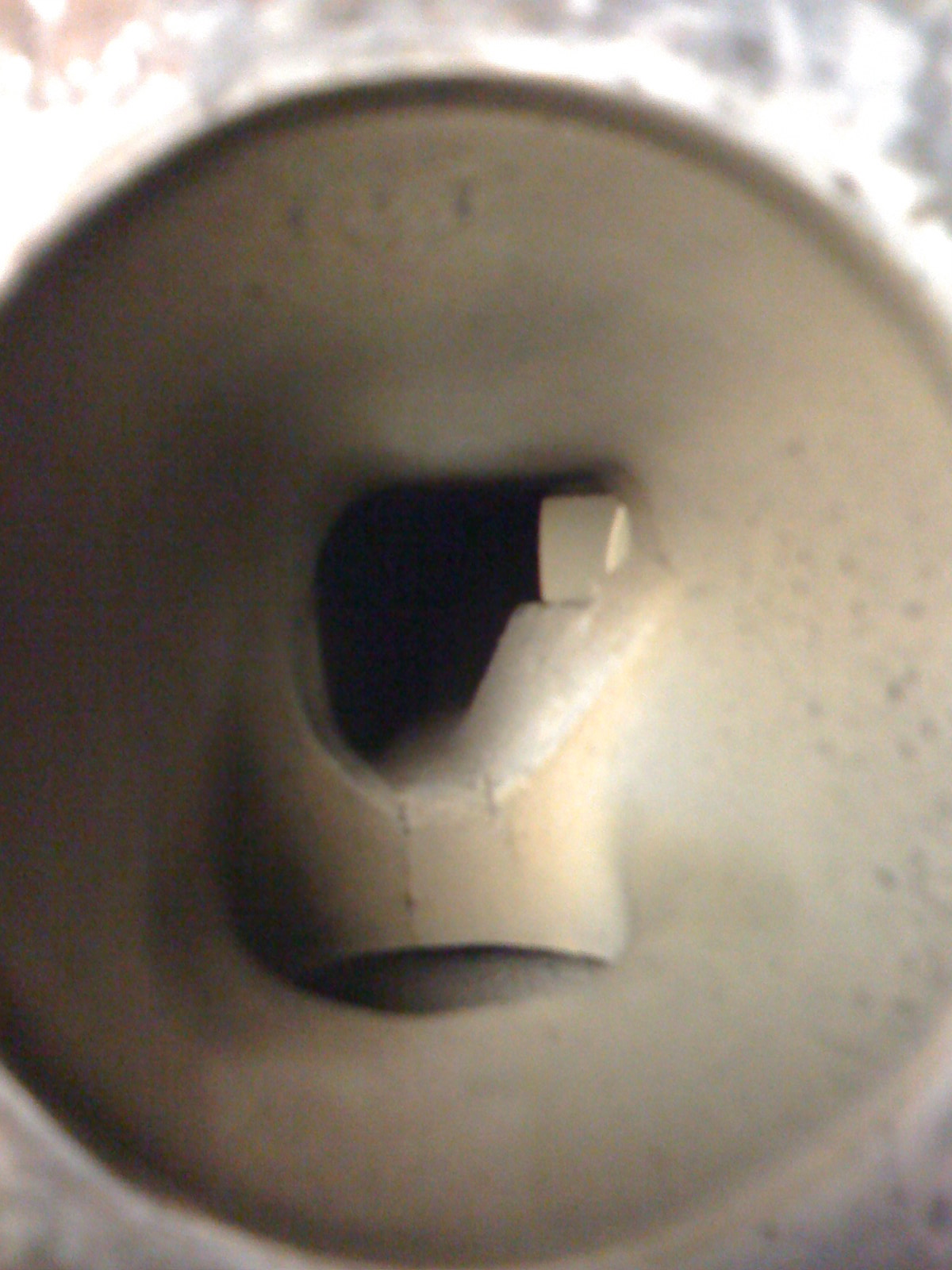

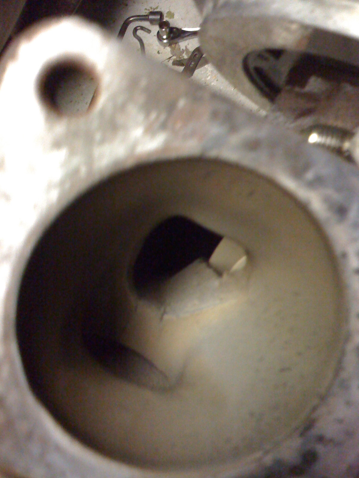

Take another look at the turbine wheel, is there something up with that?
Old 11-25-2008   #7
Re: Turbo problems
^^ Not sure what you mean, but I took better pics from the inlet showing the wheel, also some from the side showing the crack on the wastegate hole and also of the turbine wheel.

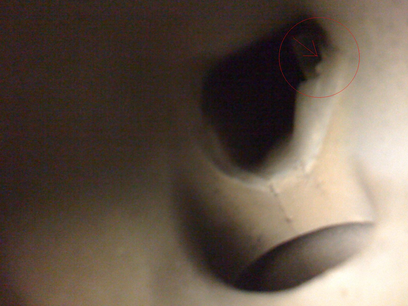

I was talking about this. It might just be the angle.
Name:	looks chipped.JPG
Old 11-25-2008   #9
Re: Turbo problems
Ah I see now. I just checked it and the little notch is part of the housing, like a small casting nub. You can see it in the other pics.
