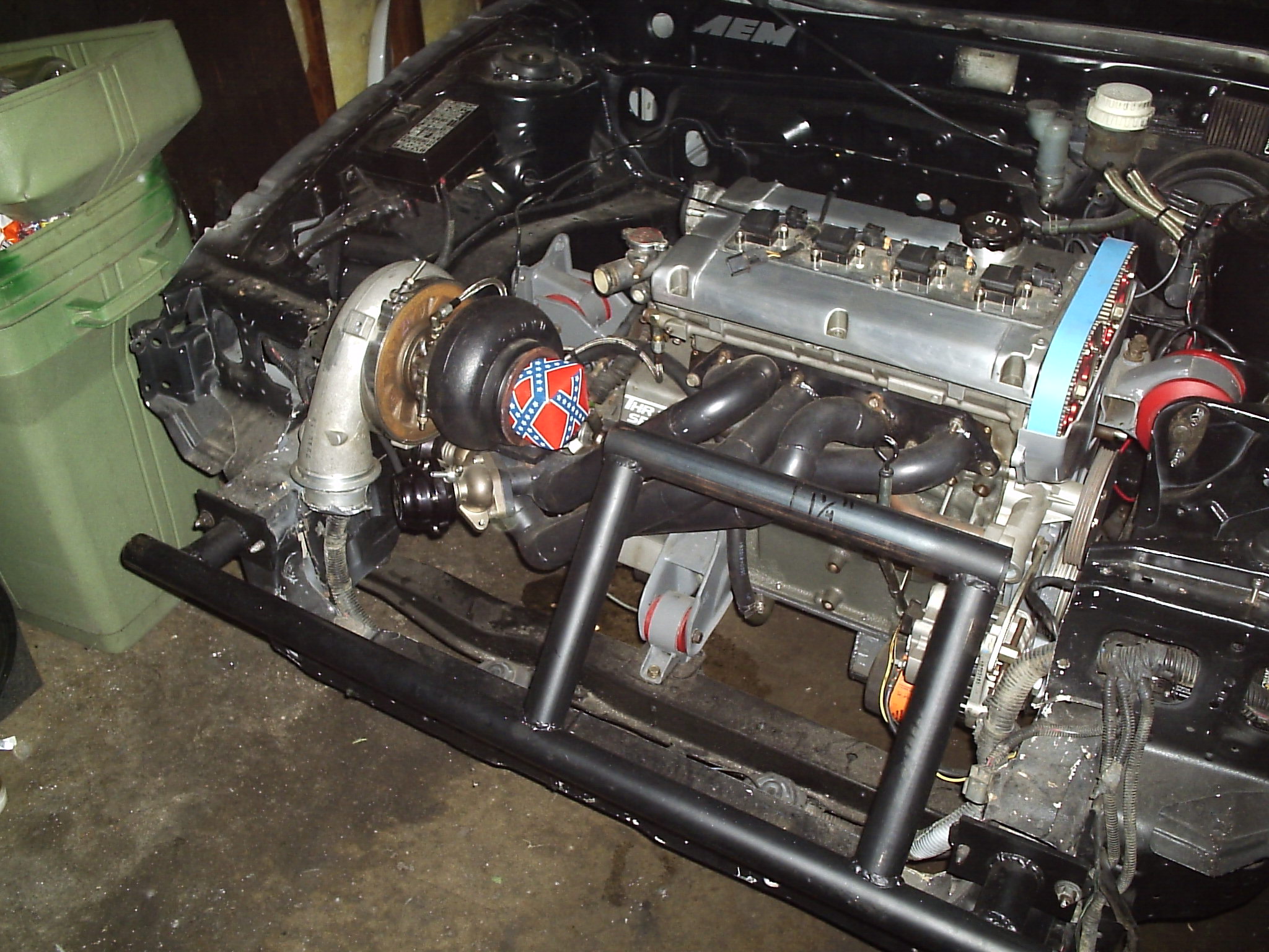

Looks good!! I like the color choice on the block, Our motors look some what simular..
Did you stick with the 2.0 or did you do a stroker setup?

They do have a resemblance. That's some nice welding and fab work.
It's still 2.0 I'm not ready to jump to full drag car, I like to cruise the streets, and it will be capable of running laps at the track. My next setup I will have the motor destroked to 2.1 and have 11,000rpm red line. But that's years away. Right now it's a all around race car . No drifting.
