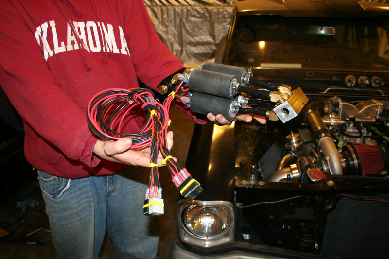

On a lighter note Kevin, you might want to copy my fuel pump setup.
(SEE ATTACHMENT)

Old 01-25-2009   #17
Re: 1650cc injector and pump/e85 question
Right. Are those your hands? Did you fall into a puddle of bleach?
Old 01-25-2009   #18
So what should he use oh great one?
(SEE ATTACHMENT)

Old 01-25-2009   #20
I took the pic genius.
