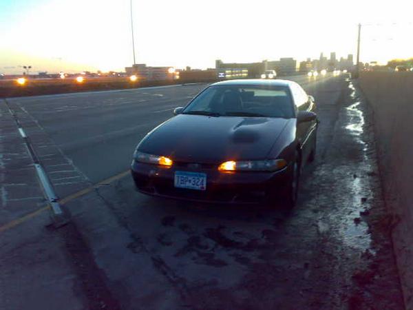

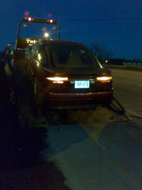

Well here are some pics of the talon in all its glory (up on the flatbed...lol). I picked up a head today (thanks to iceminion), and have to get all the fluids, gaskets, belts, from my pops (bday present). It didn't get picked up friday, but will be out early this week, and hopefully back by the end of the week.
(notice in the first pic, the talon decieded to take a nap on 35w North....haha)
