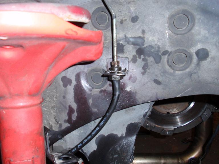

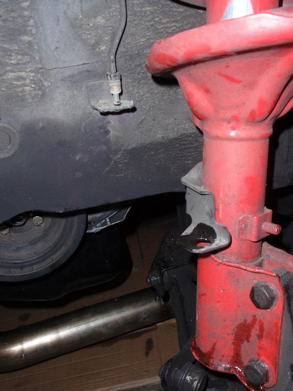

OK well, the install is 99% done. All that's left is to clip the brake lines in the middle somewhere, probably on the stock bracket. Just want to install the tranny and axles before I decide on the permanent clamping point of the lines. One thing I will mention, was that I did have to do a little bit of sanding and/or shimming on the spacers that were included with the bracket kit, to get the calipers perfectly centered on the rotors. They were "OK" with the just putting in the spacers, but weren't perfectly centered. I just decided to be nit picky and get them as perfect as I could. Both bottom bolts have the spacers left as is. The top bolts I sanded a little, but sanded too far, then put washers on as well. The spacers were about 1/32 too long for the tops. So like I said, hardly off at all, I was just trying to be as perfect as possible.
Here's the pics.
Name:	Brake Line Removed.JPG
ID:	8926   Click image for larger version
Name:	Brake Line Installed.JPG
ID:	8927   Click image for larger version
Name:	Brake Line Installed 2.JPG
