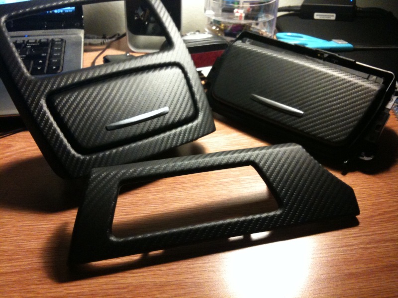

Next pain in my ass, my little art project. No pics of this shit yet as it looks like garbage. I'm trying to fill in the holes around the stock rectangular openings that I've put my circular seat-heater controls into. Bondo + 600 grit sanding the entire thing seems to have worked best, but this paint I got just makes it look like shit. It's shiny and you can see all the details of the surface, including the clear differences between the bondo and the plastic. Needless to say, it looks like shit. Anyone have any ideas, or know anyone good at stuff like this? It's just a basic piece of plastic, kinda krinkle black.

My best bet for the plastic peice is to sand down the entire thing and make it perfectly smooth, then use crinkle paint on it. It will never match though, thats the bad part.. You could have that place that did your seats, wrap it in leather or suede?

Get yourself some 3M Di-Noc wrap! Release the inner ricer!

He had mentioned the black vynal idea to me earlier, it's a good idea.

Other idea I had was to have my good, dear, amazing, manly friend rosey machine me a thin piece of aluminum that matches the top of the plastic plate, then have it powdercoated. I could sand down the existing piece to make up for the height of the aluminum, then affix the new piece to the top of the plastic. Might be the most durable solution for a spot that will get a lot of poking.
