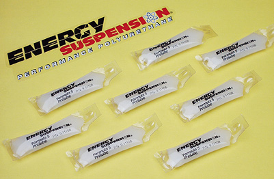

The grease that came with the Perrin sway bar is Energy Suspension Formula 5 Prelube. It doesn't feel like the grease that came with the Whiteline bar nor the grease Hughes and I have. This stuff feels like thick maple syrup.
