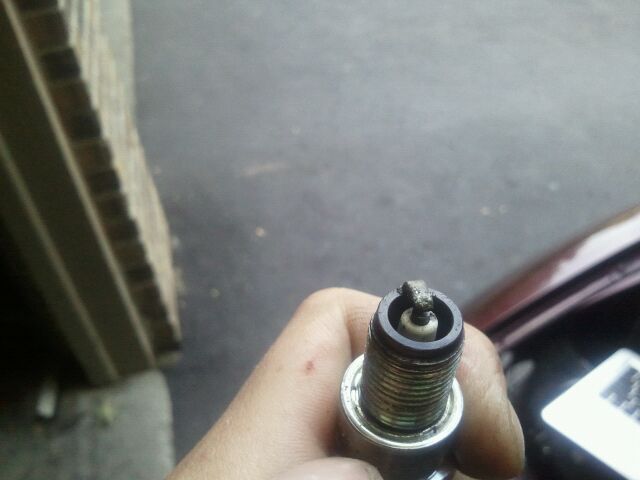

Well on my way home from work my car started to sound like a Subaru and lost all power. Pulled into a BP and it died and wouldn't start again. Got it towed home and pulled the plugs and #3 looked like sh*t.
It's greenish in color and looks like it has a tack weld on it/ melted electrode.

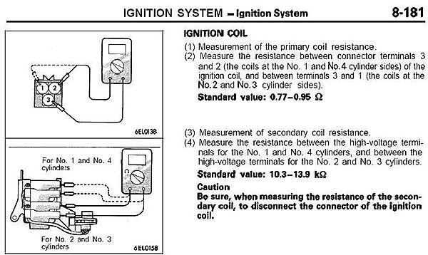

Coil pack tested good the primary ignition coil in the diagram tested at 1.01 ohms so it's a little high, says 0.77-0.95 ohms.

Did you do a compression test? You'll probably at least want to take the head off to inspect for additional damage.

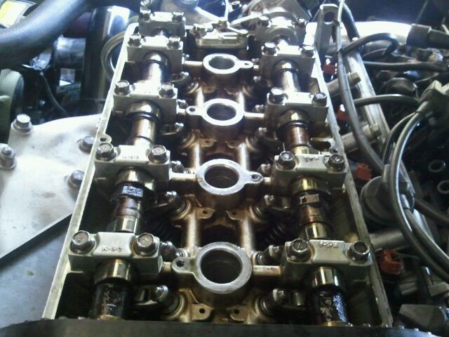

Well all the rockers are still in place. Coolant level is still good and no oil is mixed in and vise versa. During the test it cranked over way faster than all the other cylinders, just because no compression i'm guessing.

With zero compression I'm going to guess a bent valve. Any broken springs? At this point you pretty much have to take off the head anyway.

No broken springs from what I saw at a quick glance.
