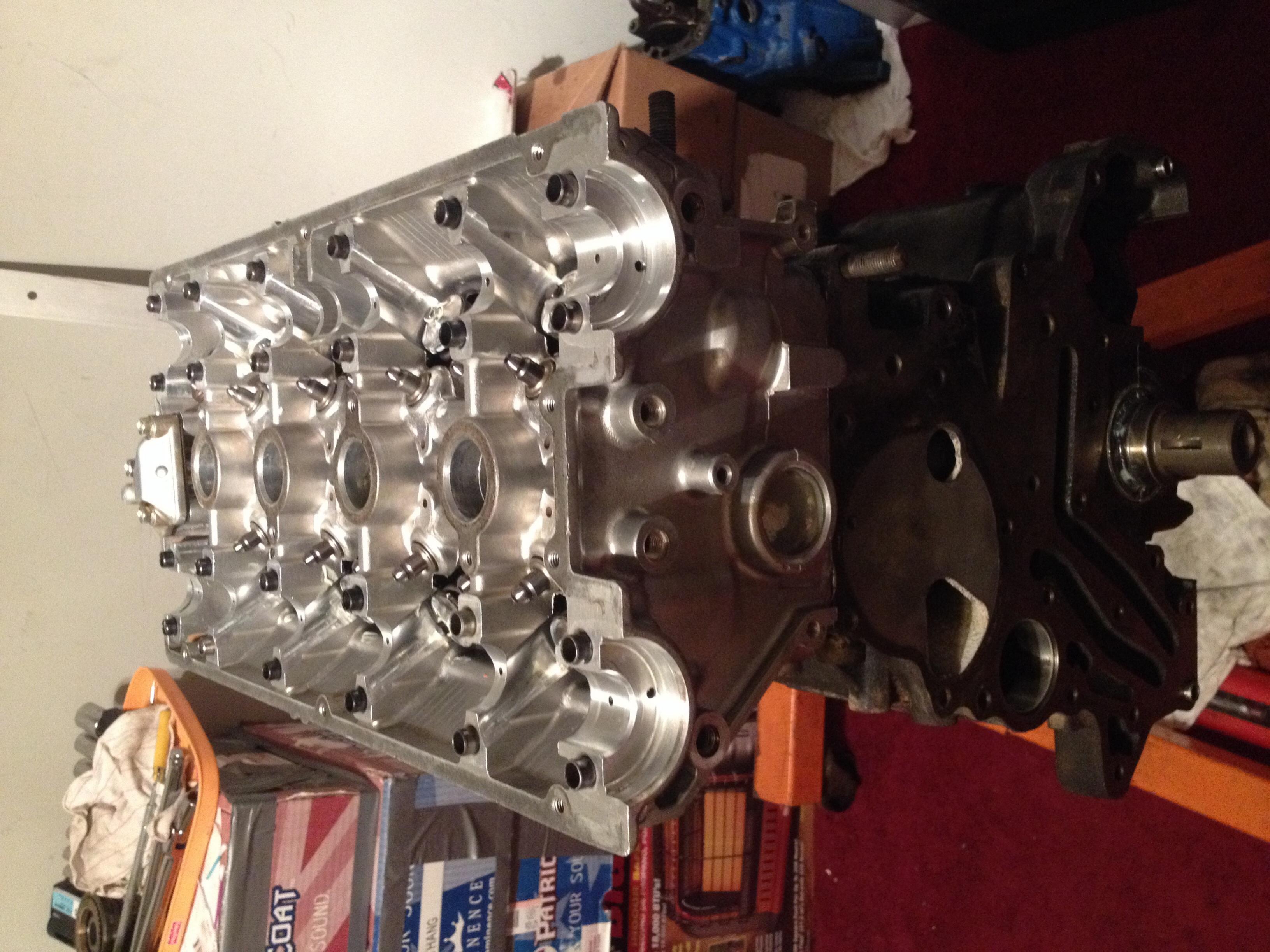

Last but not least I finally got around to finishing up Jessie's motor. Yes it has been on the back burner, but he's a flake lol. He will most likely start to add to the thread now as the ball is rolling. Here is a pic of the head on all fresh rebuilt with A1 headtuds and a compisite gasket. This car was fast as hell last year so we hope to add to that this year.
Oh and guys 2.4 is on gas 16psi with small 750cc inj I believe and runs strong.
