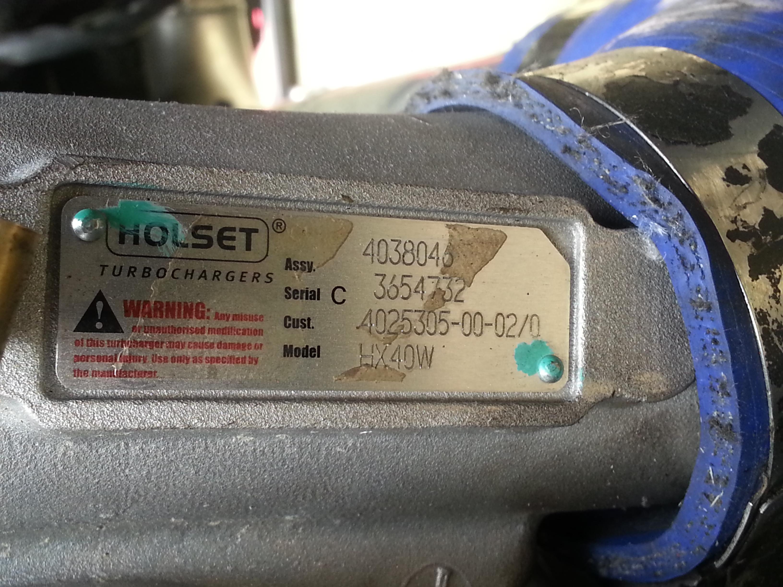

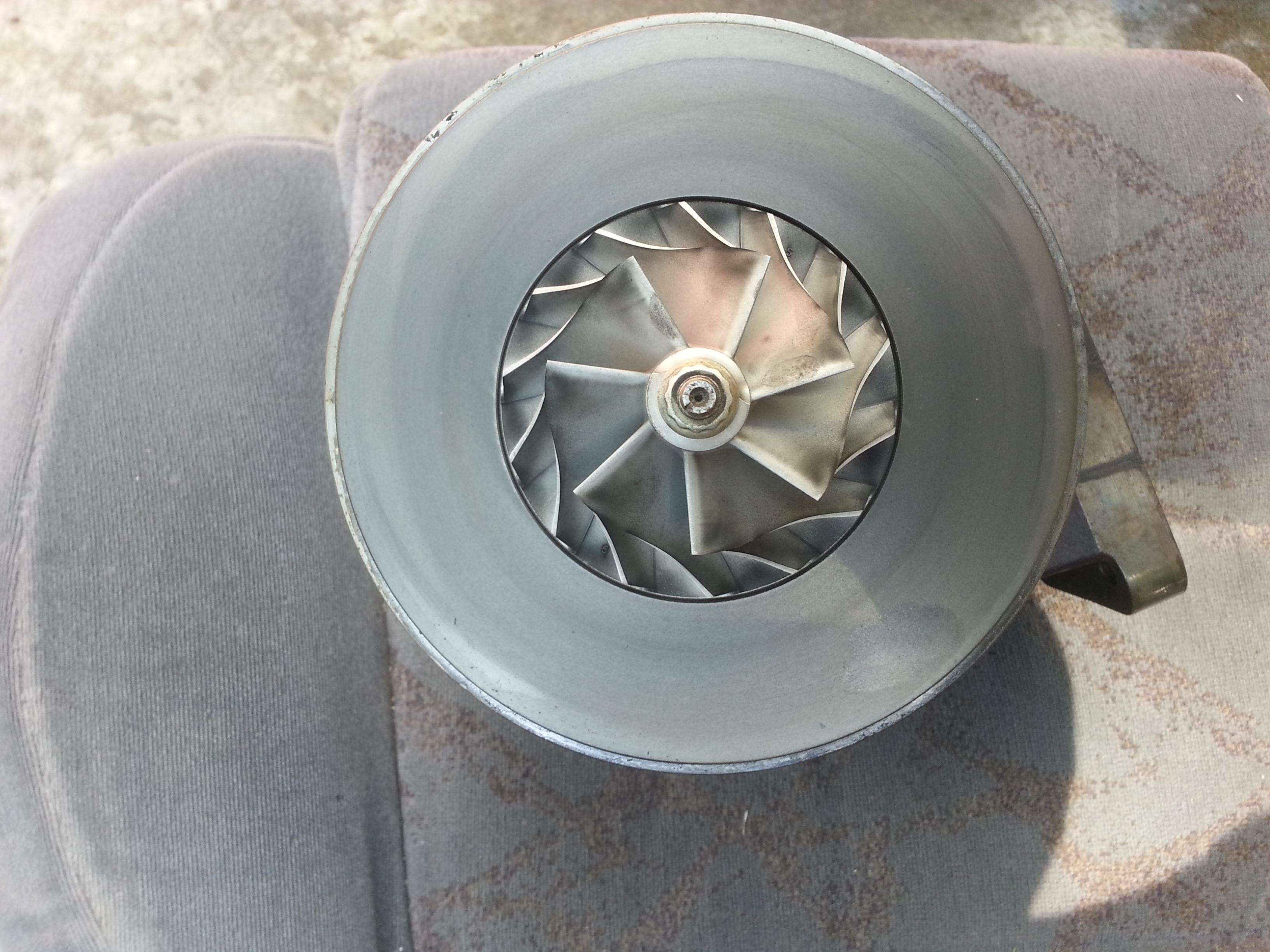

I uploaded picts of the side skirts above , im on the fence about adding the lower door pieces kind of like it like this.

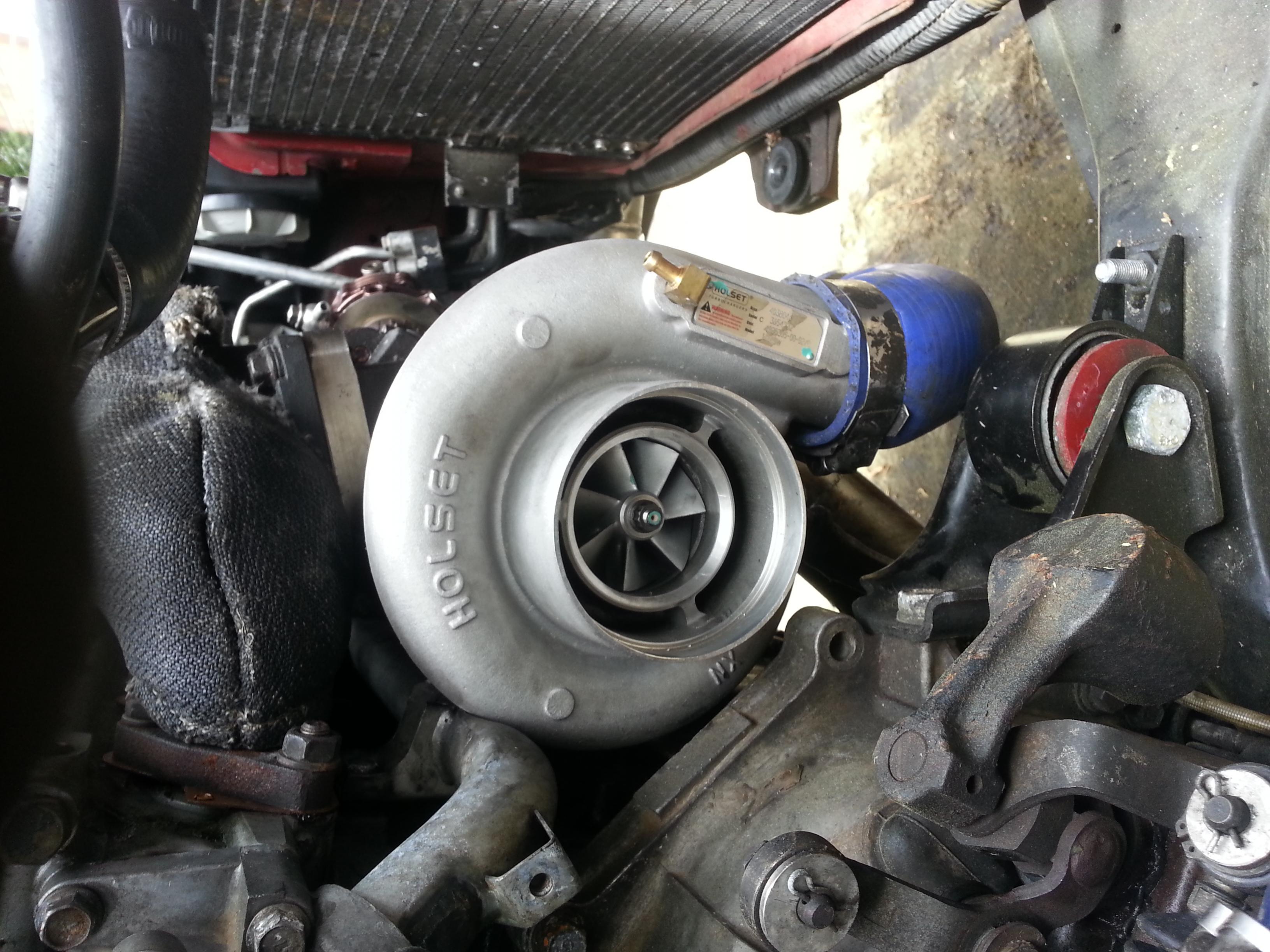

I also just realized I hadn't loaded any picts of the hx40 installed do here ya go. Also threw in a fun shot of car looking like a rwd launch

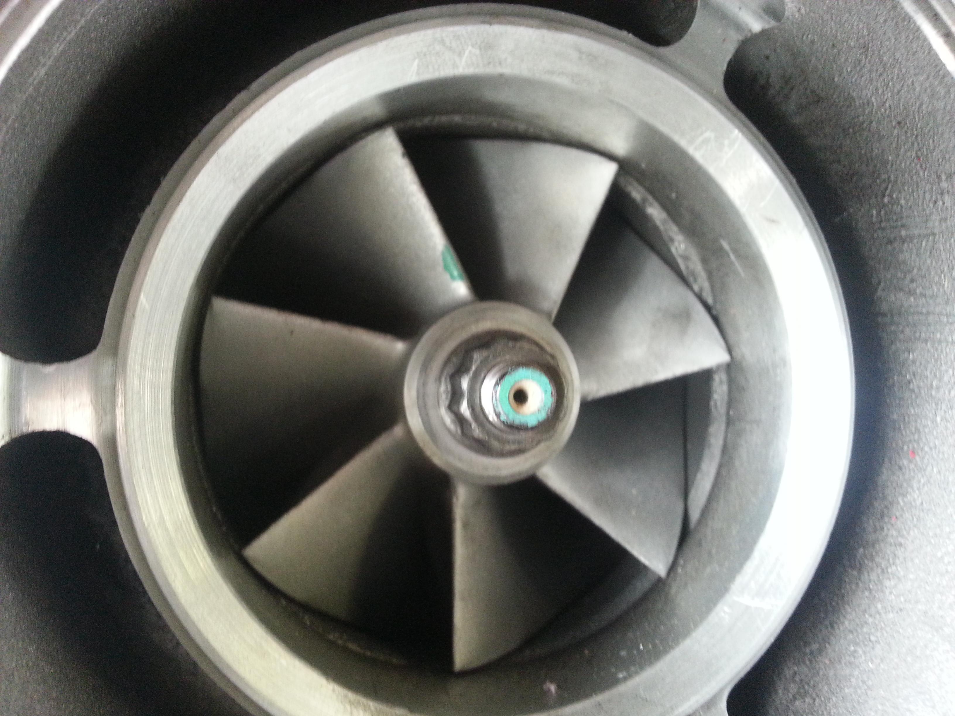

Just some picts.

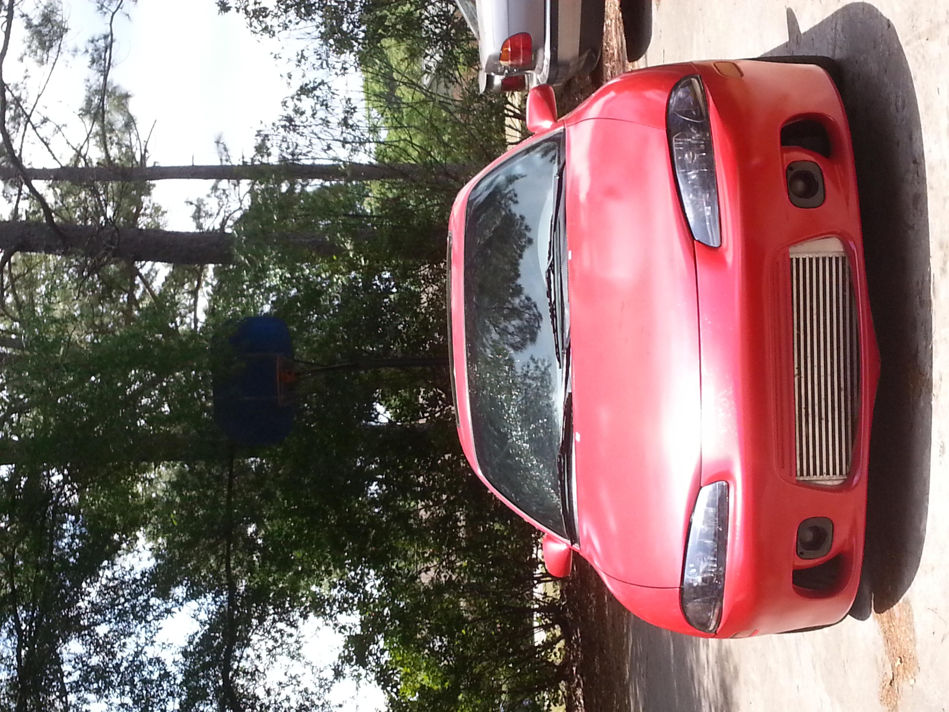

Fog light covers installed, side skirts, hx35 compressor wheel, and new 300m coils installed

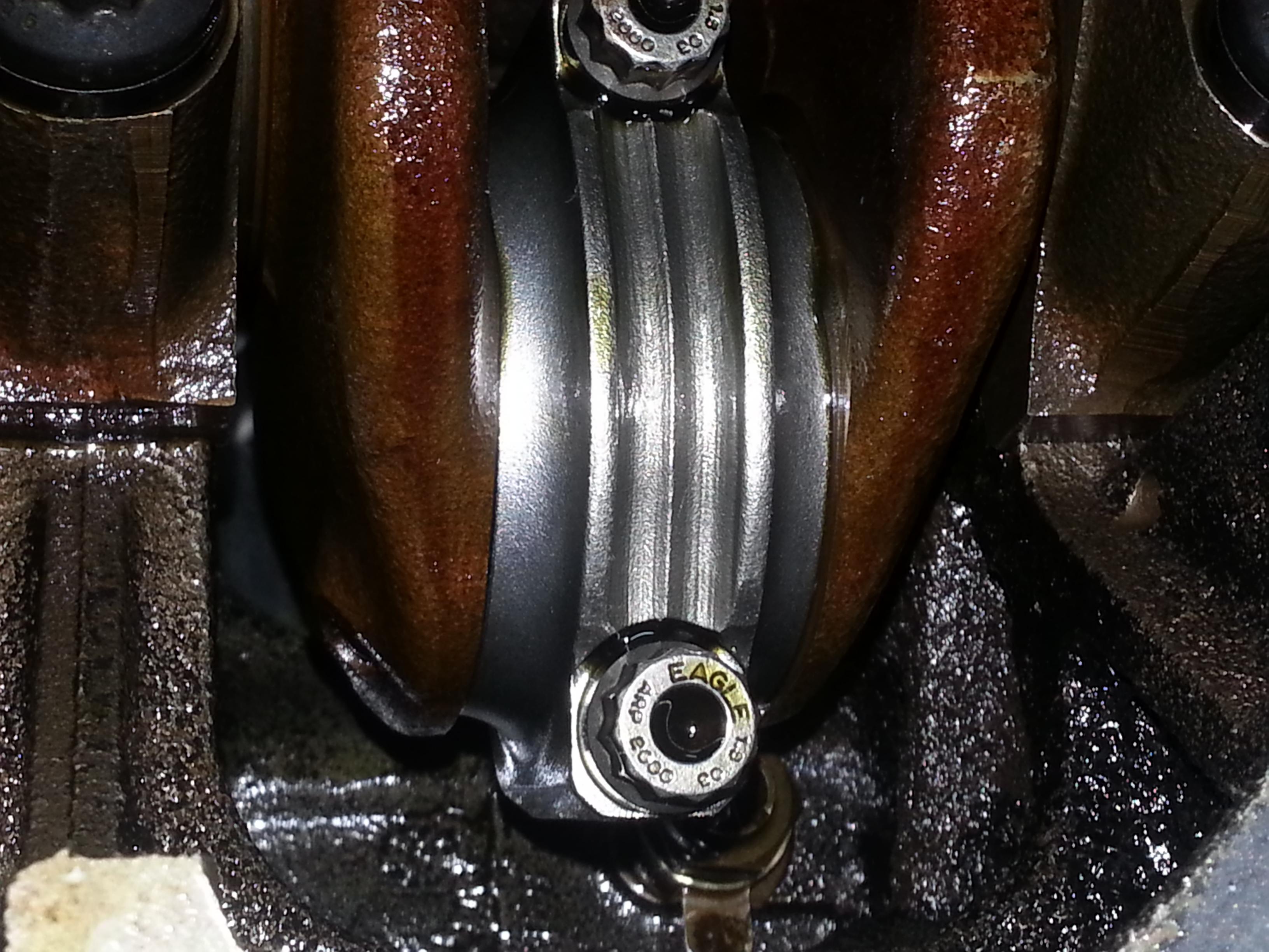

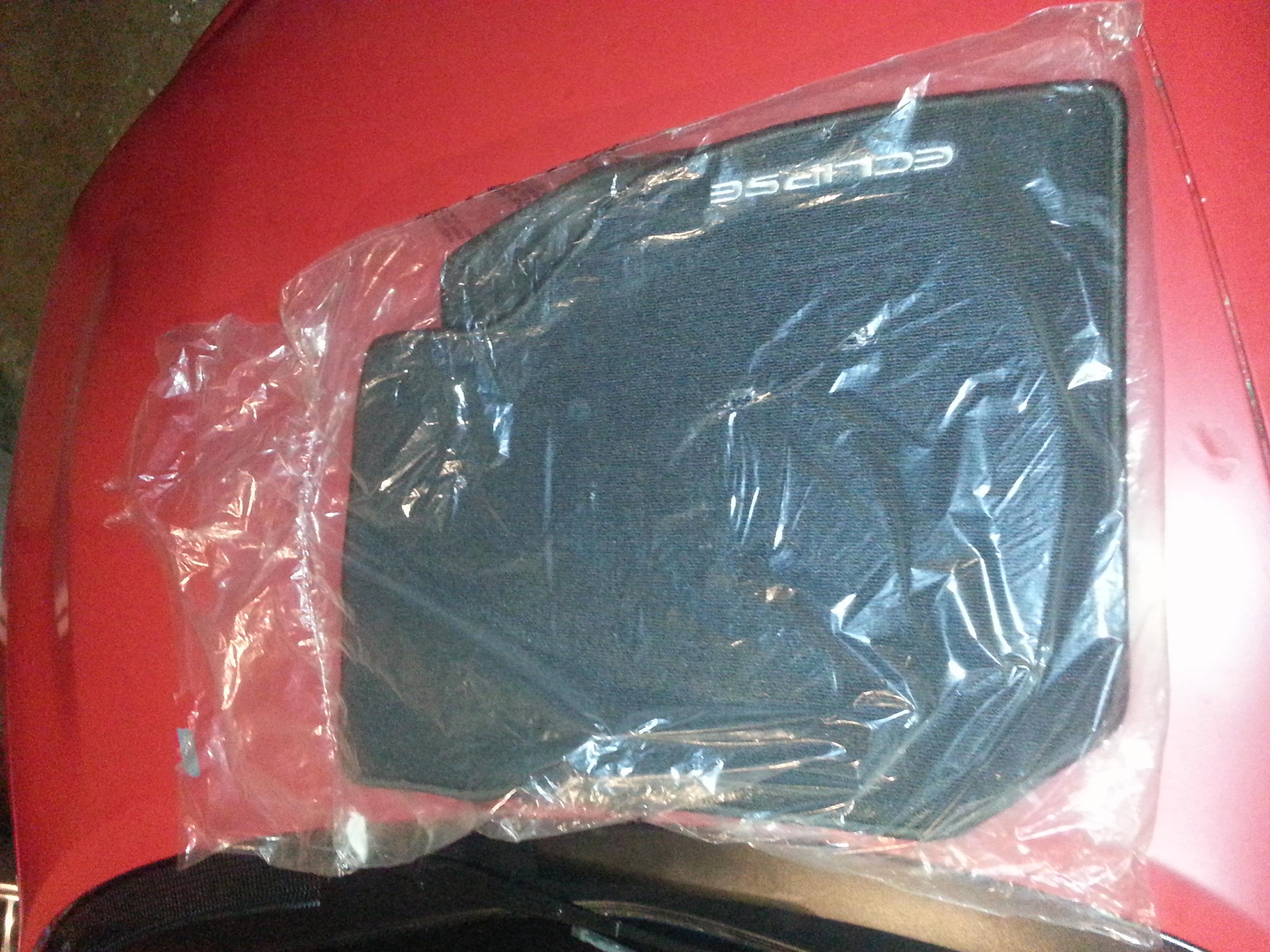

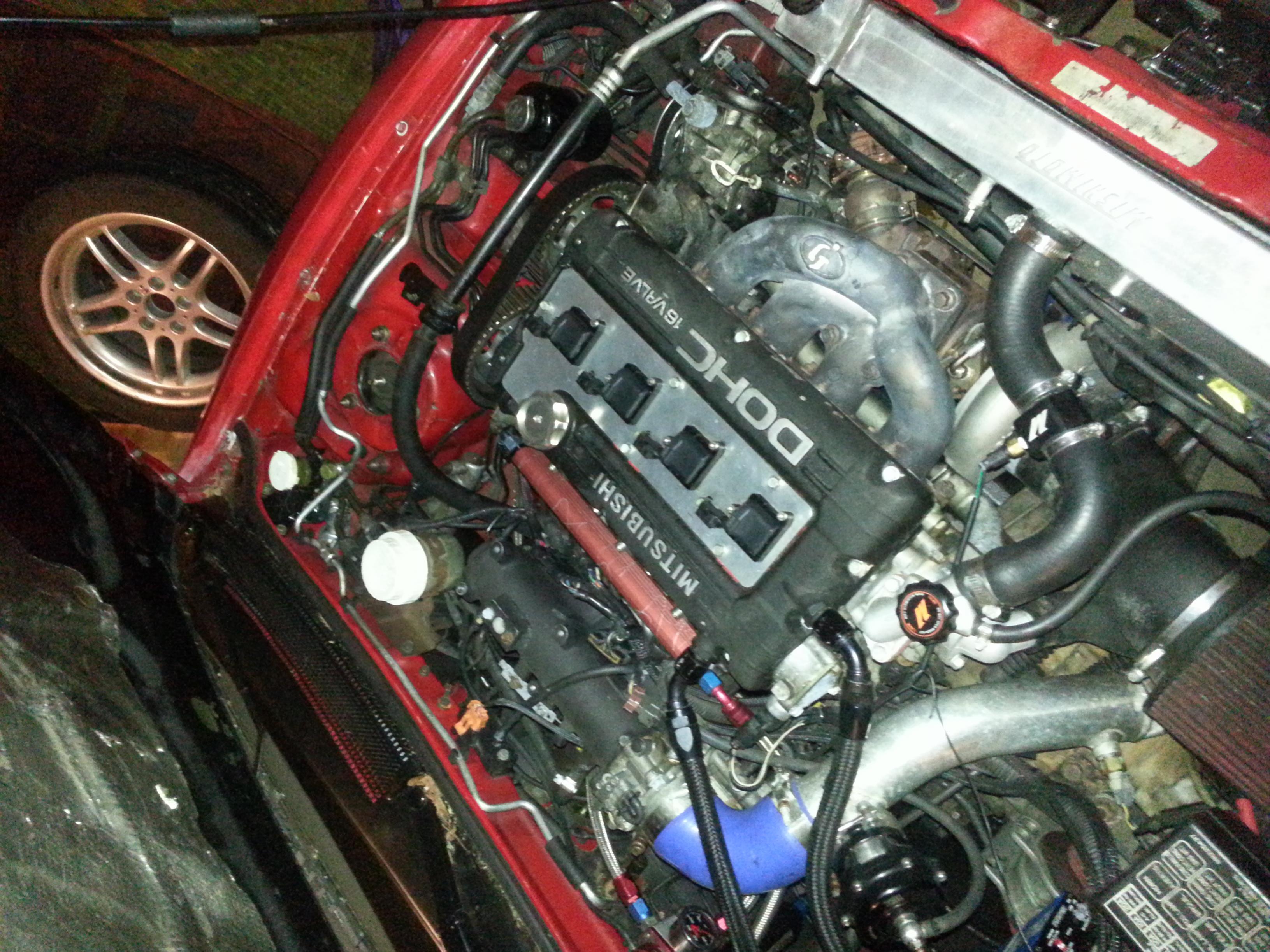

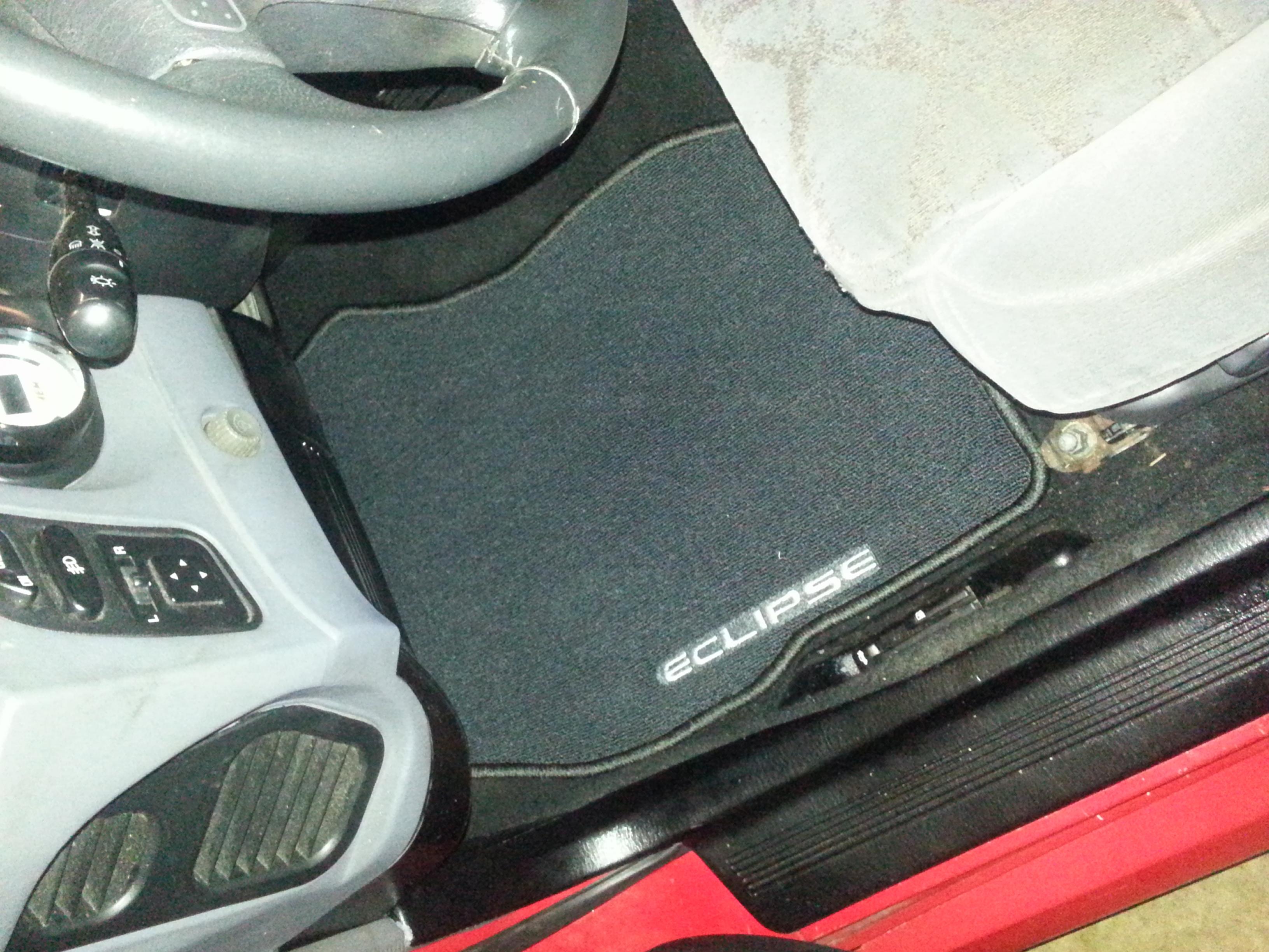

Well while I had the oil pan off i wanted to verify internals. Everything looks good.
I also put in the new oem floor mats.

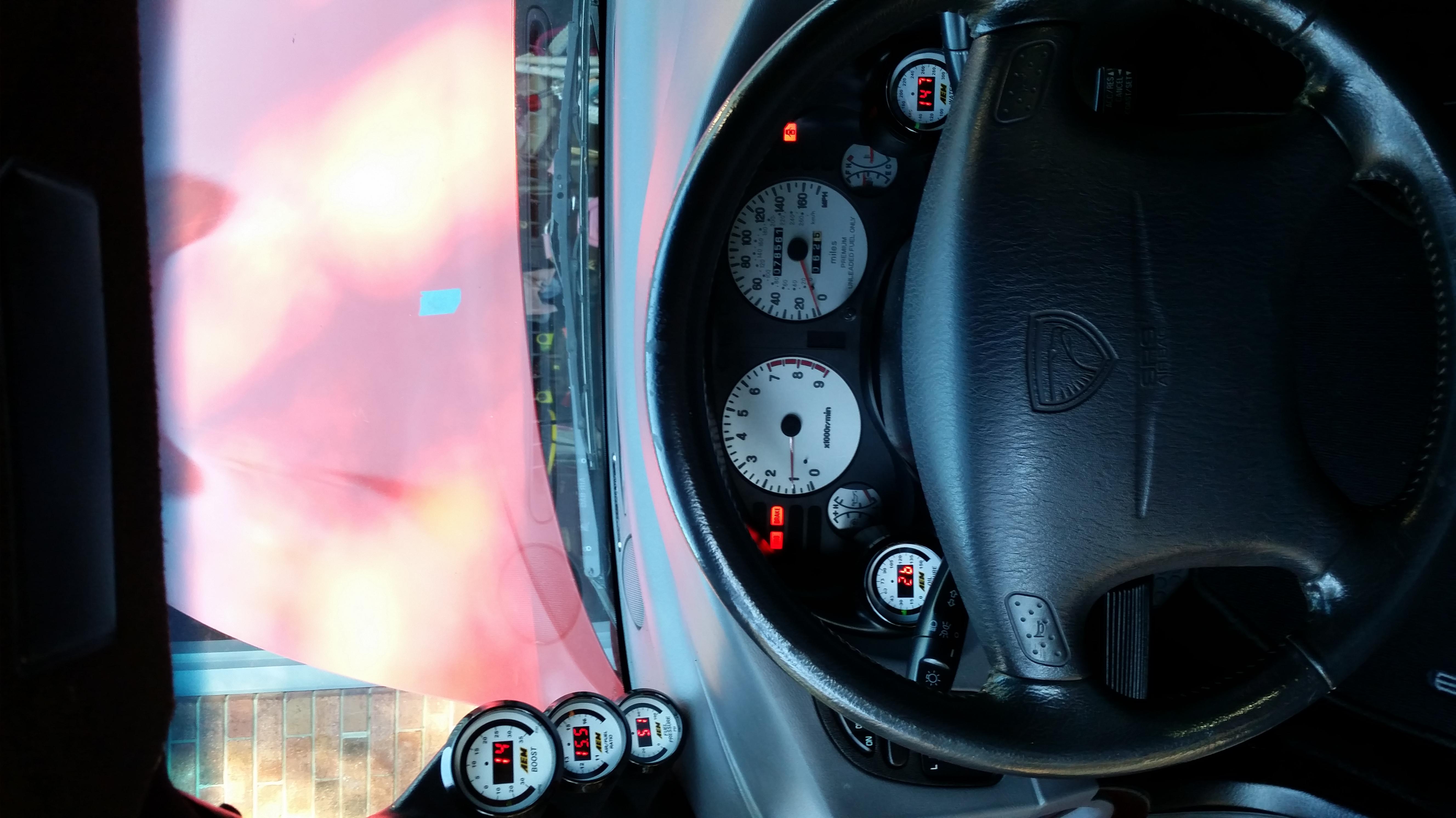

Got the fuel pressure gauge installed today.
I also took the car to work yesterday. Had a guy a work who drives a 03 v8 mustang with exhaust and intake talk crap all night to me. So on the way home him and I did 2 pulls. And not like it's anything special but was my first race in a long time. And I put bus lengths on him, was seeing 54lbs/min. With just the tune from my hx35. (9.7:1 a/f) tune needs to be reworked lol
