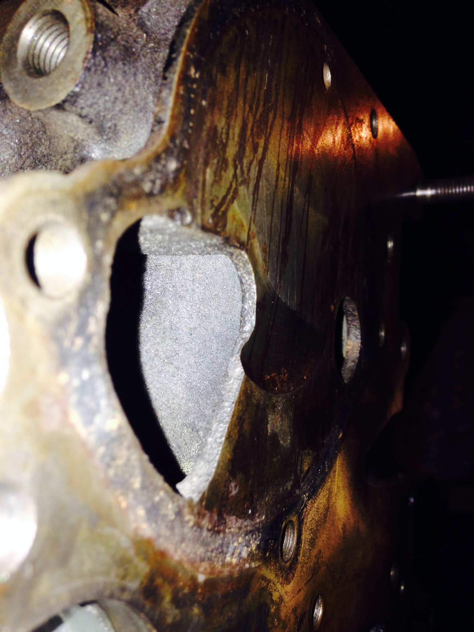

So I was going to start prepping the block for tear down and noticed that the guy who built it before jb welded the freeze plugs in, figured I could still grind and pound them out, but then I noticed this wear from the water pump.. This has me worried the block is no good. Any thoughts?

Take a clearer picture please, its very hard to tell. Looks pretty normal from that funzzy picture though

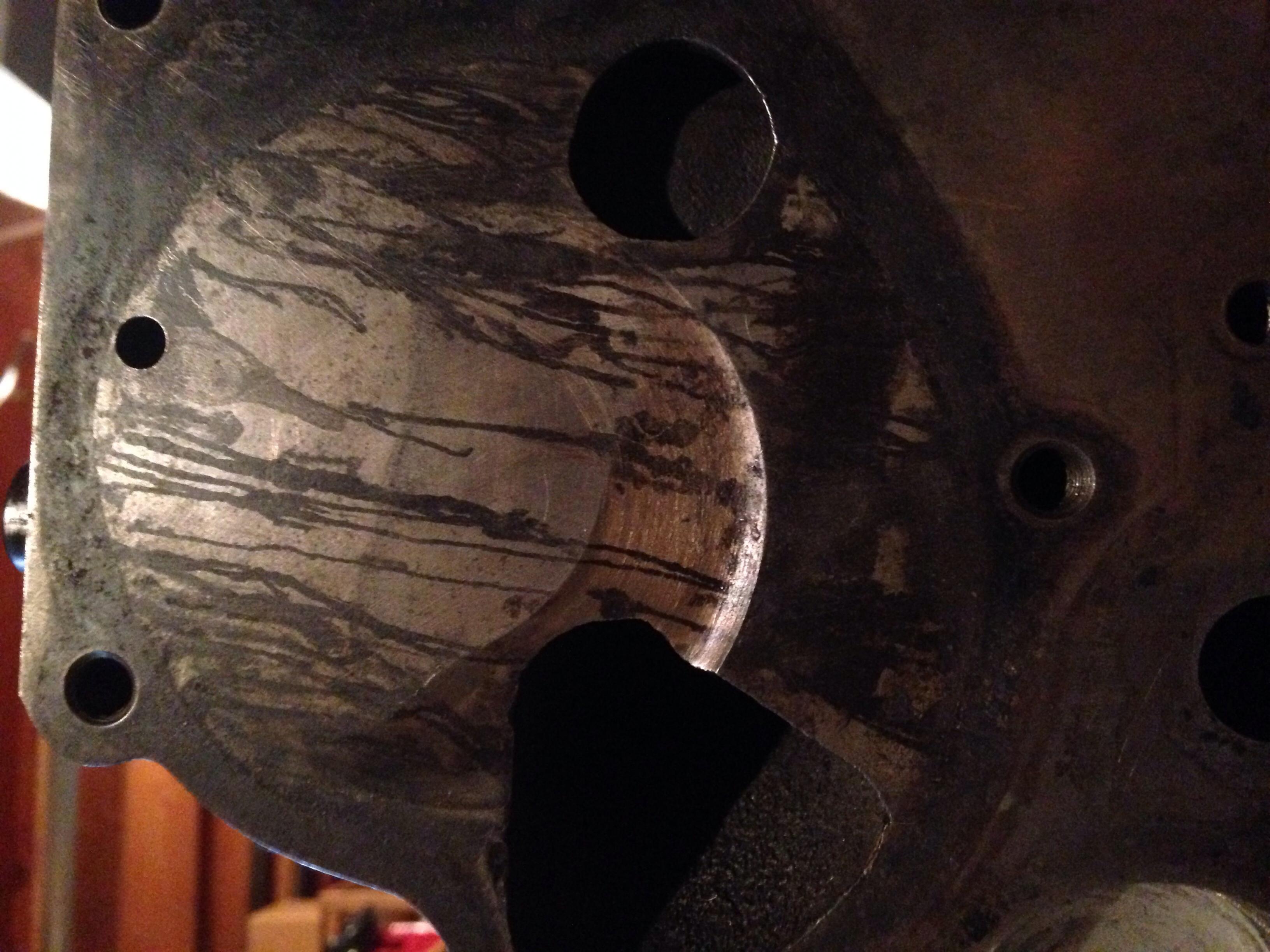

Sorry didn't realize it was blurry

Yea, there is definite wear on it! I guess I wouldn't be too worried, You'll have mroe water flow! haha
Old 10-25-2015   #5
Re: This block still good?!?
Hmmm, I wouldn't use it personally. It might be fine, but I'm not sure how well the pump would work with that huge clearance.

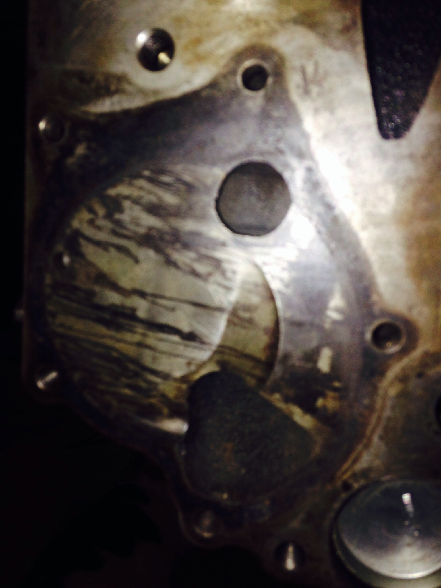

Brought the block into work, they said I shouldn't have an issue. But just for kicks since I got time yet, here's more pics

I think my old block was like that, I had no cooling issues driving it in 100* heat in TX.
I think you will find most DSM blocks to be like that these days.

Wow that sure is a big groove! Like Aaron said above, it'll probably work fine.

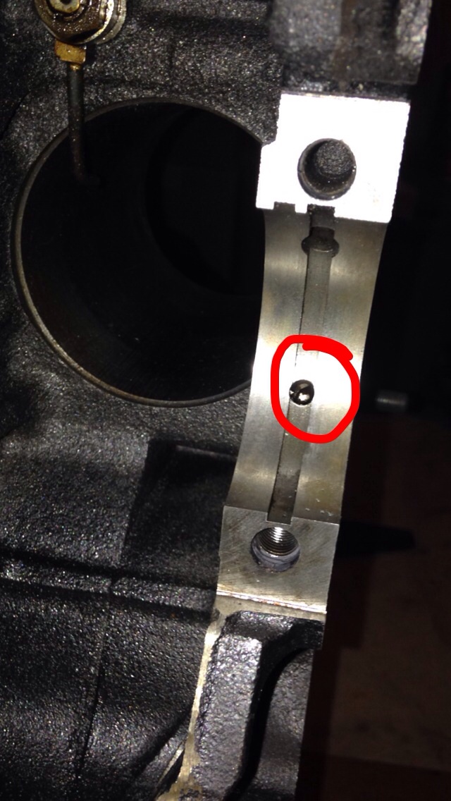

Well just found something else out. Any reason why they would have Jb welded multiple oil galleys closed? From the #1 main to the front case and then 2 more

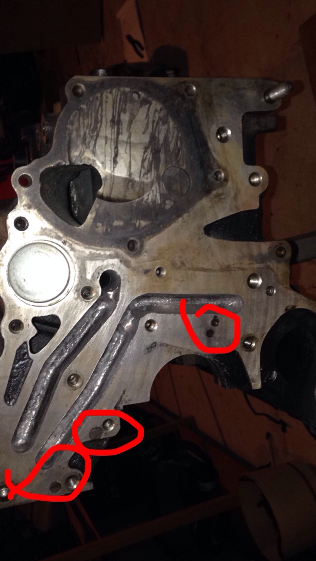

Any reason?

wtf. Yea, use a different block now.

blocks are cheap, don't risk it. The majority of the $$ you'll have tied up into it is not in the block casting itself, so sense in risking it on a sketchy block.
