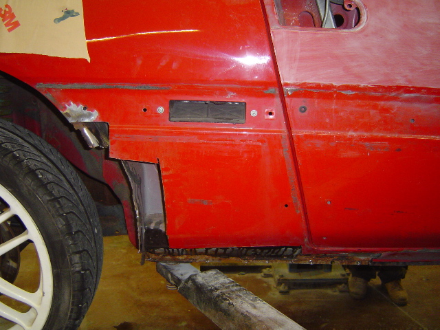

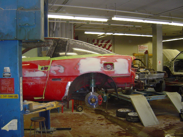

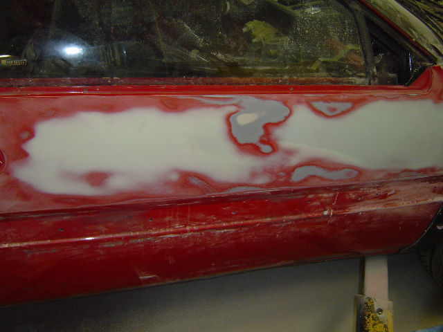

day 1 jul-19
took the rest of the car apart bumpers,skirts,door caps,ect
found the quarters are rusted out will be fixed
started to fix all dents on left side of car
pics of before taking it apart

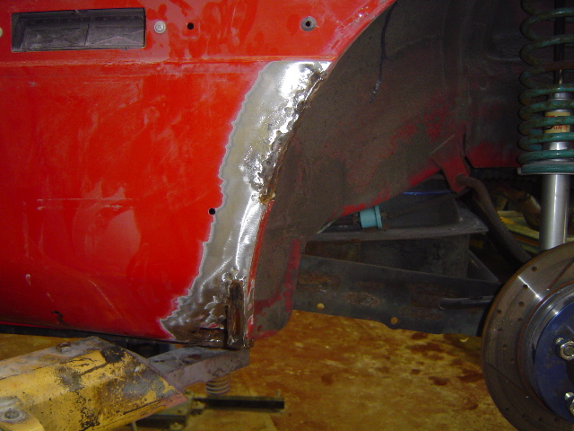

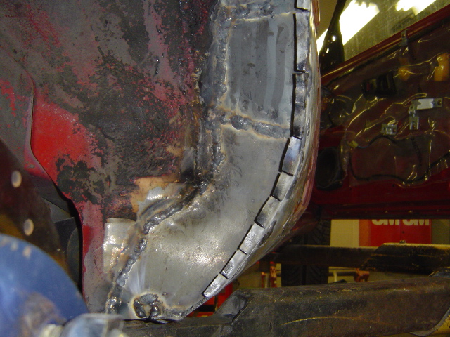

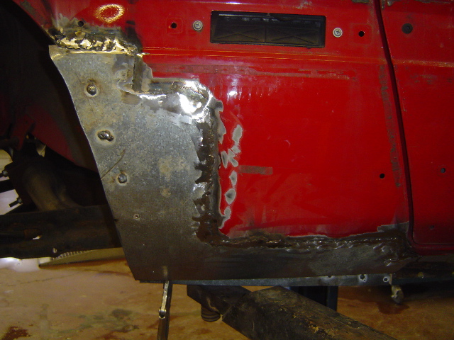

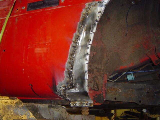

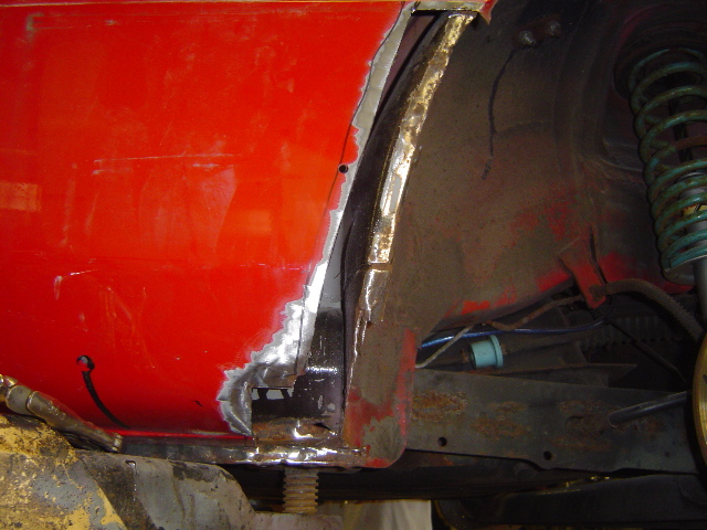

day 2 jul-20

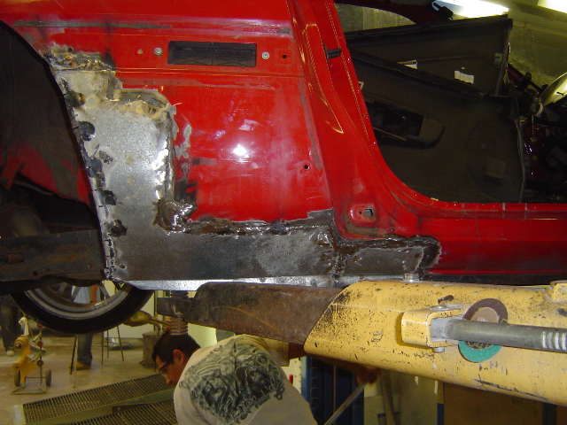

finnished left side of car
cut out right side rust and made panel and weled it in
started on left side rust

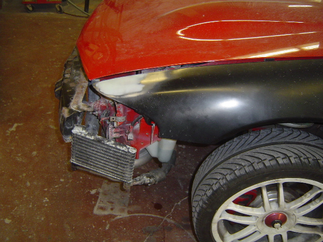

Re: painting my 92 talon at school (dunwoody)
july-22

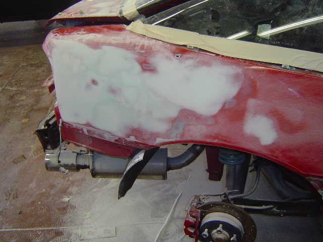

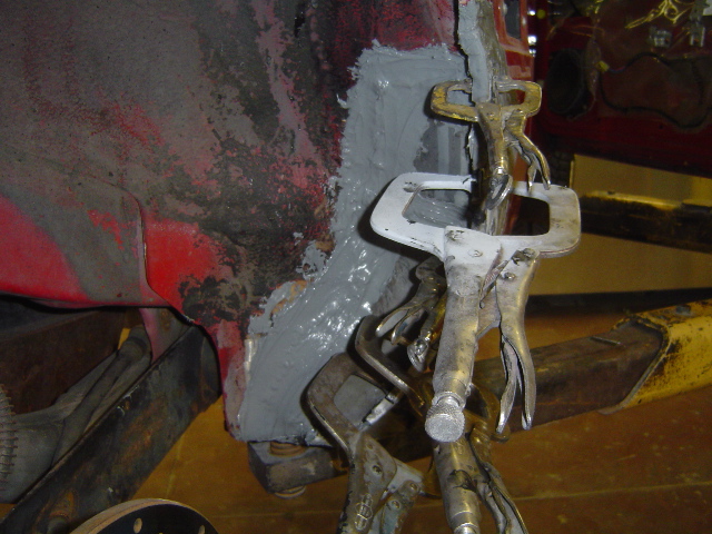

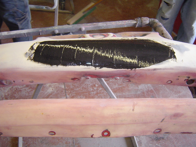

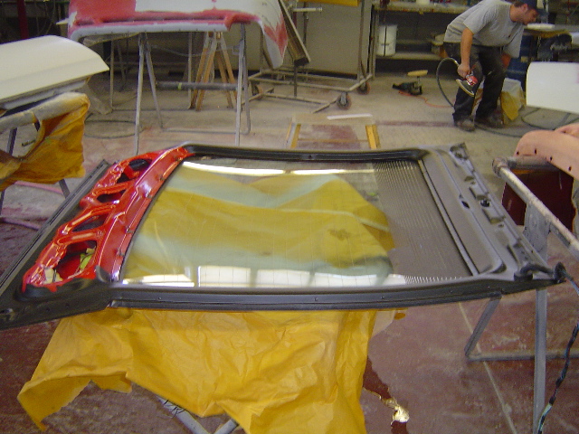

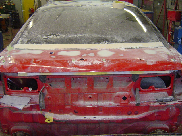

got the left cut out and patch welded in. seam sealed both sides. glazed the hatch and ther roof (had hail dents) fixed the high spot new the new left fender. surfaced the rear bumper

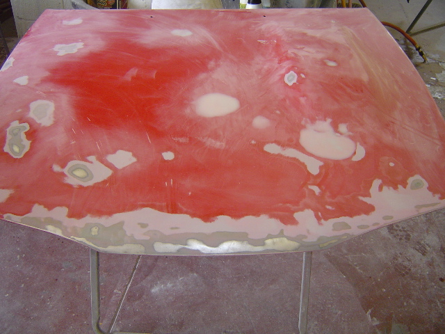

the hood I picked up
fixed all the dents and rock chips

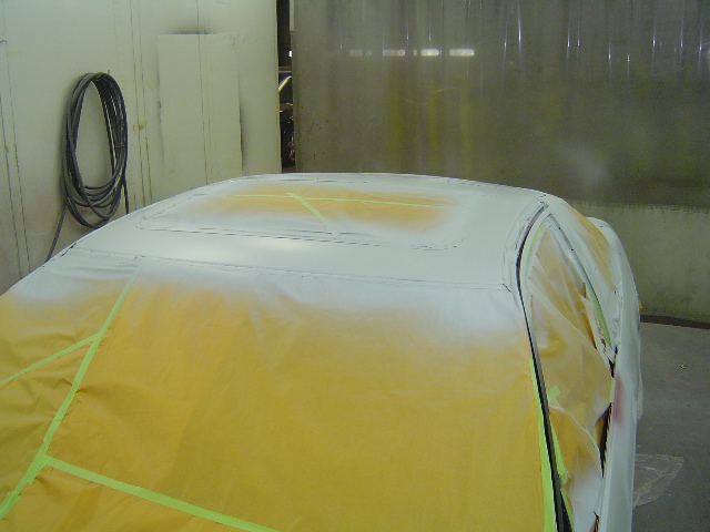

july-26

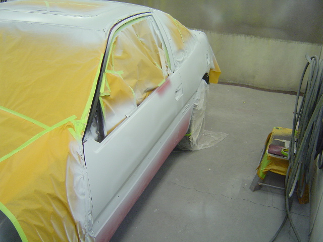

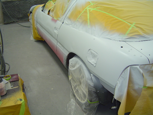

got the car in surfacer

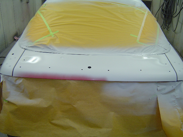

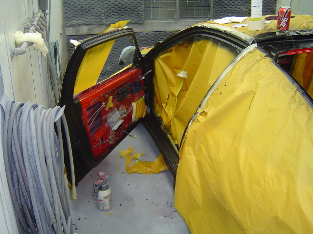

Old 07-28-2005   #19

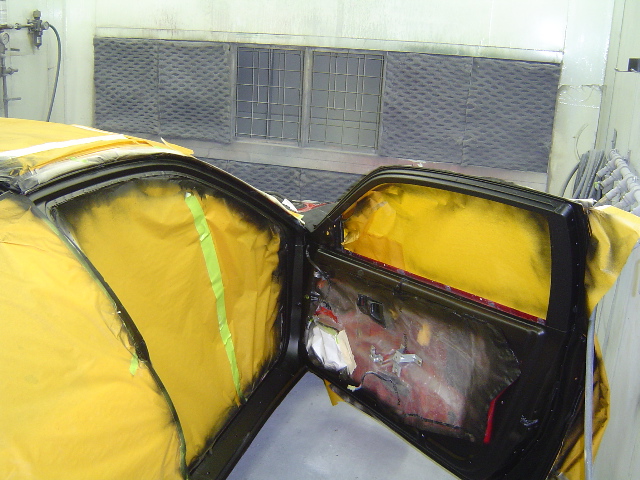

july-27
sanded all the surfacer
jamed the doors,hatch in flatblack
