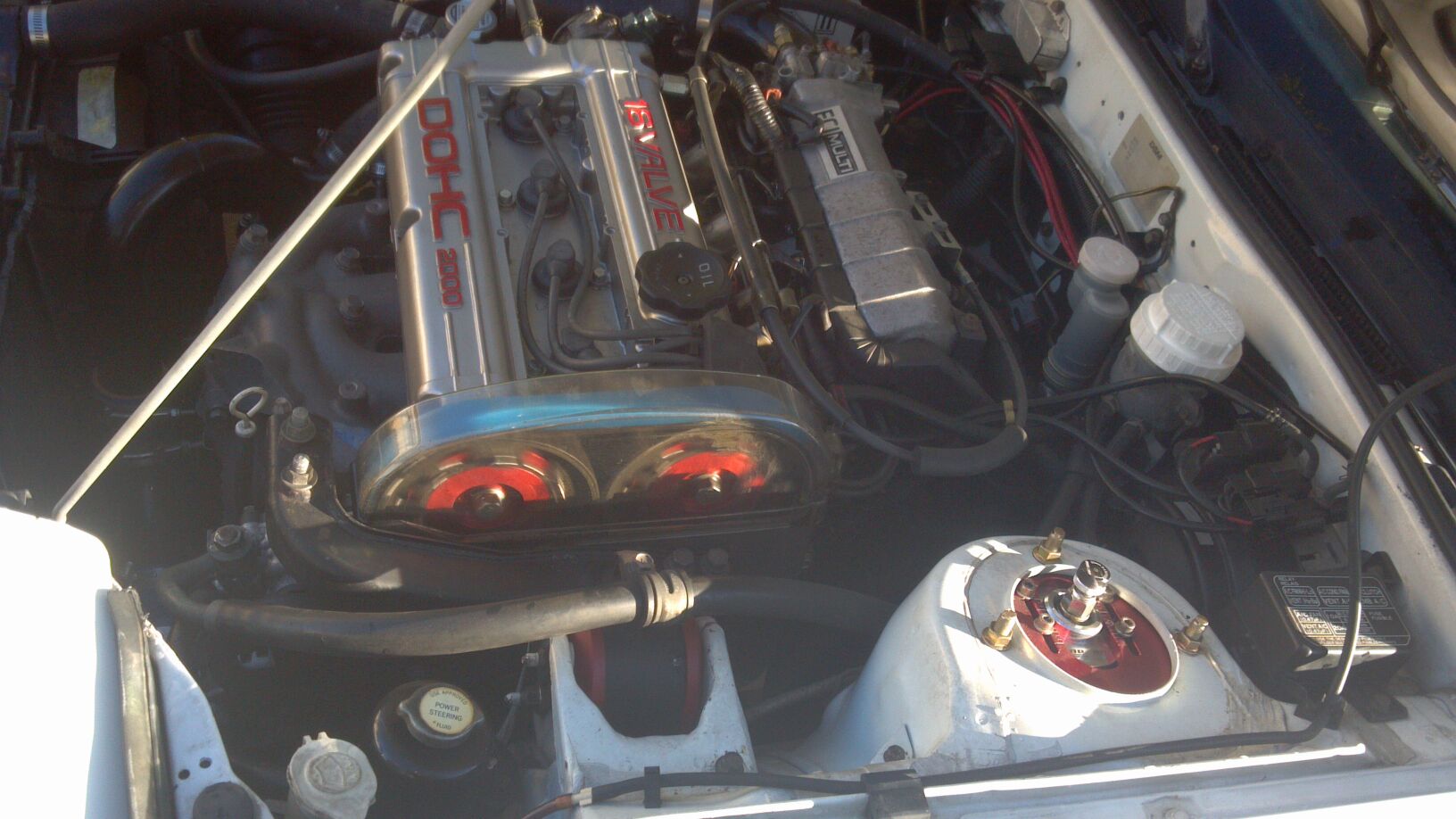

he said he had the bottom end rebuilt last year, not sure about that..
i drove it for alittle bit and everything seemed okay.
i took the oil cap off, not any blow by coming out. took the dip stick out and no pressure came out. (i did this just to see if
it had blow by since i didnt have a compression tester on me, not sure if thats a legit way to check it, but i read on a different site that that was a easy way to do it) overall it seemed good, besides the smoking..
as far as the smoking, I figured the first thing i would do is check the ic piping to see if theres any oil in them, sure as hell there was. in the intake part, and in the j pipe. so im hoping the turbo seals just went out.
any advice would be greatly appreciated.
