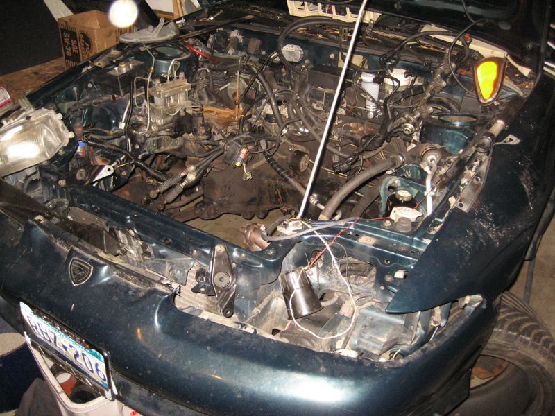

Well, since my engine ate a bolt (I think it fell into the exhaust port during the swap, must have fallen IN during cranking, and bounced around once it was on)
Now is time for the goodies, time for a rebuild!
Punishment Racing DSM FMIC kit (I dont like the cast aluminum end tanks)
Cyclone intake manifold
Megan Racing springs
2.0 non-turned .20 over
weiscos/eagles
gonna keep AC/ABS

Well, I am running into fittment issues with the FMIC kit
I will post up pics tonight.
The question is: should I use my 14B turbo? it has zero shaft play, and we took it off a 200k+ DSM, so it HAS to be a factory replacement.
Or I can steal my brothers V-Trim
the car is chipped for the 650's and 2G mas and it has a 190.
it has BC 272 cams
would 272's/14b be fun? I cant remember driving a car with a turbo so small, LOL.
this is my DD, keep that in mind.
building a 3000GT AWD Turbo.

Originally Posted by User Name View Post
What issues are you running into on the kit?
I have ABS, and they clearly say that it will fit... i think i will be ok with a 2G throttle body elbow and a longer coupler.
Also the AC is very much in the way.
And you need to loop the power steering cooler.
Got the turbo on tonight with the stock "fire" ring in it between the hotside and the manifold. (leaks less when installed)
