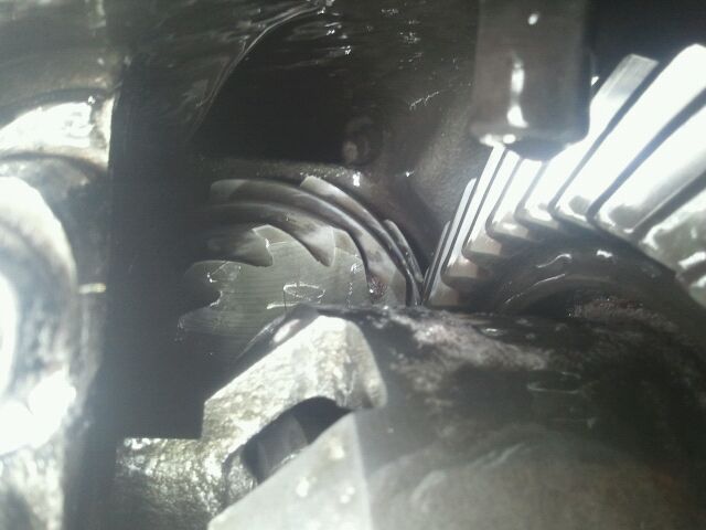

Still need to get the gear marking compound but here's just a quick look inside.

Lol, looks to me like there is no preload. Definitely not good. That pinion and differential needs to be shimmed and have the preload set correctly.

Re: Very Bad Vibration
Feels like there could be none when driving lol
The vibration does get a lot worse with increased speed.
Might double check my work and that there is actually a shim on the 5 speed pinion gear/shaft I got.
