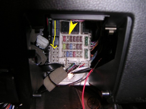

Here is the fuse chart and a photo of the fuse block (ignore the yelow arrow). It doesn't make sense where the block of four fuses with the damn sunroof fuse (#21) is?!

I think its this one just from looking at it, put a 10 amp fuse in there and see. Im no evo expert though.

Finally found something that looks promising: http://www.evolutionm.net/forums/evo...roof-fuse.html
"Fuse 21 is in an add on holder made of black plastic, lower left side of junction block, containing a 20 amp fuse."

Just like I said in the SB. Follow the wires from the main fuse block, the square plug on the lower left, follow that to the add-on fuse block.
Shit, I think you might be right. I need to go look at my car. I wonder if it is hidden behind a bundle of wires.

Its right THERE. LOOK STRAIGHT UP FROM THE WORD FUSE. See that little yellow thing? Thats the black, add-on fuse block.
Its right there.

Werd. It was hidden and nobody called it out as behind the wires earlier

LMAO becuase you posted a shitty picture that had that entire fuse cluster covered. Pete you win this time! Shakes fist.

I told you an hour ago, to follow the black wire coming from the square plug, from the bottom left of the main block. Follow the wire DOWN AND BEHIND to the black, add-on fuse block.
