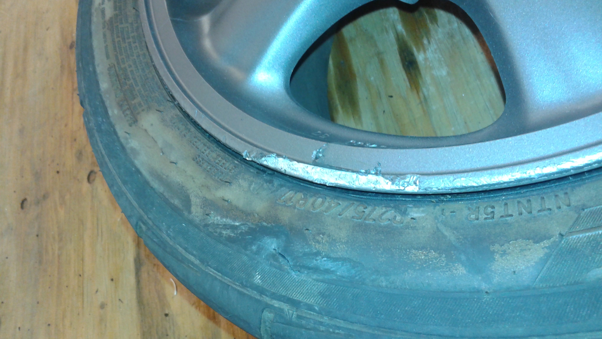

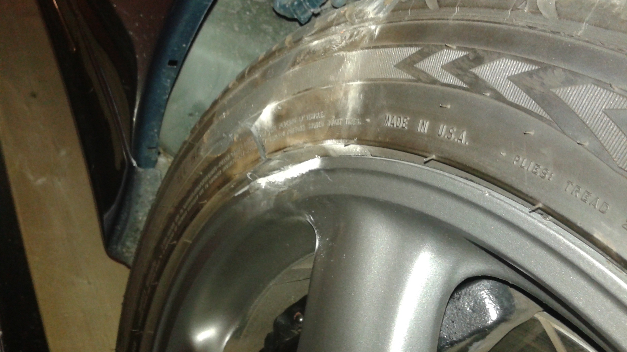

Then leaving the meet, in 2nd I gave it a little too much and got a little sideways and hit the damn curb. *Feel like an idiot. *Drag radials, cold weather, slight mist, and me still getting used to the power it has = dumb mistake. *So my wheel is hurt and i popped a tire. *Also the fans had shut off for whatever reason so while we let it sit and idle coolant started coming out of the overflow. *That's when we realised the fans didn't turn on. *Shut off the car, the BTI gauge showed 219* when I finally looked at it. *So... *Now gotta figure out what to do about wheels, and going to investigate the coolant issue, hoping I didn't pop the head gasket. *I've post-poned my dyno appt so I can take my time and make sure everything is OK before I stap her on. *Sucks, but could be worse. *Doing my best to get back on the horse here and fix it and keep moving forward. *I figure it could be worse, it's not like it caught fire the day before trying for 6's at TX2K right? *I'll be fine, and I'll get it fixed, not so bad really.

What position wheel is that? I assume the front so that you still can replace the control arms and hopefully not have any bent suspension parts?

Passenger side, front and rear wheels. Front one is worse, and is the 2nd picture. First pic is of the rear. I looked under there briefly, didn't notice anything bad, but something I'll be looking at for sure as I get to looking closer. Good news is I have all new front arms that I'll be installing none-the-less lol.
Good news is local place in White Bear said they can repair the wheels. $100/ea to repair (not including coating). Typically 1 day turn around. So I'll be getting those over to them in the next day or two. Seemed like a fair price and an excellent turn around time.
