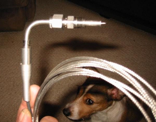

Here's the probe Raptor was talking about.
First of all, it has a 90 deg bend, not straight like the TRE.Not sure if anyone cares about that, but I like the bend much better.Its the fast acting exposed junction like the TRE.Sheath is inconel, NPT fitting is 316 SS.It also has 7 feet of stainless braided k-type wire attached, with heat shring tubing on the end.Overall quality is top notch

Originally Posted by Jakey
Is that an Omega probe? Price?
I don't believe so, I'm not familiar with Omega, but it's made by a company called Temperature Systems International.Price should be right around, if not cheaper, than TRE's price.
