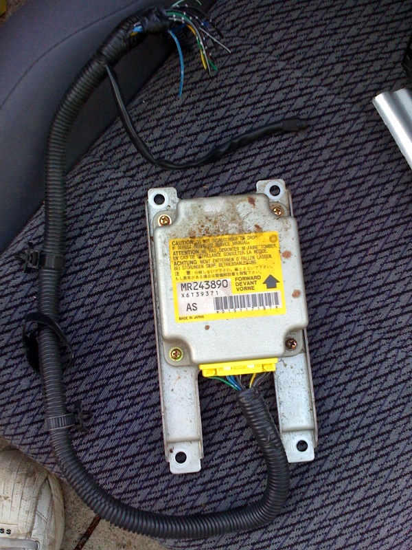

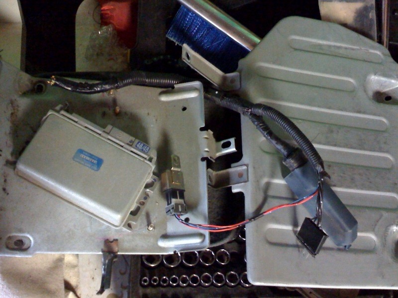

Since the car is down for the week, I did quite a bit of work I've been too lazy to get around to the past year or two. My car has had the SRS and AntiLock dash lights on for a long time now, both computers are toast.
Two months ago I removed the braking portion of the ABS, but today I took up the carpet and passenger foot rest and took out the computer and a couple feet of wiring.

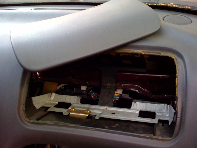

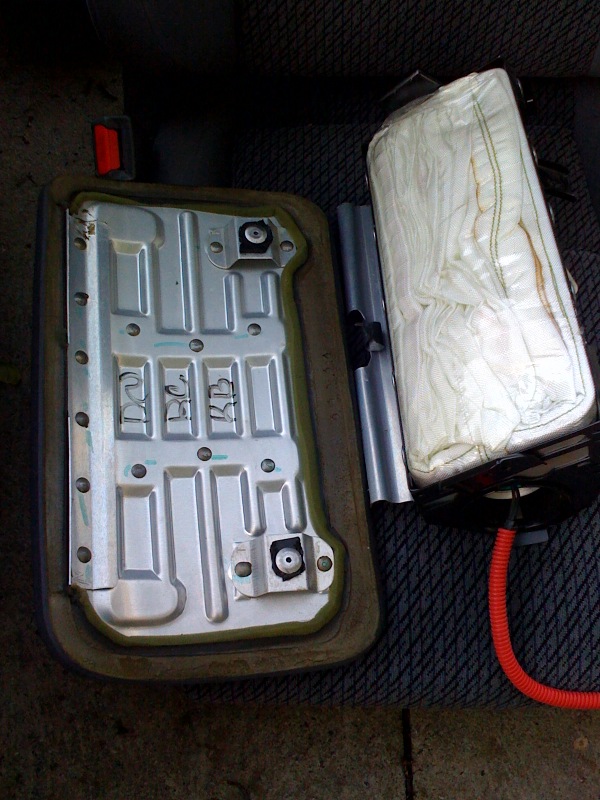

Removed the passenger airbag:
Here is the cover about to go back in:
Airbag computer:

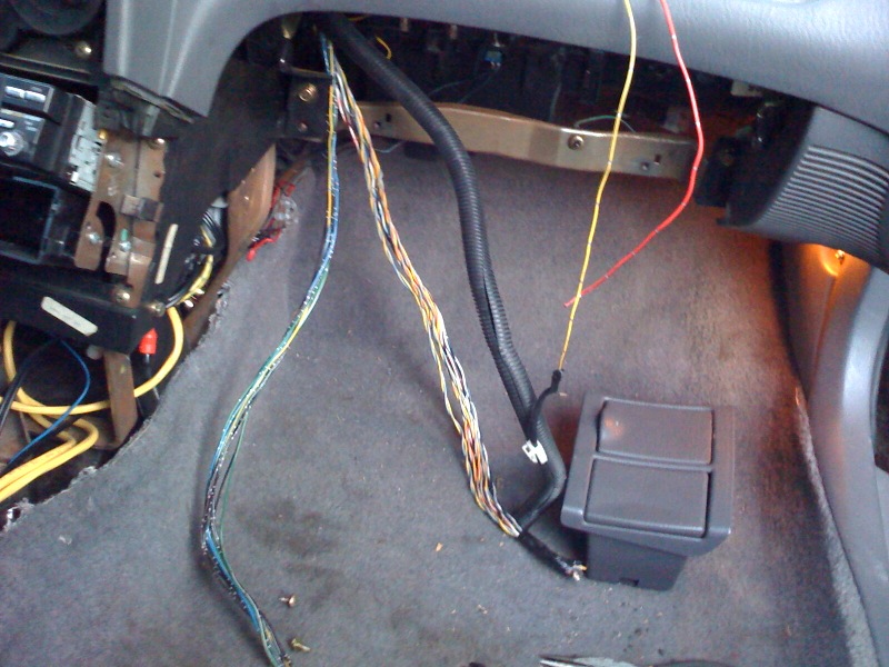

And a bunch of wiring that was no longer needed. Left group was for the airbag computer, right group was for an unknown harness under the passenger seat. The only thing I saved out the entire bundle was the ebrake light cable (hanging yellow)

The right group is wires for the stock infinity amp under the passenger seat.

Thanks. At first I thought it was for a powered passenger seat, but there's too many wires. Also, that explains why the red wire that's hanging had power without the key on. It sparked on me when it touched a ground, lol.
