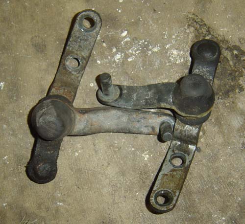

check with Carl he bought my 91 trany and suposedly linkage on 91 and 92 are different.. he re-drilled a hole on the linkage and he was fine after that. or he could of just used a 91 cables i think.. suposedly somethigns different with the cables or lenghth on top of the trany where the cables connect to.
if you look at the two arms that two cables conect (on the trany side), the lenghth of them is different.

Enes is on to something. Here is a pic of the two linkages. The 91 lincage is longer than the 92. I swapped that and it still doesn't work. I PMed carltalon to see what he had to drill. Thanks a lot Enes. Hopefull I can get it running without pulling it off again.

I hade to drill a new mounting hole in the other linkage to shorten the throw. check the stationary mount where the cables mount to the tranny it was different on mine. good luck

Looks like you had the same problem as chengsta had. Mine are both parallel though. Seems as if the linkage is too long though. Maybe the car would not want to go into gear as the clutch was not engaging all the way. Does this sound like it could be my problem?
