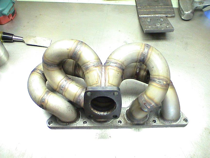

Here's a pic of the AlienAuto manifold. Sorry about the size.

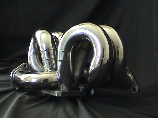

Pic 2 "polished" by AlienAuto

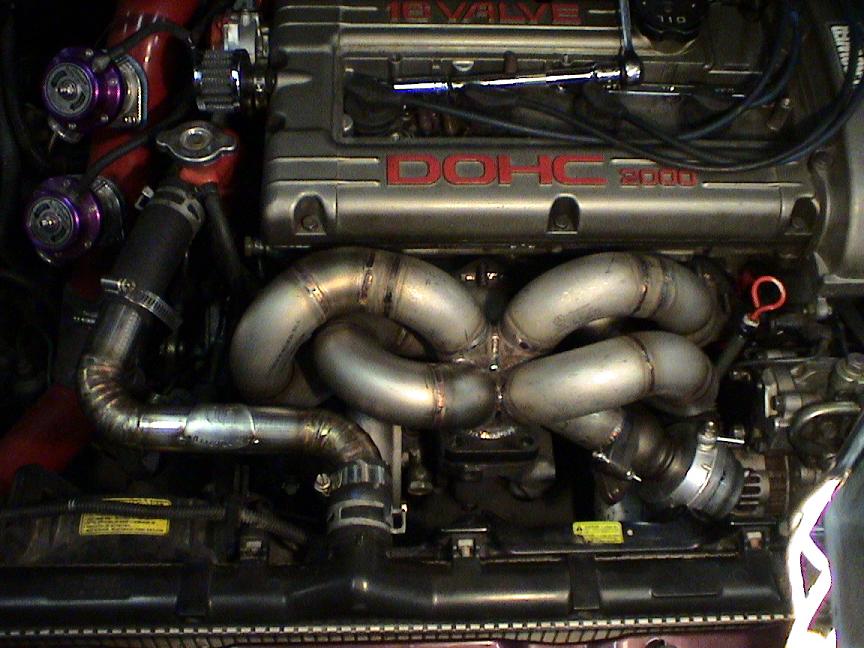

The stainless upper coolant pipe is included in the price.

Are you going for the polished look or the raw finish?
Proud to be a Cyclone
Old 02-21-2005   #30
1ViciousGSX's Avatar
Posts: 5,382
Re: Like fine wine,.....
Well polished of course.

What material does Alien use? It looks like the flange is different than the runners. What thickness is it? The #1 runner turns very quickly after it comes out of the head. I don't even think it is straight in the beginning. I like the polished one a little better where the runners come together.

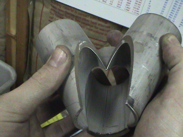

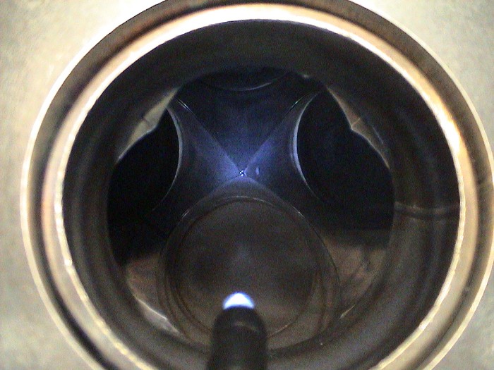

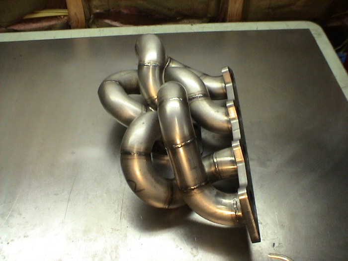

1/2 inch carbon steel flanges, 304 stainless tubing. 321 flanges and tubing are available, but the price goes up. If I remember correctly (and I may be wrong on this) they said it was 8-gauge stainless tubing. I have some more pics below that show the thickness. I also have a pic of how the runners exit the head flange as Jet has a concern about the runner turning too quickly.

Yeah, #1 looks a lot better from that angle. I would upgrade to the 321. The other one will definately crack. I do like the WG coming out of the collector, that is where it should be at. It looks like one of the better designs that I have seen.
