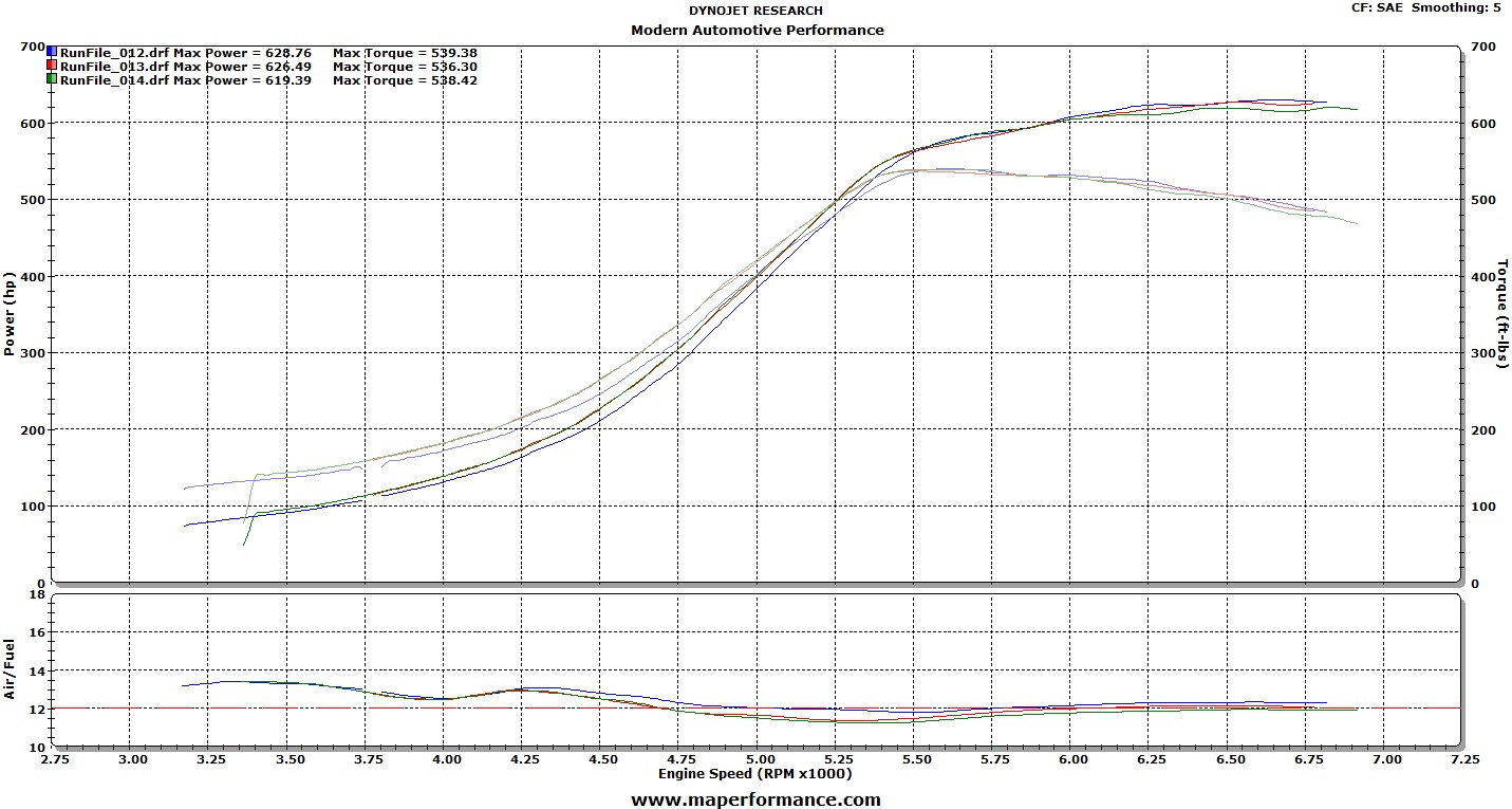

Well did my 3 pulls at MAP today. I saw a 16% difference in the 2 dynos. Also, mine is still miss-firing, but it revved cleanly to the point where it was making max power anyway. So you'll notice the graph only goes to 7k, because that's where I started missfiring.
So the guesstimate of about 15-18% sounds about right on.

Very interesting, I always wondered how the spool would be different on the 2 different types of dyno's on a higher hp car. Looks like the DD spools about 200 rpm sooner because it puts more load on the engine. Nice job brandon!

Nice! So now do you tell people it makes 628 or 541?

Damn that is a huge difference.. More than I thought!

You tell people 628. No questions about it.

Great powerband Brandon.

I'm going to consider it at 541 for the most part, because that is the dyno I plan on returning to mostly in the future. But if someone thinks it's a weak number because it's lower then what they expected, then I can pull this one out for comparisson.

I would just tell them to come and see how weak 541 is. But incase they wanted to know its about 600 DJ.

My wife's was right around 16% also. ~485awhp DD to 563awhp DJ
