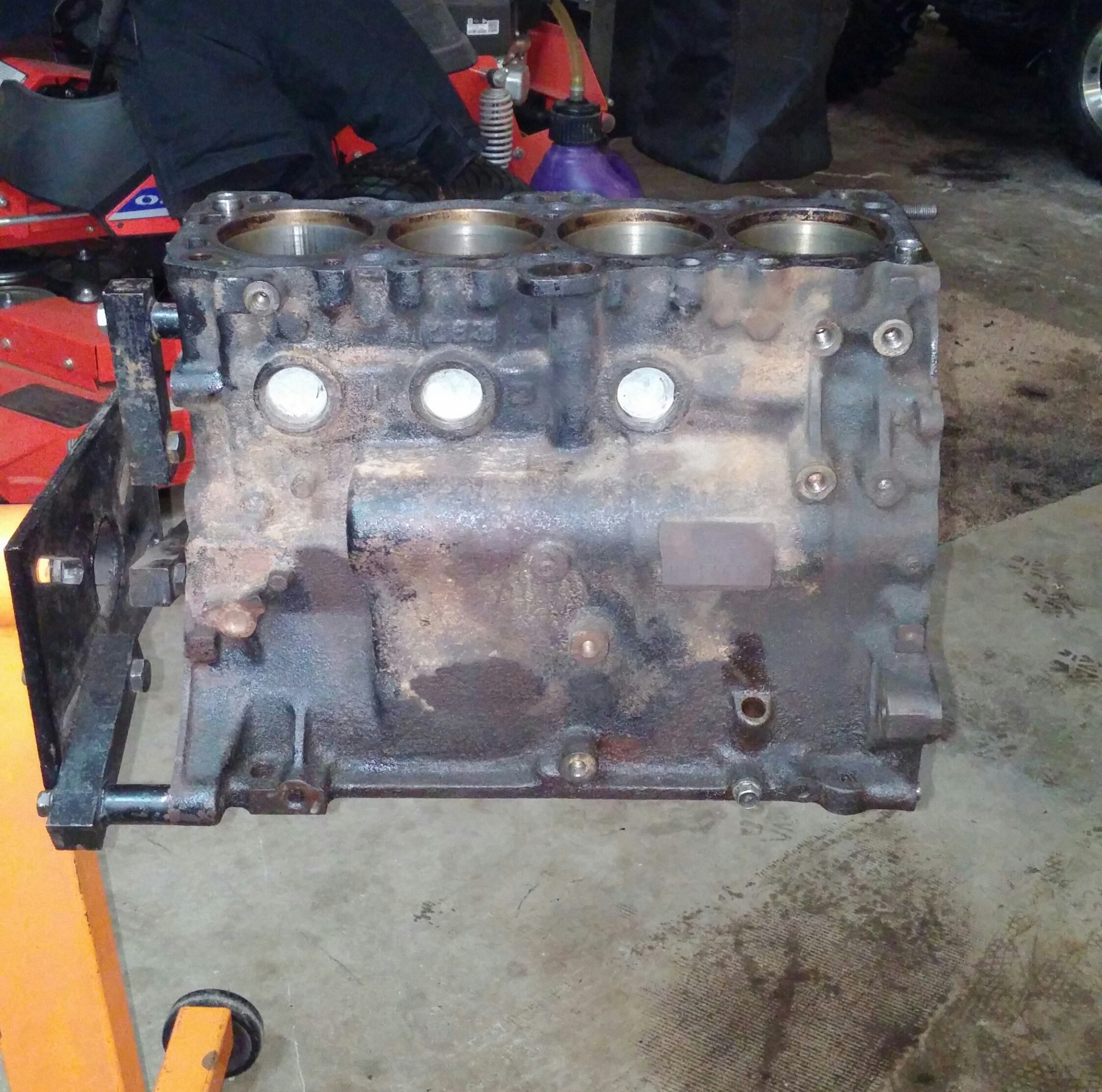

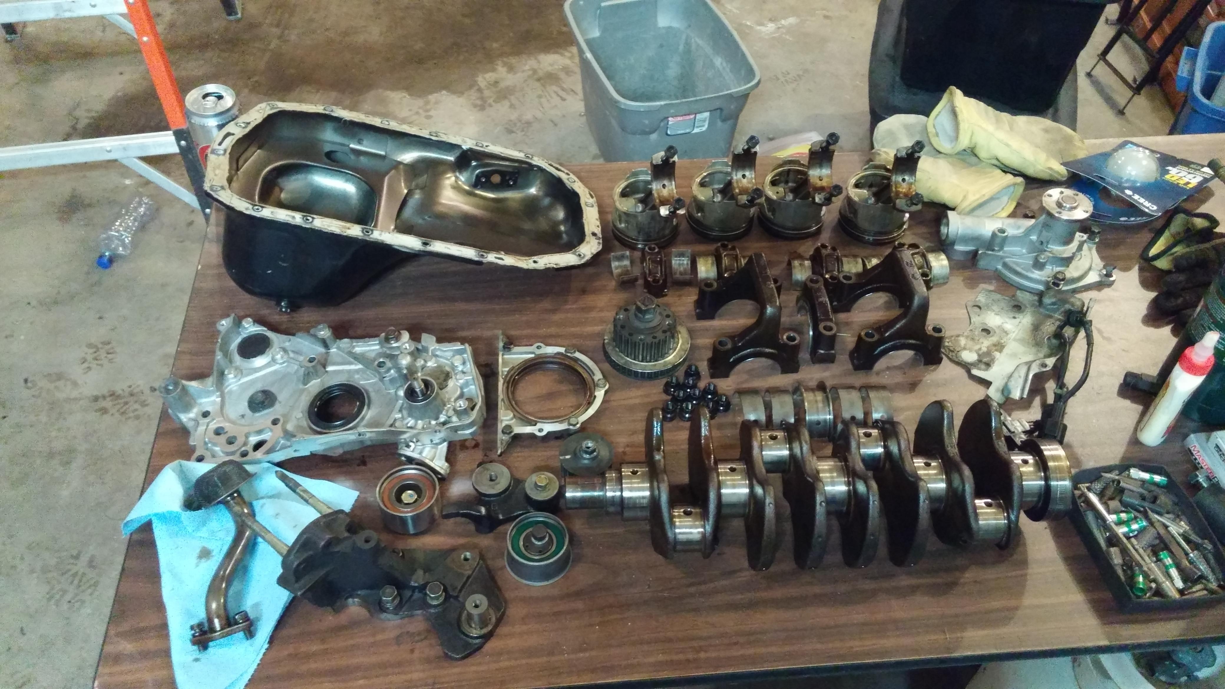

Got the 6 bolt i had bought a bit ago ready to get to gosh. Bearings inside were a little rough. Also found it had been apart before it had arp main studs with arp rod bolts.
