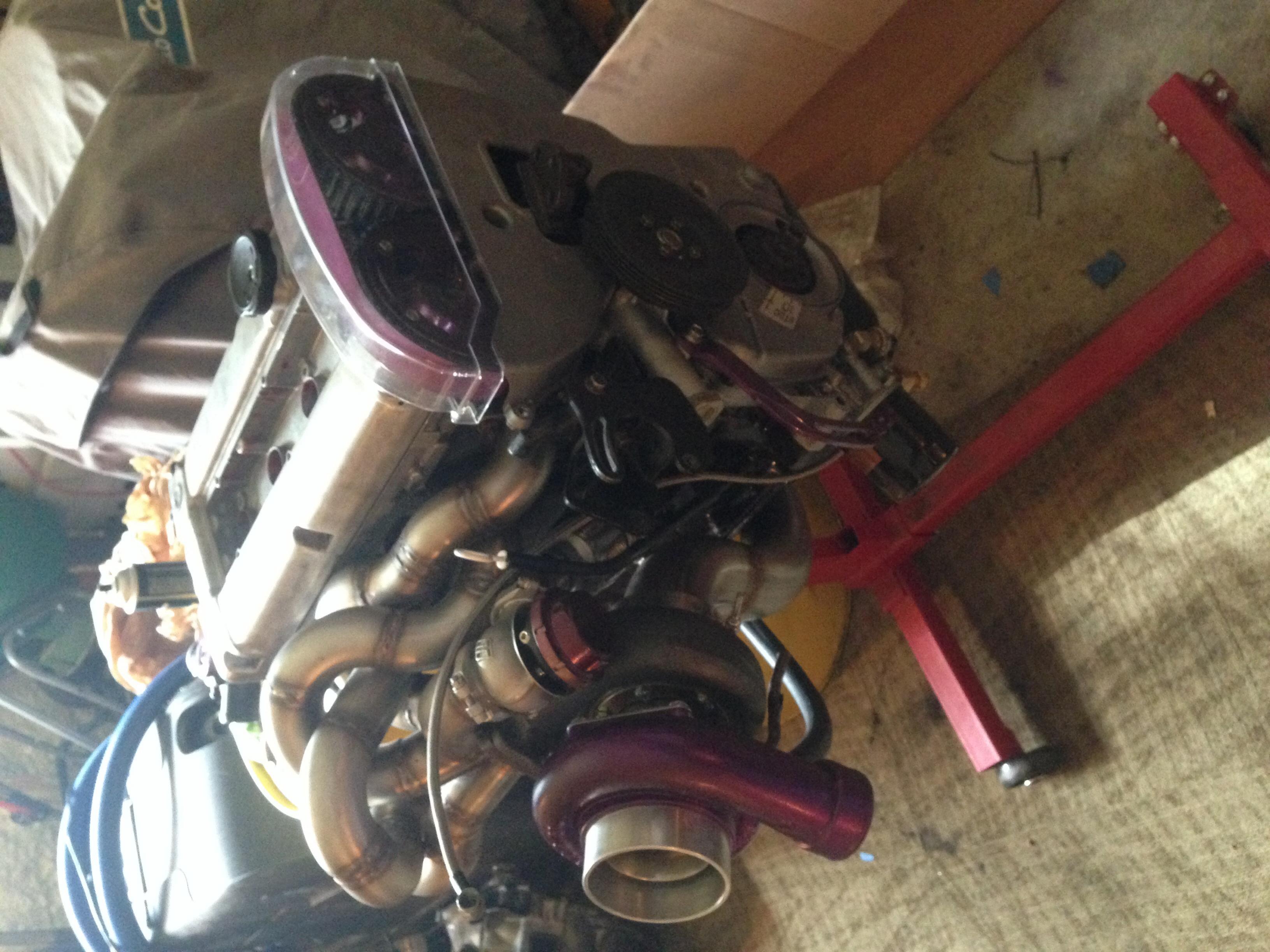

some updates, I have a new trans in route from canada. also I tore apart andre trans and lucky we did as we found a shim inside the center diff just waiting to be eaten up in there. Also his motor is now fully assembled and timed ready to drop in. sorry about the crappy lighting.

Yeah get some lighting haha, really cool builds you guys have going here. I'll be excited to see them at PG this year.

Thanks man deff gonna be fun trying to get kicked off the track
