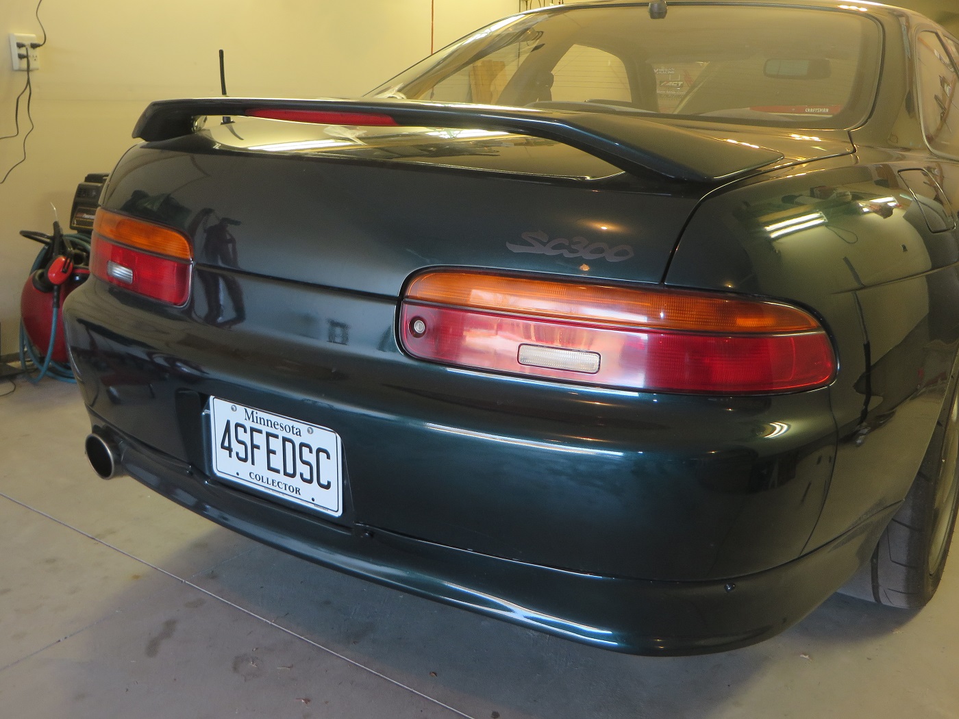

DMV sent me a present today Custom Collector plates. No more annual renewal, no more front plate!

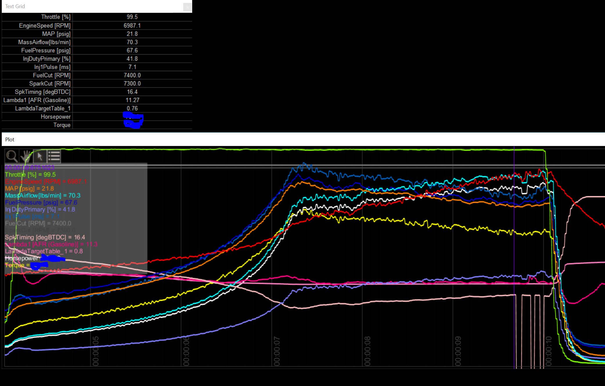

Today Kerry and I took it to the Auto Show and did a couple pulls. The new tune has us getting all the way up to 27psi by around 5200rpm, but gradually tapering to 22psi by redline. Holds better than it used to but still interesting how it tapers. I was sitting here staring at the log. I realized that AEM is showing that I'm flowing 70lb/min by 6500rpm and basically holding that until redline. This comp wheel is rated at 72lb/min. So being that I'm seeing 70lb/min, I'm wondering if I might just actually be about maxed out on this setup. My brain is so used to DSM stuff where I was pushing 35psi on a similar turbo to hit these kinda flow values, with 2 more cylinders now maybe I'm hitting those same amounts at less boost and this turbo will never hold 30psi to redline?
Anyway, car is feeling excellent! 3rd gear holds from a roll if the tires have had a chance to warm up. Here's a screen shot of my 3rd gear pull log.

Y U mask hp/tq #?
If your airflow maxed at the same time boost started dropping I'd agree. But your boost is dropping well before your airflow peaks. Doesn't hurt to step up the WG spring again, well might hurt to install haha.
That being said, you might hold boost longer with a stiffer spring, but if you're maxing out the turbo, I think you'll never be able to hold the 27psi+ to redline. Mo displacement mo problems!

Because the are BS numbers. If u wanna know what it said for HP, just take the airflow X 10. That's all it's doing. So I scribbled it out so some 17 y/o newb doesn't mistake it as real.

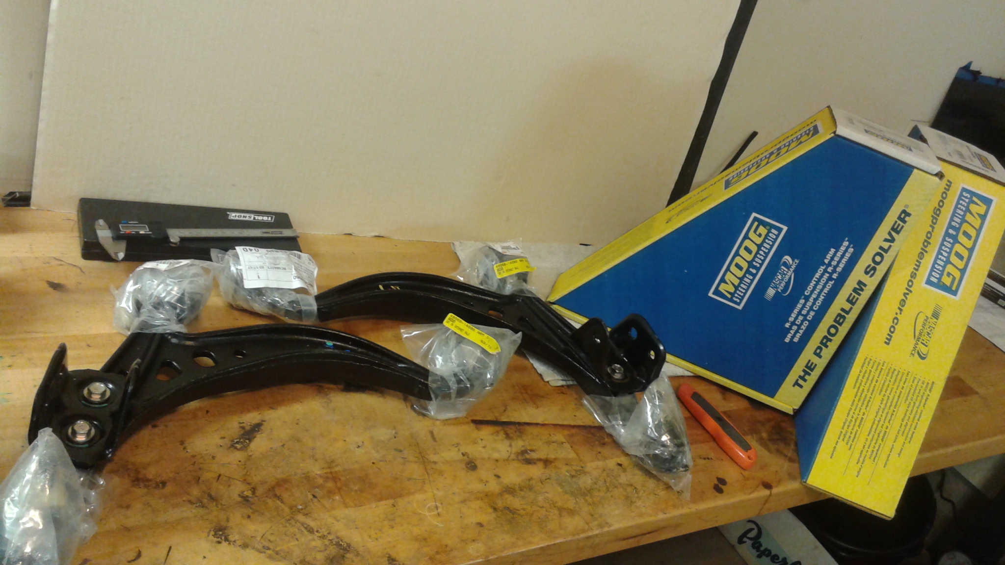

Gotta love unplanned expenses. New OEM Supra front lower control arms. And new Moog front upper control arms. Should help it ride better and let me get the front aligned better now.
