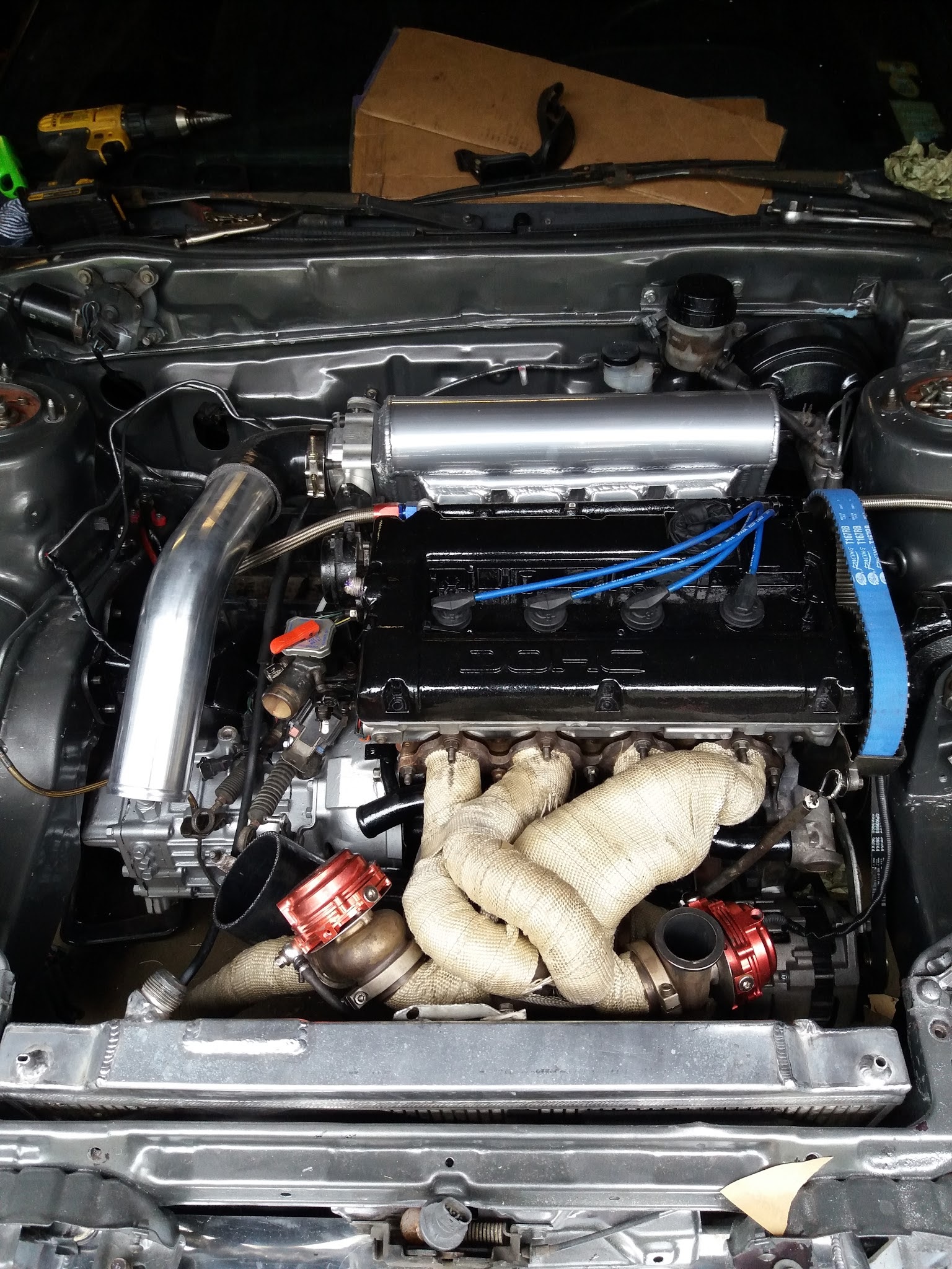

Anybody have a 1G DSM 91 preferably that i could install my ECU in to inspect my injector driver circuit to be functional and or if the ground commands are functioning within my Ecu please?
Ive tested every single component known to the community from mpi relay, to resister box ohm checks to cas trigger circuits ect. I have fuel at the rail and i have spark all confirmed. I have voltage at the injectors, and i have continuity on every single injector wire going back to the ecu...however my ECU cel light cycles as normal link can communicate, i can make adjustments without problem but the car will not start ...all plugs continue to stay bone dry! Spray a bit of brake cleaner and it fires right off...injectors do click if bench tested as well
