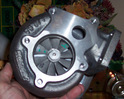

If you have the 5 bolt housing, check here:
http://www.diamondstarmotorsport.com/diyparts.shtml
Old 03-09-2005   #8
TrboVan
Join Date: Mar 2004
Location: In Front Of You!
Posts: 24
Send a message via AIM to TrboVan
Re: Wastegate help
Thanks Jet!
Yes, here is the turbo.

Please remember I know nothing about external gates.
Does it matter where the external gate is installed?
Can I install it in the intercooler plumbing, or does it need to be near the exhaust header?
