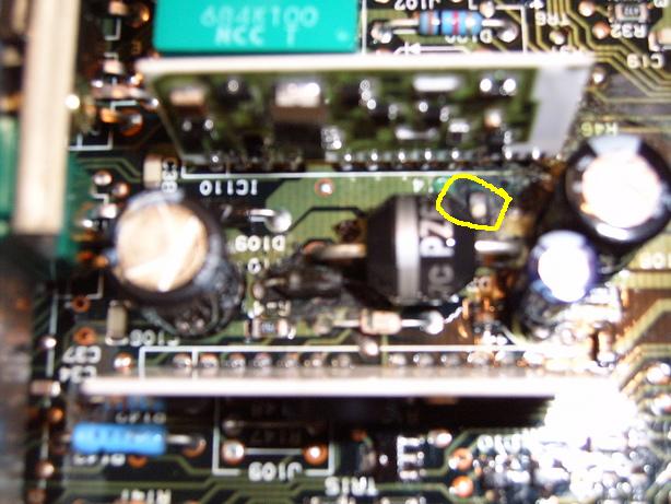

I just aquired a 91 Eclipse GSX. The car hardley runs. It idle surges between 100-2000RPM's. When driving the stock boost gauge shows full boost at anything over about 20% throttle., causing the car to run extreamly rich and load up. I did a compression test and it has 125-140 in all 4. Next I checked the ECU for leaking caps.
Well, they're leaking, my question is; Have they leaked for too long? The board is blackened around the caps. I already ordered the caps to replace them, but I'm worried the board might be shot. I tried getting a couple pics, sorry for the lack of quality. My $150 cammera shows its shortcomings on the closeups.

best thing to do about your ecu is replace your caps and carefully clean your board where the effective area is at. there you can tell what condition your board is in.

Make sure you clean up the board good and remove the coating in areas you will be soldering/desoldering with acetone.Looks like the surface mount cap (circled in pic) is trashed as well, you can replace it with a non surface mount 0.1 uF ceramic cap.Make sure you clean the board again when you're finished soldering, flux(from the solder) is corrosive.
