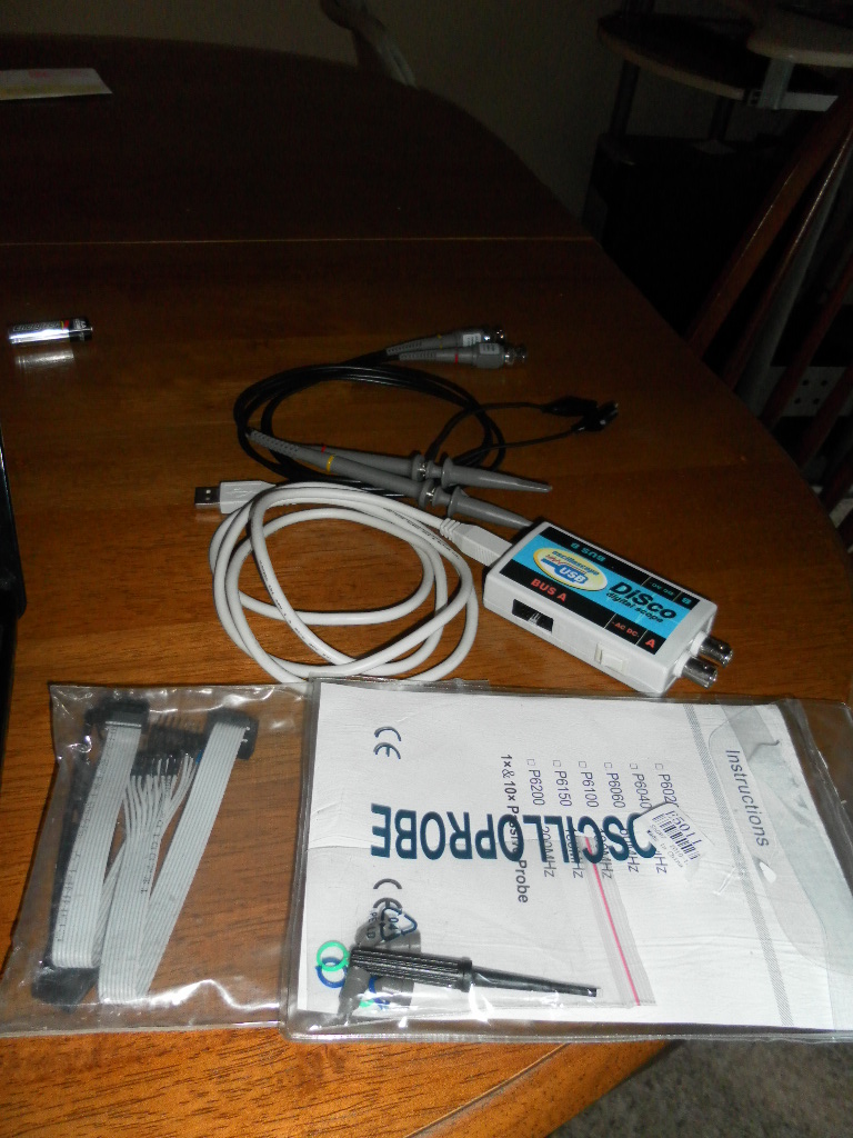

Got the new O'Scope in the mail Funny because I'm pretty much to the point where I don't think I'll need it now. But whatever, it's a good little tool to have!

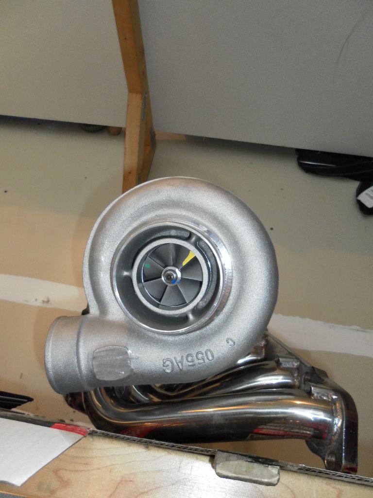

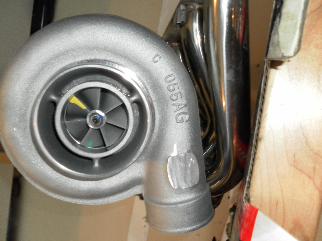

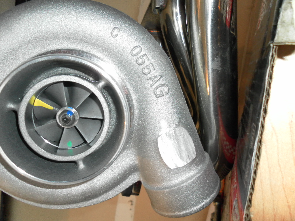

Also, it looks like DB's dyno schedule is a bit busy, so I may opt to not get it tuned before doing the turbo, since it does seem to be running fairly well overall as-is. Bolted the turbo up to the mani today just to see if there is any clearance issues with the compressor housing hitting the manifold. It clears like this, so this is prolly how it will end up being aimed. I also put one picture showing it clocked to the point that it hits the #1 runner.

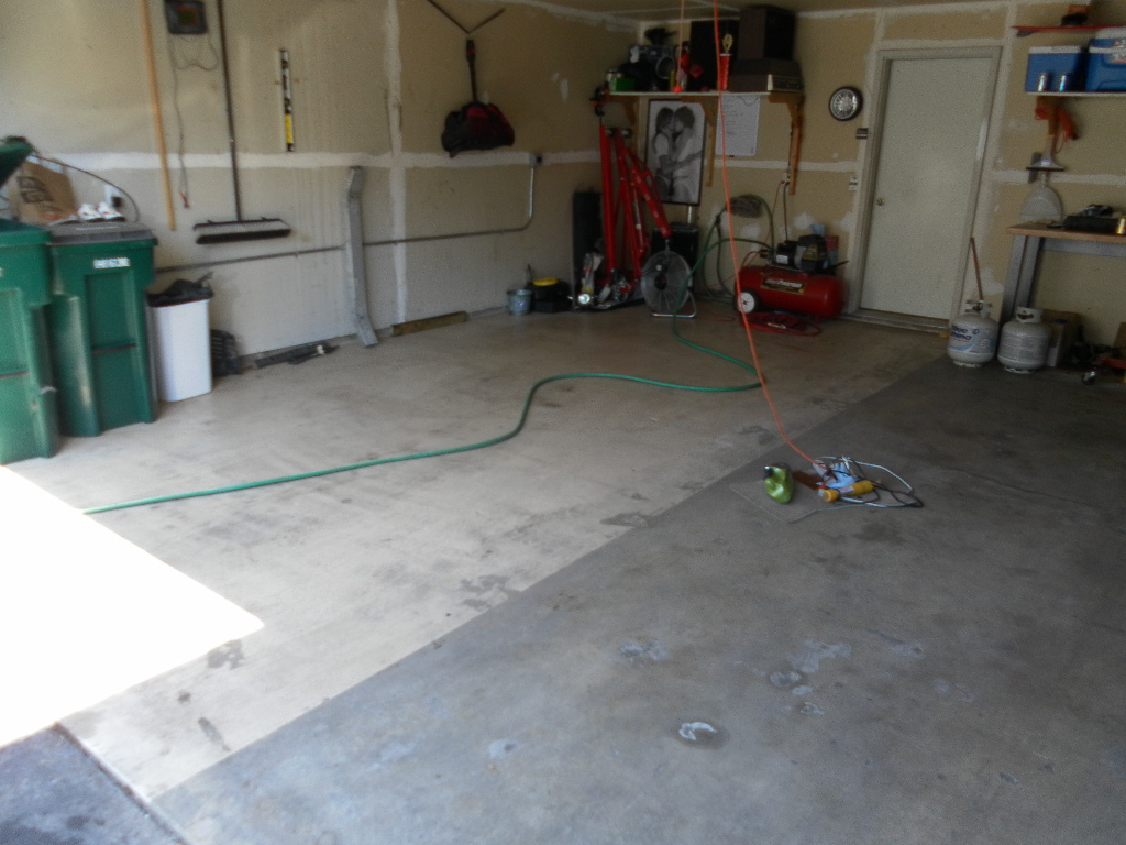

I parked her in the driveway. Cleaned out the garage where she'll be parked for the next couple months. Jacked her up and gave her a good underbody cleaning/degreasing before starting work.
Parked and up on jack stands

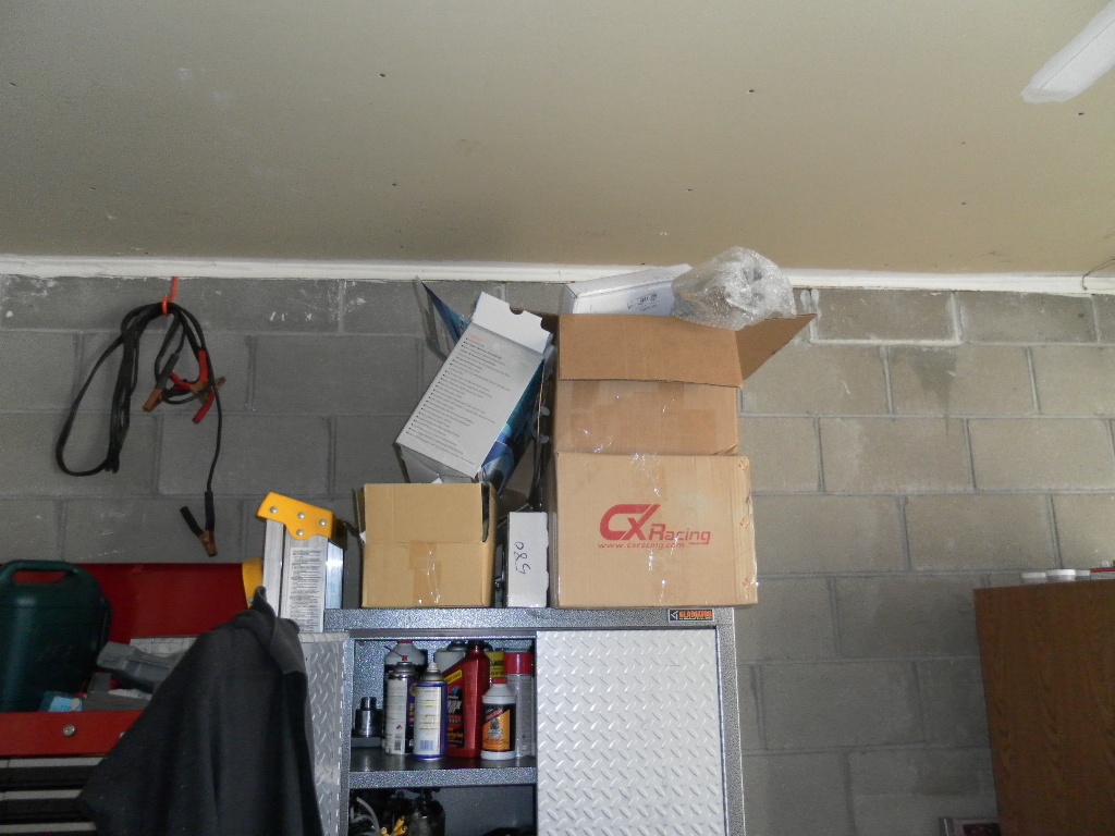

The parts stash that I've been slowly accumulating over the past few months. Finally get to put them to use
