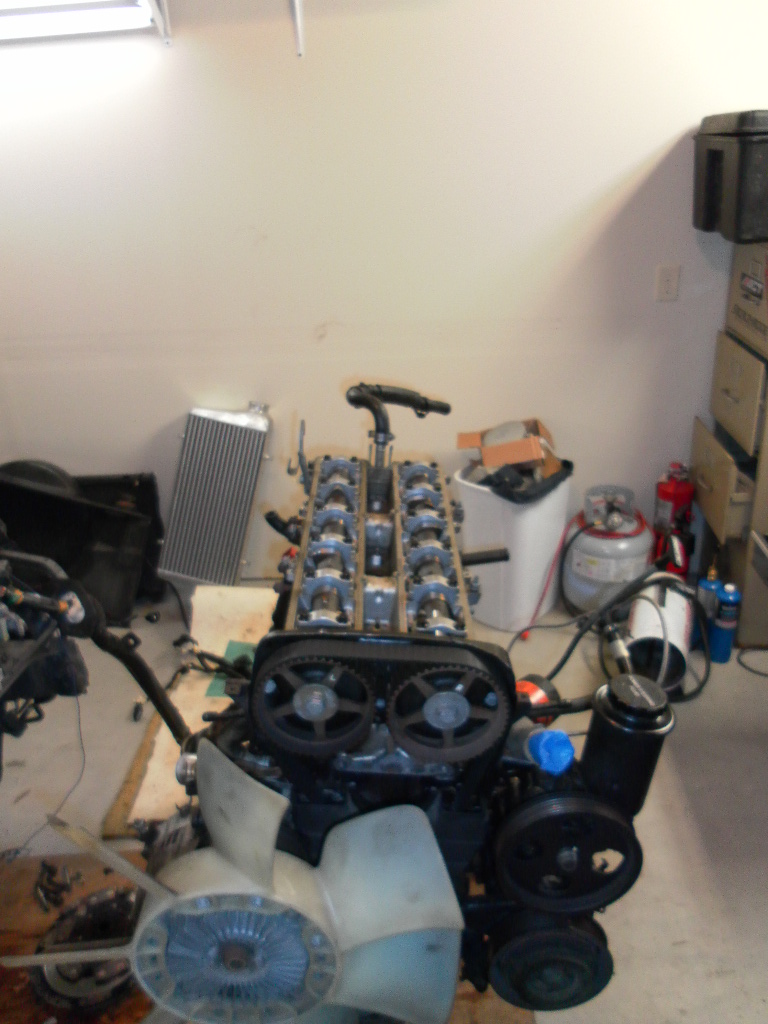

Went and worked on the motor for a couple hours today. It's taking me awhile since I'm new to this thing. The wire harness is a god aweful mess, but I got it all disconnected and out of the way. Intake and exhaust manifolds are off. Fuel rail off. Valve covers off. Serpentine belt off.
So at this point, I guess I need to figure out how the timing belt works and what all it takes to get that thing off. Seems like I'll have to remove a bunch of shit to get the cover off. Then take the cams out, head bolts off, and that should be it I think.
Once the head is off I plan on calling up Northern Cylinder Head in Andover to see if they'll go ahead and clean it up, put new valve seals, valve springs, and cams in for me (and shim). Nice little tin shed po-dunk feeling shop that's done a lot of head work for me on my DSM in the past!
So that's it for now. here's a couple pics.

Are you going to need to take off your damper? That thing is a completr beoch and is tq'd to 239ft lbs.

Looks good! If you ever want any help let me know since I'm close! Plus I have access to alldata at work and have just about every tool you'd need if you ever need to borrow anything.

Electric fan/s in your future?

I guess I'm assuming I'll have to take the dampener off, but no idea yet.
Thanks for the offer on helping. I'll let ya know if I ever do. I'm kind of a do it myselfer though, just go out there an hour here and an hour there.
Electric fan sure would be nice. The stocker is a monster that I'd love to ditch. However I think I'm going to leave it on for now, and it must work pretty well because I never come close to overheating

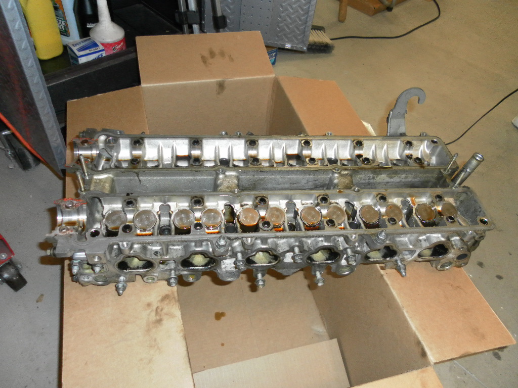

Got the head off. I have it all boxed up along with the new BC springs, and new stem seals. Just waiting for the new cams to arrive and then will be delivering it to the shop to get worked.
Engine looks pretty good. Going to try and clean some of the crud off the tops of the pistons. Cleaned of the middle two with a little brake cleaner and paper towel. Will move onto the other 4 another day.

Got the head off. I have it all boxed up along with the new BC springs, and new stem seals. Just waiting for the new cams to arrive and then will be delivering it to the shop to get worked..
I thought you were a do it yourselfer? Or are you having them do a valve job?

Having them clean it up. Check to see if anything looks old/worn such as guides and what not. If everything looks good, they will be installing new valve stem seals, the new BC springs, and I will have them shim for the new cams.
I've never done much internal head work (valves, seals, springs), and I don't have the tools for it. So I source that kinda stuff out.

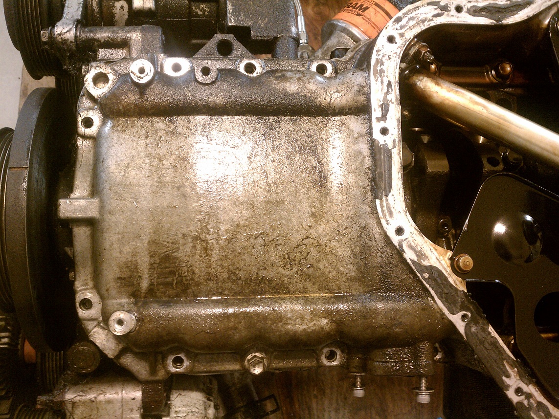

Think I found my mysterious oil leak. Shouldn't there be more than 1 bolt holding the upper oil pan on?

1 out of 4 isn't bad, looks like its cracked on that front side.

Wonder how long it has been like that for?

Bolts are so over-rated in engines.
