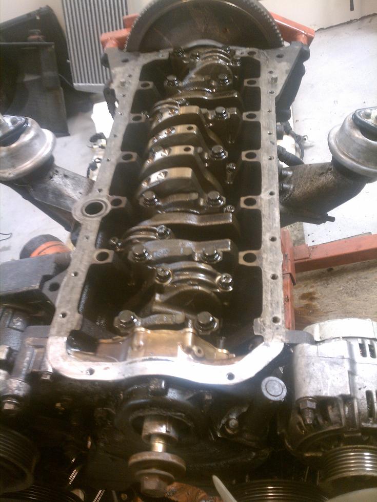

Anyhow, for now I got the upper pan off. Got the pan and block surfaces cleaned up with a razor to get the old RTV off. Need to find a -10 fitting so I can have it welded to the pan. That way I never have to worry about that leaking. So if anyone has a -10 fitting, holla!
Also got the pain in the ass crank pully off. Damn thing is cracked. So looks like I need a new one. Heard the Titan one is pretty good so might just pick up one of those.

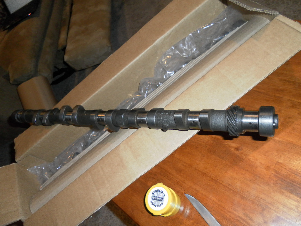

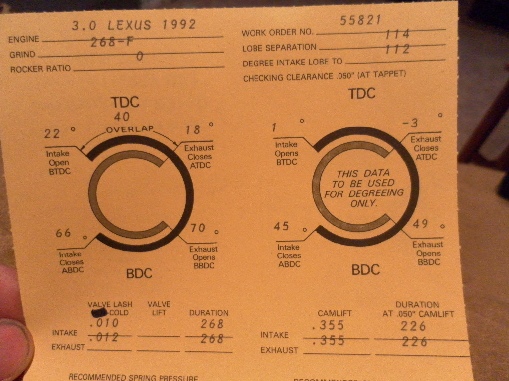

Cams showed up today. I'm definitely happy so far. Great customer service, great turnaround time, and great price!

.355 lol

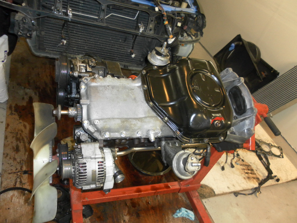

Got the upper pan back from MAP. They cleaned it up in the hot tank, and welded on a -10AN for the turbo oil return. Thanks for the quick turnaround guys!
Installed the upper oil pan with some RTV. Ace had perfect replacement bolts for my mysterious missing ones! Upper pan bolts all torqued to 6.5ft-lbs. Also got the lower pan on as well. Nice to be doing some reassembly rather than disassembly

Mo mentioned this in the shoutbox (posting in the forum is forbidden where he comes from) but did you remember to install the oil pickup tube? It's not on in those pics!
Now that was funny.

OMG!!!!
C'mon meow, gimme a little credit
