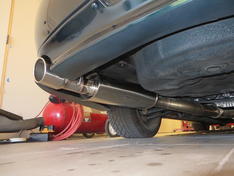

Just got the car back from DB. They buttoned up the rest of the exhaust. I was going for a subtle clean look, and as quiet as possible. They nailed it! So it's basically a 3" turbo back w/ a Vibrant Ultra Quiet resonator in the middle, and a Vibrant Oval Muffler in the rear, with a 4" rounded edge/angle cut tip. The sound is louder than stock but still very quiet. On the highway with the windows down I don't even hear it. Thanks again guys!

2jz.. lawds.. sounds good looks nice too.

Sounds nice and quiet enough to not wake the kiddos!

It's perfect, seriously.

Looks great. I need to come see this some time.

Good fitment and sounds great; excellent choice.

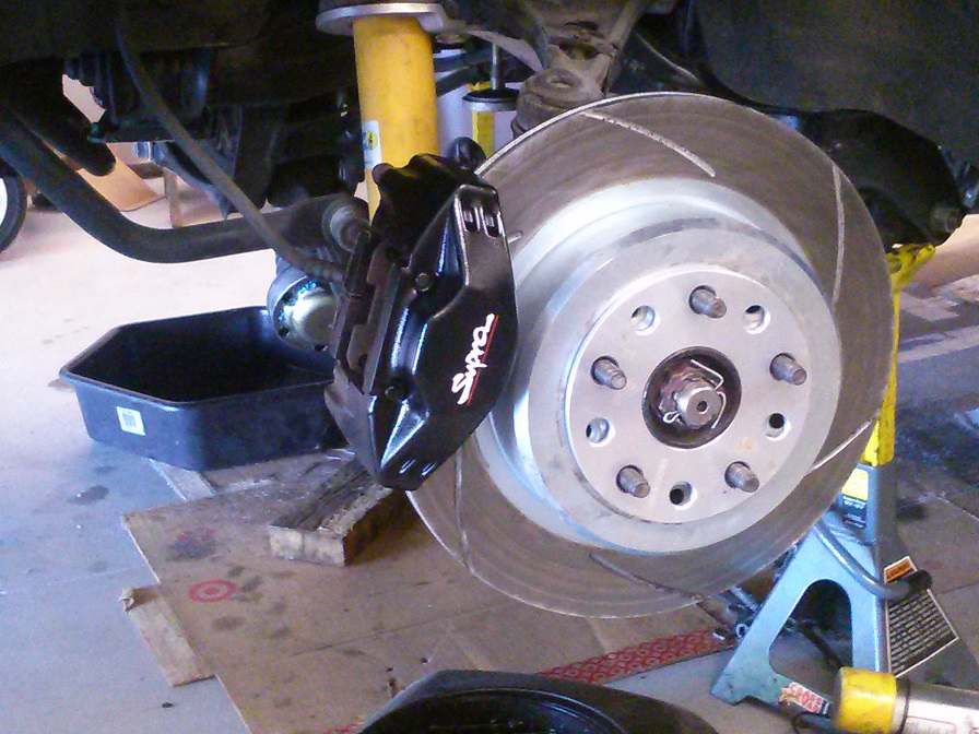

So in the mean time while I'm waiting for the new diff, decided to work on the rear brakes. The 16" FD rims I picked up as my poor mans drag setup didn't clear the calipers by a nut hair. So I ground a couple spots down on the calipers ever so slightly. Then primed and painted them to match the fronts I did a couple years ago. Here's how the sit now drying. Then they'll get the Supra stickers and some coats of clear, and then back on the car!

Looking good!

Stickers on and 5 coats of clear. All done, just gunna let em dry and throw em on in the next couple days when I have some time

Rear Calipers back on.
