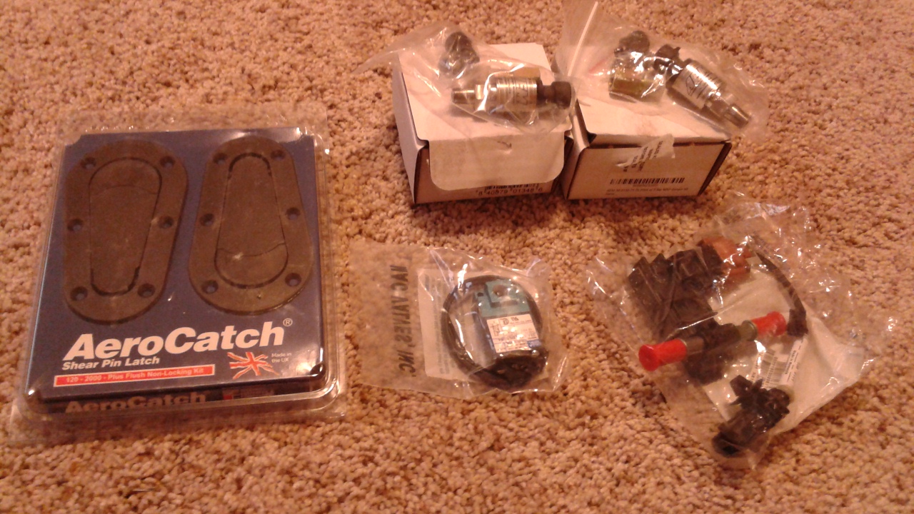

So the AEM will be a few weeks yet since he has to make a special harness for me. In the mean time, I've picked up some stuff. Got some of those Aero hood pins for the new hood. Also got all my sensors I'll need. AEM SS 5 bar MAP sensor, AEM SS 100psi fuel pressure, GM Flex Fuel, & a MAC 3-port boost solenoid. Good news was I had enough points on my credit card that I got all those sensors, plus a new Ryobi ONE cordless setup for free!
I also have some new ABS sensors on the way that I'll need for setting up traction control.
I also got my new Tilton Clutch Master Cylinder half installed. Hopefully I can get it further installed over the next week or so and figure out if that fixed my tranny issue. If not, then yaay that pig gets to come out. Crossing my fingers that doesn't have to happen.

Glad to see you got some genuine Aerocatch vs the ebay/cheap stuff.
I love my aerocatch hood pins.
Old 03-11-2016   #5
Re: Project Lex
Cm on man, I'd never buy cheap ebay knock off stuff... :P

lol, well they are $12 so it's pretty tempting vs the $80+ or whatever they are now.
I haven't installed mine yet, cutting into a CF hood is scary!
Old 03-12-2016   #8
Re: Project Lex
I think I paid 70. And oh yyeah I was tempted, but just went with the real deal.

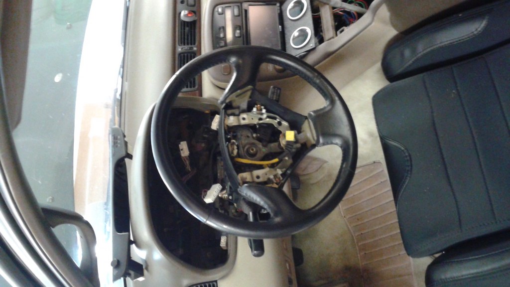

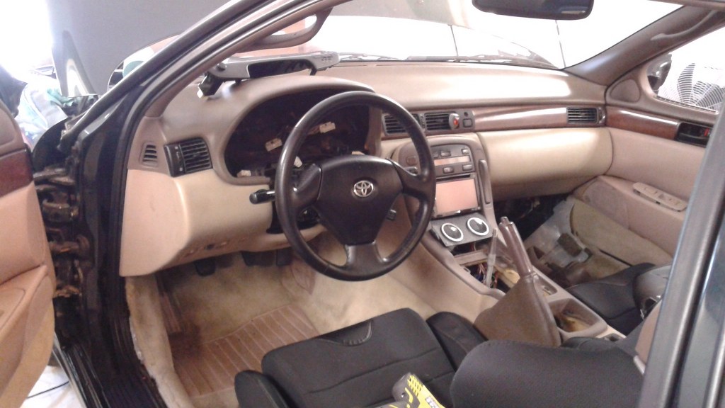

Well while I'm waiting on my new slave to arrive, I decided to do a couple things.
A took out my gauge cluster and sent to Tanin Auto Electornix to get the bulb changed over to LED and to fix all my burnt out needles.
I also took the opportunity to swap in my new steering wheel I picked up. First time ever removing / installing a steering wheel, wasn't too bad, took me maybe 15 minutes. Really digging the new one! It's out of a Lexus GS300, but from JDM land so it would have been a Toyota something or another (Aristo maybe?), sorry I'm not caught up on my JDM models, haha.

More modern, nice! It looks a bit smaller diameter, any issues seeing the edges of the gauges after that? Smaller wheels are nice.
Assuming those are cruise controls on the wheel, hopefully you were able to keep that functionality (plus the airbag maybe)?
Old 03-21-2016   #13
Re: Project Lex
It's actually damn near identical in size. I put it on top of the old one and it was pretty much the same size. And the gauges are gone so no idea, lol. But yeah same size so shouldn't be an issue!
The air bag I removed, it's just a hollow cover at this point (puts on flame suit).
The cruise switches don't work since I removed cruise from the car. But I left them on there just in case I need a switch on the steering wheel for something, I could use it. Say to enable rolling anti-lag or something like that.
