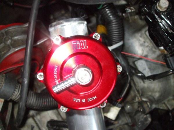

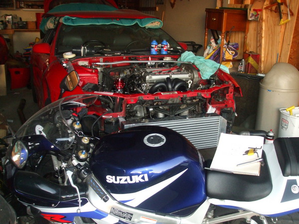

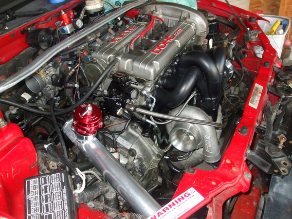

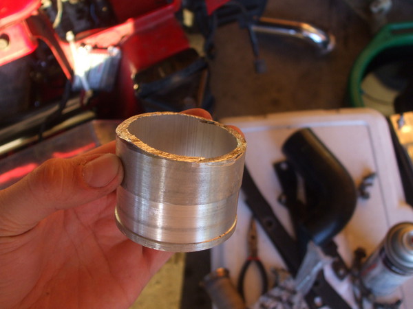

some pictures

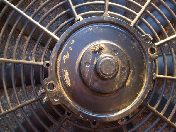

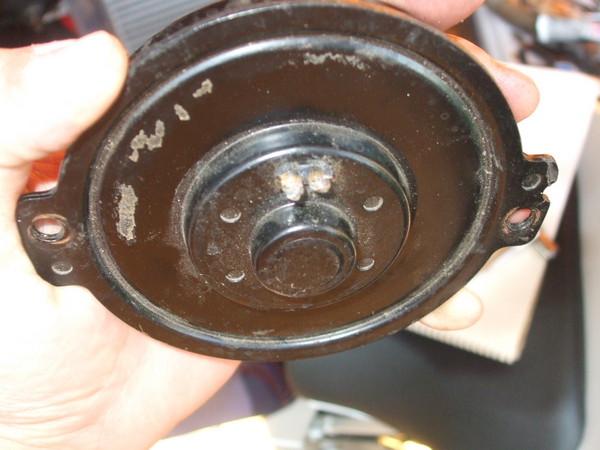

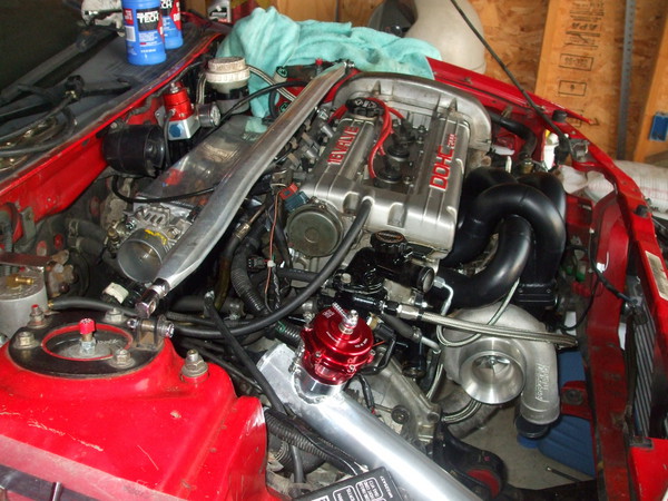

Some more pictures

I'll Go take some quick and get back to you. Also, I'm not the only one that had problems with this kit. Nick (cornfed2.4) has the same kit as me and had trouble with it.
Yea. you are better off customizing the piping to fit exactly to your setup with clearing things like DP, radiator and or fans, turbo, intake, ect. Looking good. whens it going to be on the road.

^ first things start up. Then I will button things up and make them look better, I could have this thing on the road next week. BUT, I need to get at least 2 to 3 more things befoe tuning it. BAP,A1's, and make my exhaust. I am going to use the downpipe that I have on there and then cut the one that I had on there before and weld it to fit the downpipe.. I like everything about thermal exhaust better then the one that I was going to use.
