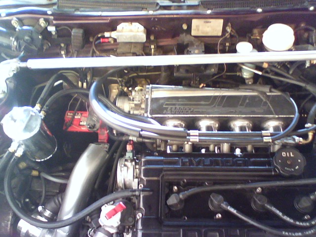

I don't have a camera right now, so here's just a crappy cell phone picture of what I've been up to today. I got the stock IM off, and put in the JMF one. Good thing I have skinney arms, because it was tricky getting that stocker off with the head still on the car.
I also put the new shaft seals in the NT TB. Those seals were a frigging TIGHT fit. But it seems to work fine so far. We'll see for sure once I can boost leak test the system. I also reinstalled the FIAV/ISC stuff back onto the TB to hopefully help with my idle slightly. I blocked off the FIAV portion of it though.
Now really just need to rework the UICP and I should be good to go.
The pic shows the new manifold in. Also shows the JMF catch can installed, with the nice braided vacuum hose. I'm heading out right now to cut the line from the Can to the SMIM, and install one of my $2 check valves.
