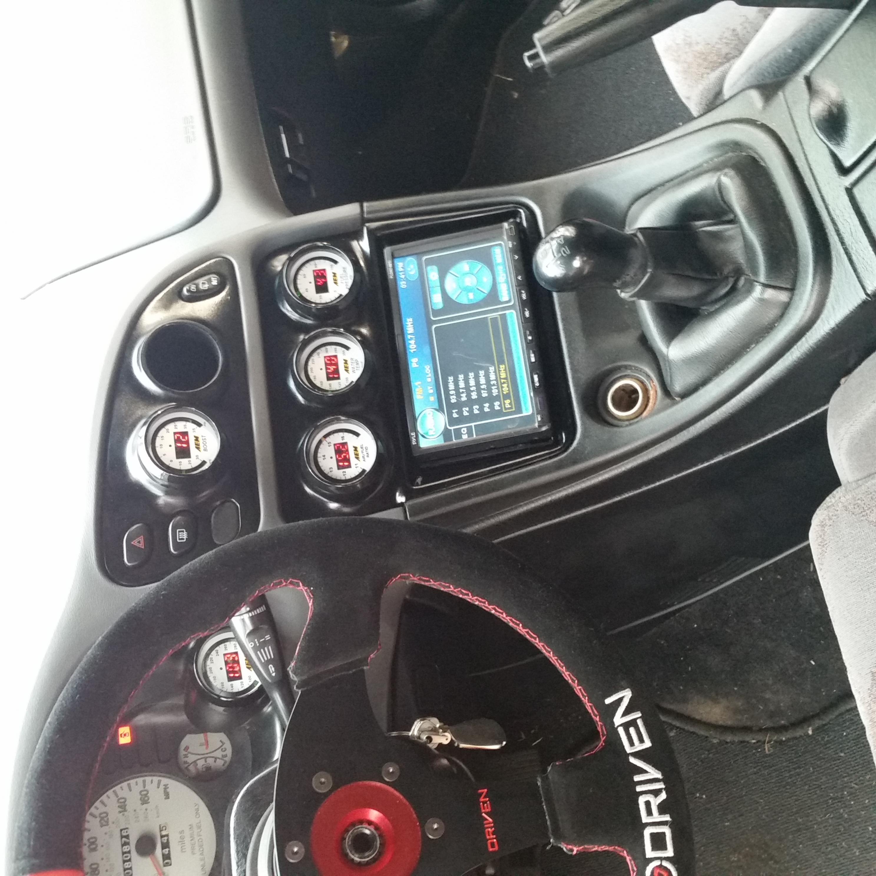

Decided to just keep the pod. Went ahead and wired up all the gauges. I still need to make the final decision on either getting a Trans temp gauge, oil pressure gauge for turbo pressure, or if I should located the battery cut off in the remaining hole.
I don't like having the A/F gauge below the boost gauge. So I'll be moving it up into the open hole probably later this week.

Looks really good, just need that black dash now.

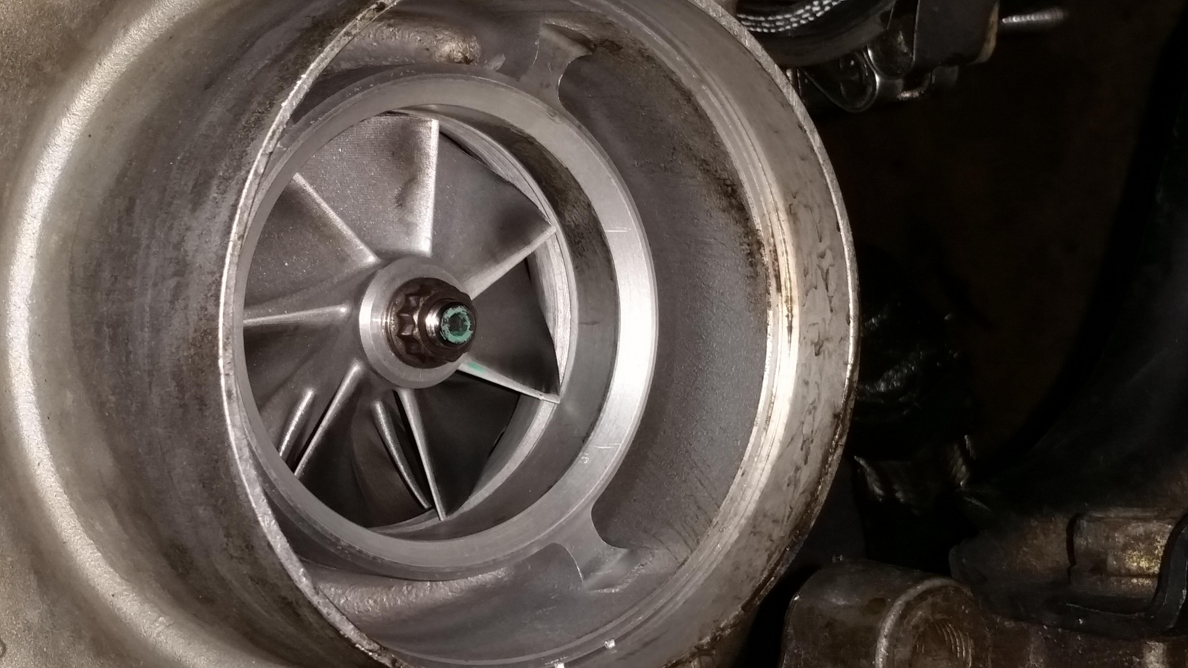

Well turbo spins. But has a lot of up and down and side to side play.
Looks like it started to rub on the compressor cover.
You can see scrap marks on the bottom on the inlet in the picture

Yeah that doesn't look good. I assume the oil feed is off the filter housing? 4000 miles is low for a turbo even at 24psi.

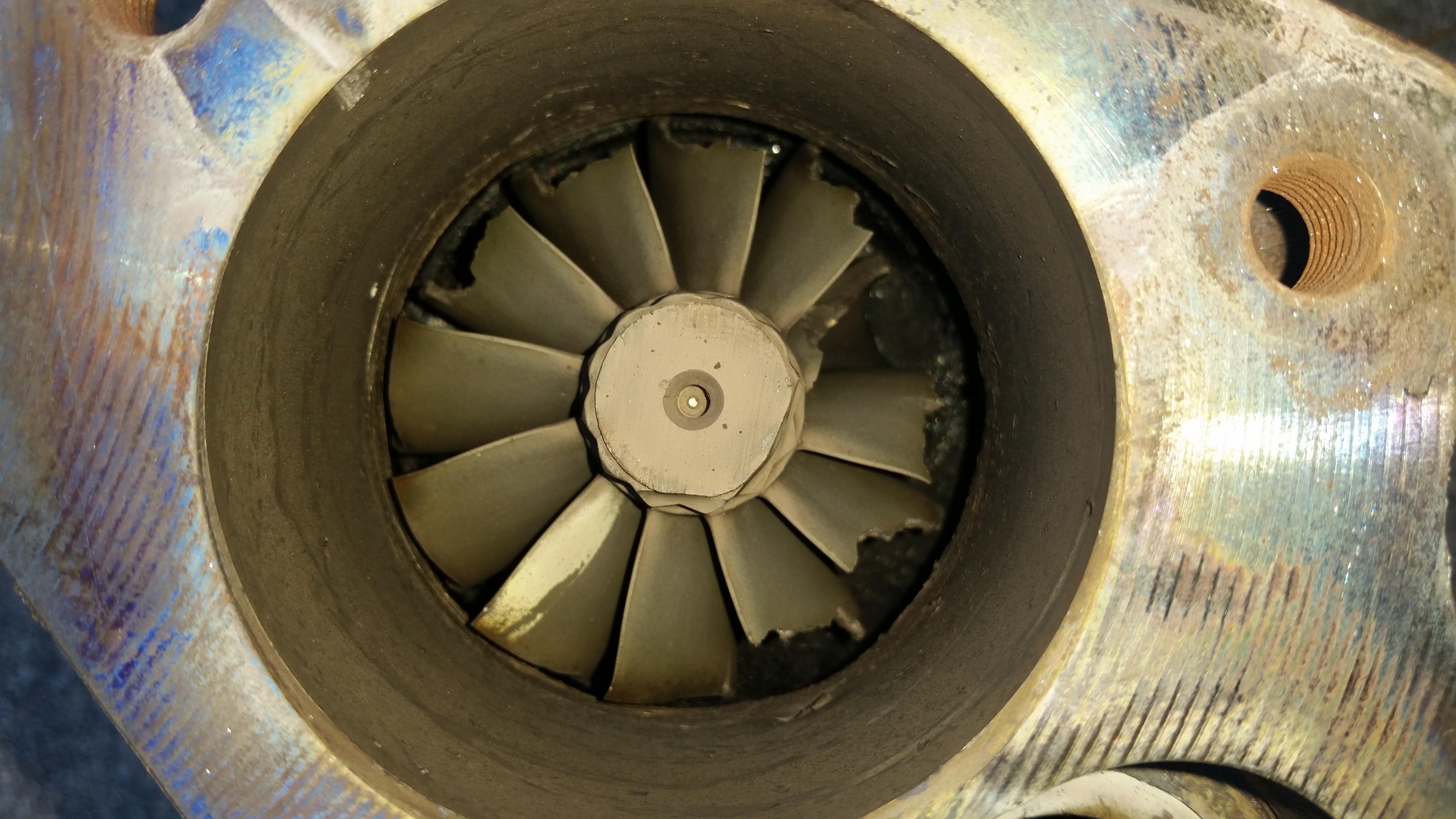

Yep turbo is trashed.
But what I don't get is. It almost looks like something came through the exhaust side. There is no up down, side to side play on the exhaust side. But several of the fins are missing. Any thoughts of what would have caused this?

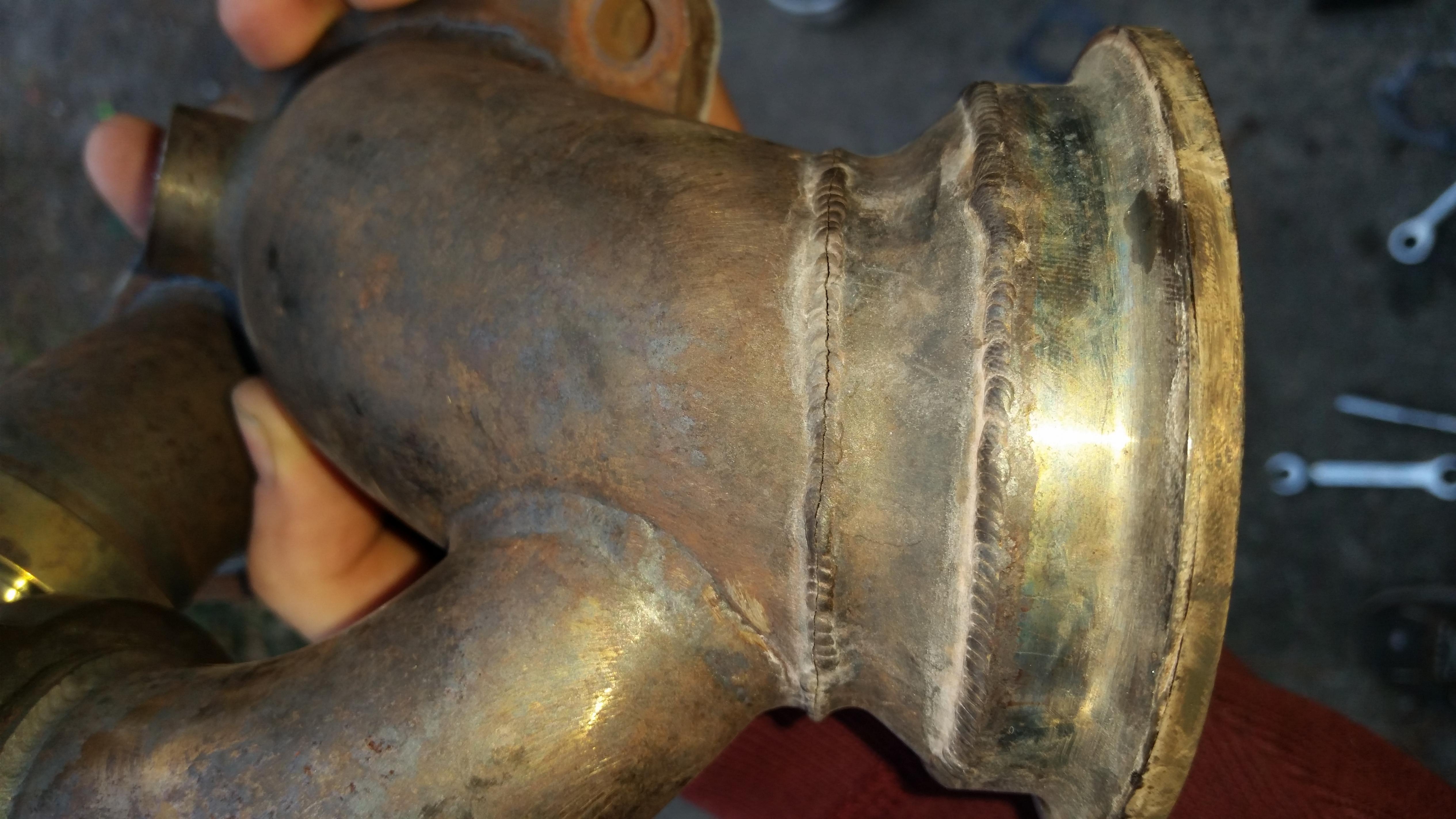

Also found my O2 housing is cracked.

That doesnt look good at all, not sure what would have done that unless something went through it. At least it wasnt the compressor side that blew apart.
