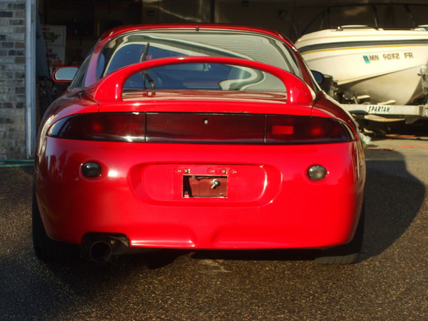

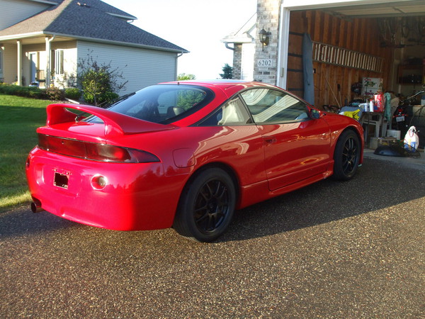

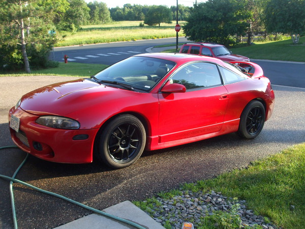

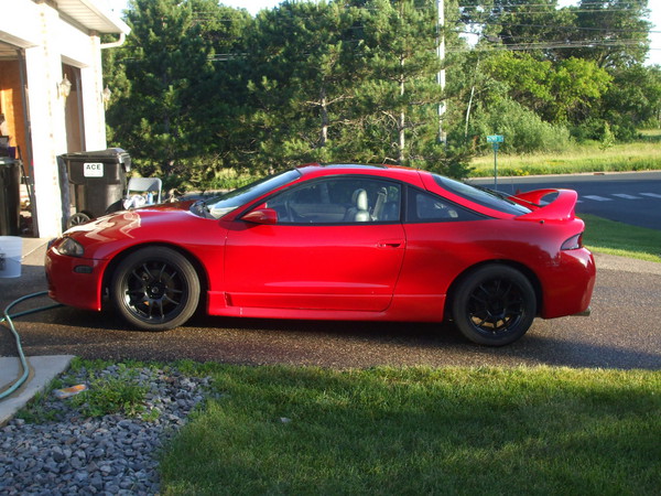

Re: GsXtUrBo98's 2G project thread
Car looks sick man!
Car looked super clean and really made me miss my dsm! Glad I could be of some help. Hope you hit your goals with it!
Lookin sexay.

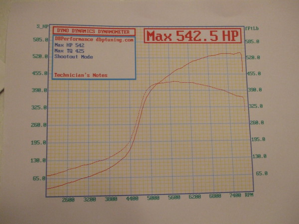

OK so, I brought my car to Shane today and we gave it our best. I am running into ignition issues about 27psi so we had to stop at that mark... With the ignition issues being fixed he said I would have no problem getting over 500awhp on his dyno.
He also recommended running speed density with a AEM 5 bar. My GM MAF is all over the place. My main problem with the spark is that I'm not getting enough volts from my alternator to my battery. But I'm also throwing a alternator CEL. Any how here's the graphs.
Nice job man! I know nate was having problems with his alternator when he was tuned before Proving Grounds....he replaced it and found that he had been running ~11.8v before and now a full 14v....his AFRs were way rich (fuel pump pumping more) to the point that he was having ignition breakup. I guess what I'm saying is, check your grounds, check your alternator, and enjoy the car!
That isn't a DSM power curve man I swear, power just goes up up up!
