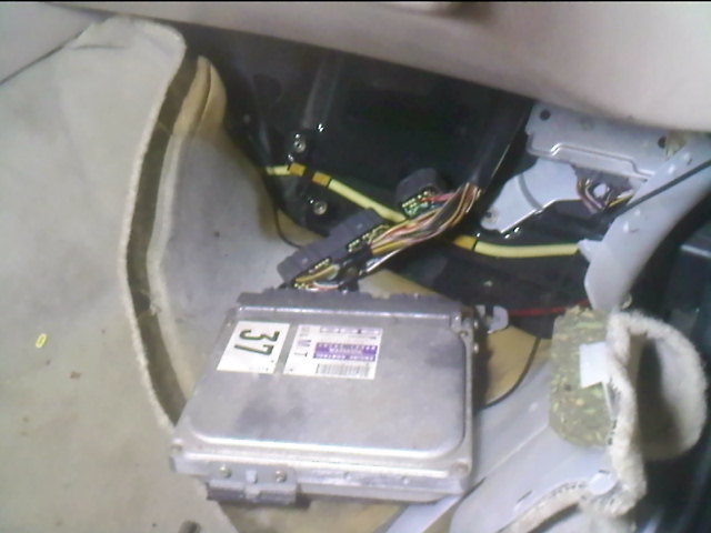

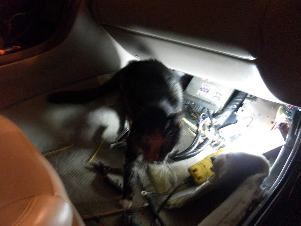

The ECU is located on the floorboard/firewall under the passenger side carpet. My helper and I (my 20+ y/o cat Freckles) got it removed. Going to go grab some solder and heat shrink, and will then start tapping into some of these wires.

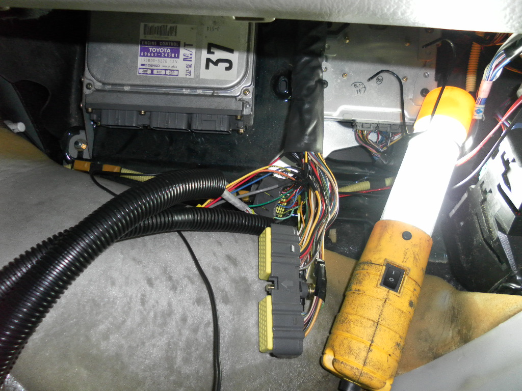

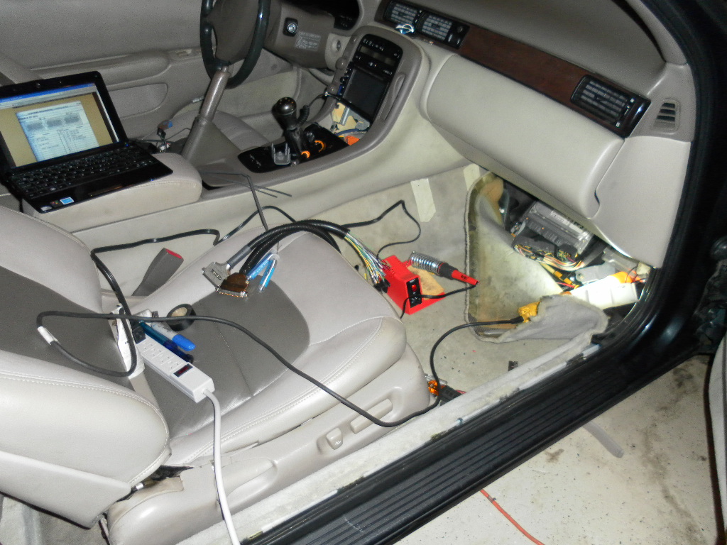

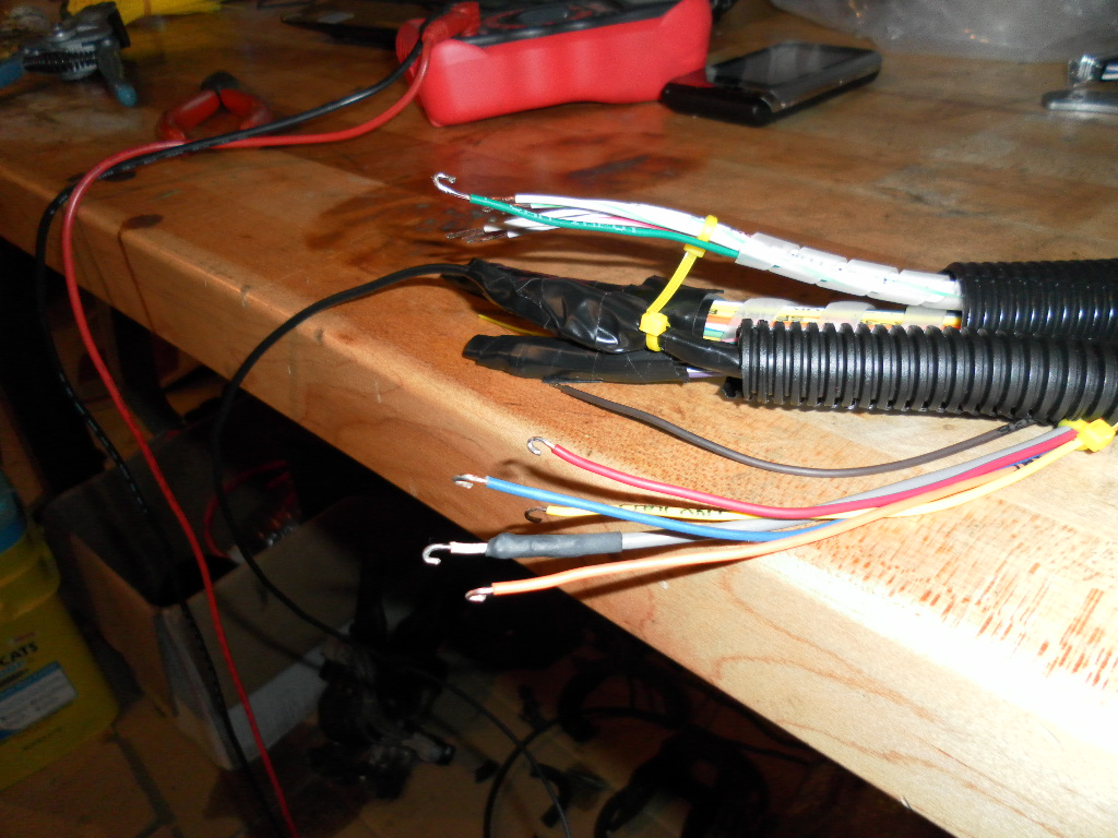

Phase 1 of the MS3 install is done. All I did was install all the wires that were "tapped" into the existing wires (meaning I didn't do any of the wires that required me to cut them). This was simply so the car would still start and be running completely on the stock ECU, but the MS3 should turn on, and I should be able to play in the software. Here's some pics:
Work area setup
Wires tinned
Soldered, heatshrinked/elec taped
Quality Inspection performed by Freckles

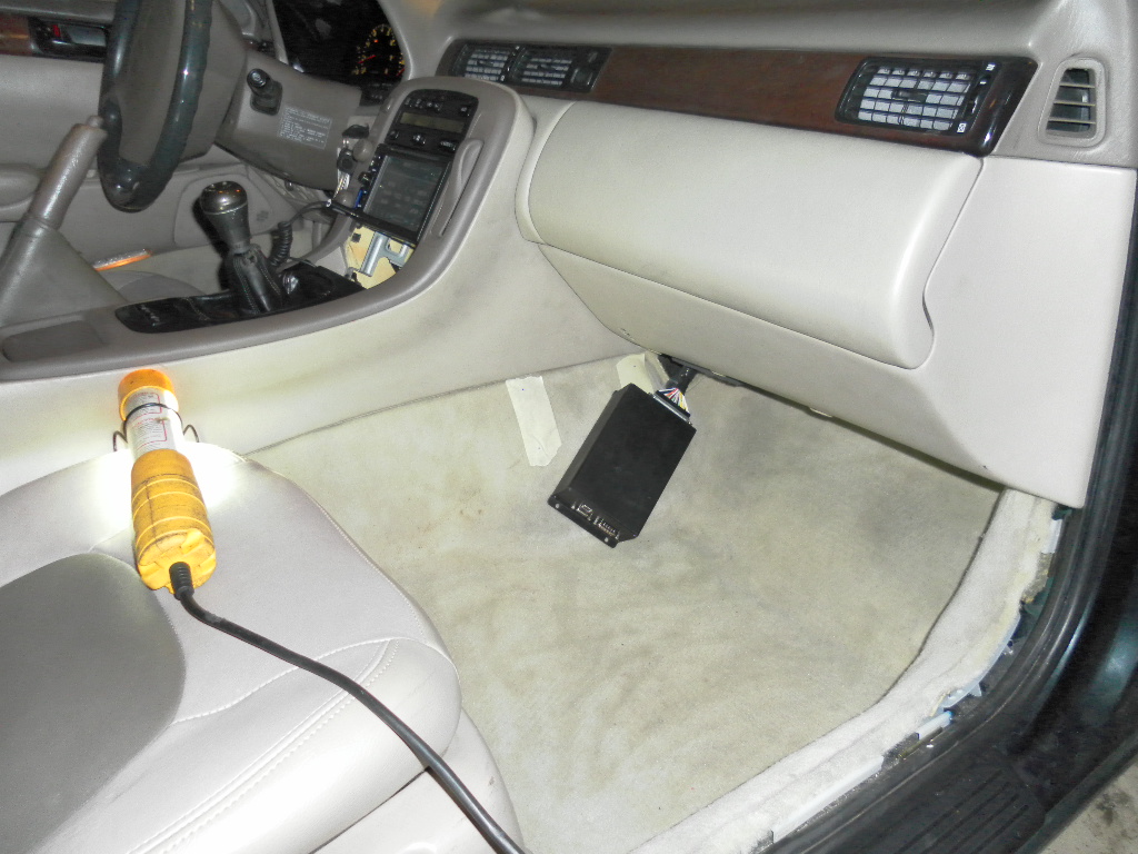

Dangling for the time being. This is where it'll be mounted however. Not completely hidden, but out of the way for the most part, and easily accessible if need be which was my goal. You can see the strips of masking tape with little dots on them. That is where it will be once it's installed permanently:
And last but not least, a little startup vid. Like I mentioned before. I'm trying to go 1 by 1 with the car here. So since everything I hooked up so far was non-intrusive so to speak, all I'm doing here is making sure that I didn't mess anything up while I was down there, and that the car starts up with no problems and there's no magic smoke coming out from anywhere

Been working with Jordan (2JZ Megasquirt Guru) recently. With phase 1 of the install done, we got my laptop communicating to the MS via TunerStudio. Got some baseline settings put in for logging. So far everything is working, except having a hard time keeping sync with the cam signal below 1600rpm. Once I get that worked out, I will be wiring in the fuel and ignition control (as right now it's hooked up as purely a logging instrument). Once I get that done and a baseline tune running, will be setting up an appointment at DBPerformance for a complete baseline tune on the stock setup.

Woohoo, got the sync issue worked out. There were a couple jumpers & pots that needed to be changed / adjusted on the MS3 and MS3x boards. Everything is logging perfectly now
