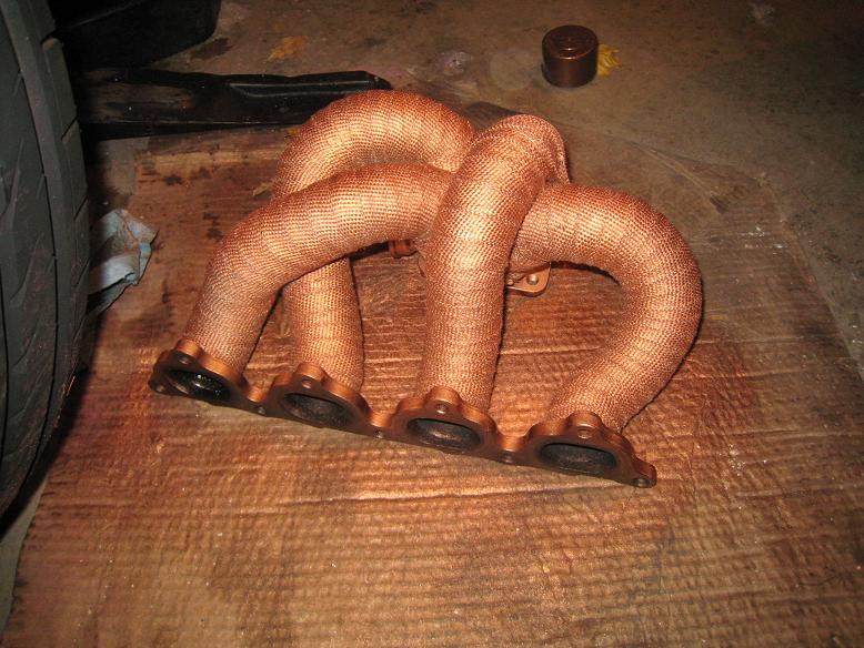

Also got my package from Summit today. I ordered some manifold heat wrap and sealing spray, and also a turbo blanket. I got the turbo blanket put on, and plan on starting to wrap the manifold tomorrow.
Old 12-11-2008   #293
Re: My Winter Upgrades
Just a word of warning, but it seems like tubular manifolds like to crack when they're wrapped. I'm not saying your's will, but I've heard of it happening.
Old 12-11-2008   #294
I have heard the same quite a bit, but with your overheating issues, it might be worth it. I grabbed the valve spring compessor today and *might* get your head done tomorrow.
Old 12-11-2008   #295
I'm fully aware of the possible cracking issues, but am doing whatever I can to combat my overheating. The manifold is already coated in and out. Also with the wrap, I got the coating that you spray over the wrap to seal it and not allow any water in, so that should help as well.
Old 12-14-2008   #296
Got the manifold runners all wrapped, but ran out and I still need to do the collector. If anyone has some extra 1" wide wrap laying around they'd like to get rid of, please let me know.

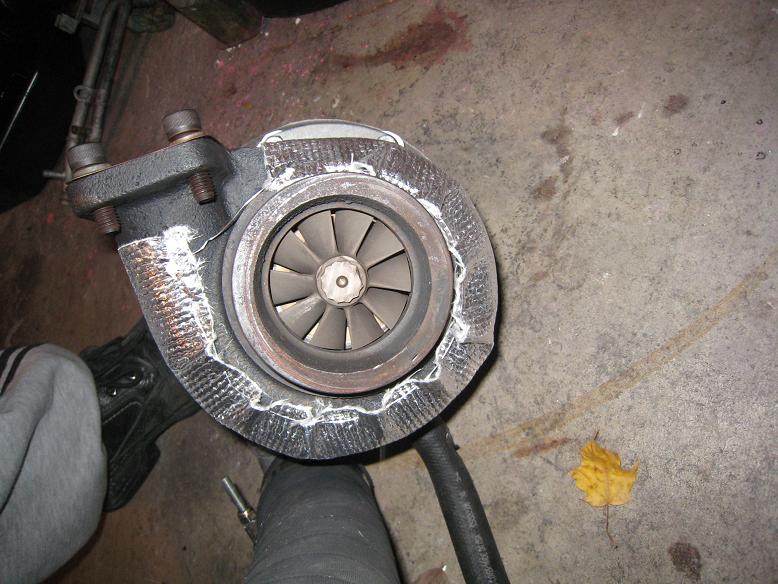

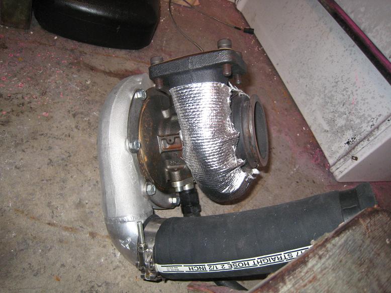

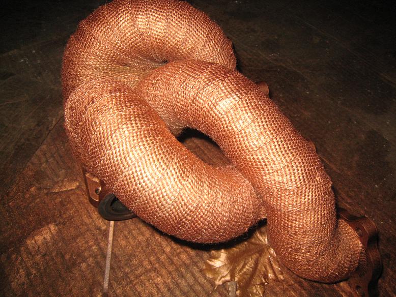

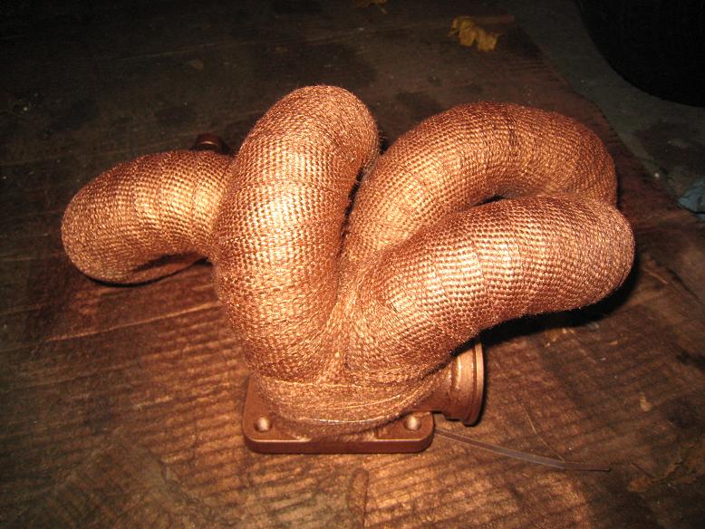

Manifold is wrapped, and I have the first coat of the sealing spray-on stuff applied. Will put the 2nd coat on tomorrow. My g/f and I spent a lot of time on the wrapping job to try and keep it as clean as possible because I've seen some thrown together jobs and it can look like crap, and I didn't want that. I'm happy with how it turned out. It's on there real nice and tight!
Also a pic of the cheap little turbo blanket I put on. I have a lot of extra of that if anyone else wants to make one for their application.

just keep a eye on the mani now that you wrapped it. One of the dnp's I had cracked because I wrapped it. swaped it out for the other one I have been using for many years and never had a problem.

thats one of the best looking wrap jobs i have seen, good work.
Old 12-17-2008   #300
Yeah I already know about increased chances of cracking. But it's a risk I'm willing to take, and the manifold is supposed to have a lifetime warrantee (who knows if those guys would honor though...). Anyway, thanks for the warnings, I'm fully aware, but I need to do everything I can to keep my engine bay cool so oh well.
311 - THanks for the compliment. We tried to take our time and do it as best we could to keep it clean looking.
