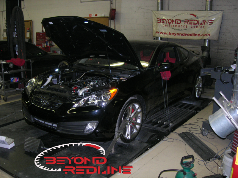

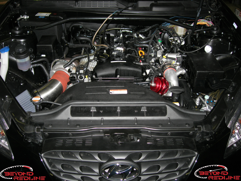

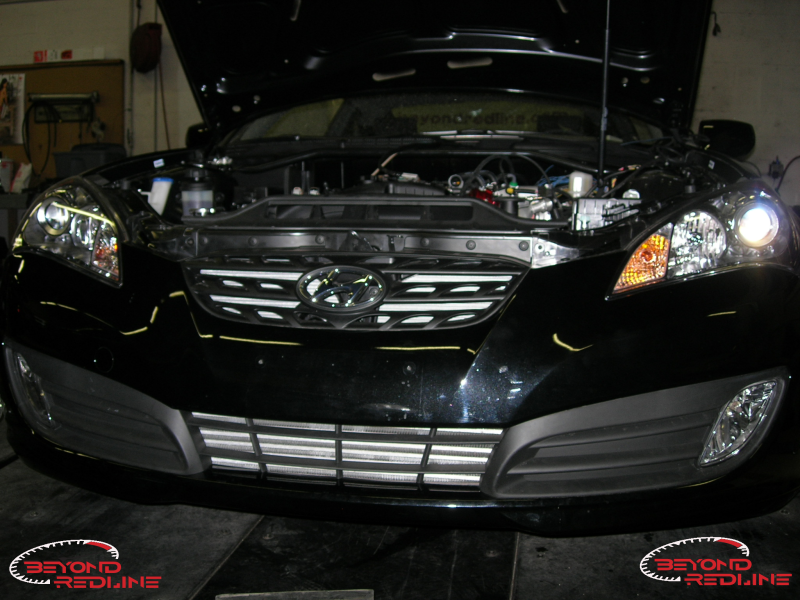

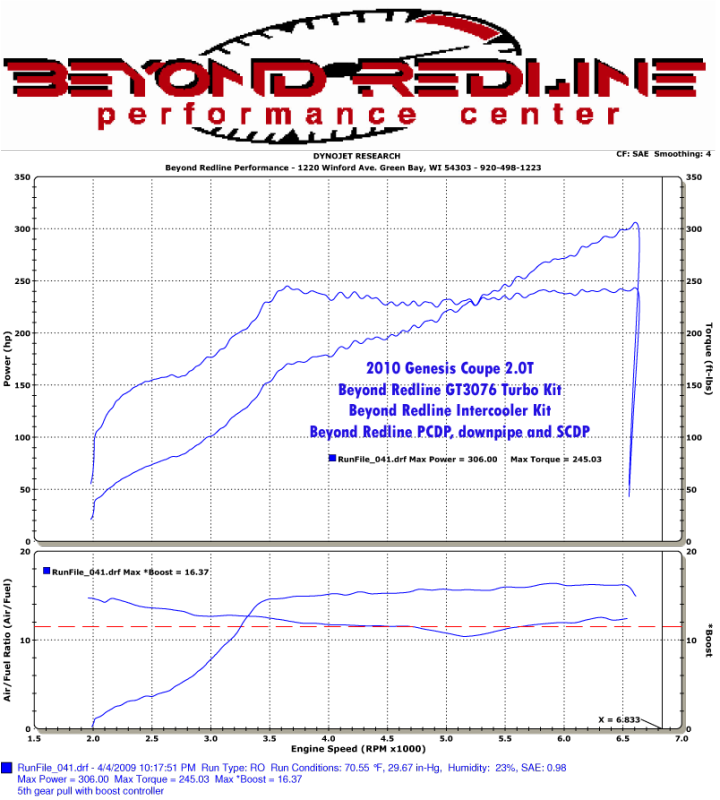

Beyond Redline just broke 300whp on their Mustang dyno. They took the stock turbo off to inspect it, and destroyed all the hardware in the process (one time use stuff maybe?). So instead of waiting around to get new hardware, they bolted up a GT3076, and a Tial 38mm wastegate with a 16psi spring.
They used their prototype FMIC kit, prototype downpipe and cat elimination pipes, and an AEM FIC with 600cc injectors. Their prototype catback was off being made into a production model so they had to use the stock catback. Anyways, here's some pics and a dyno video.
http://videos.streetfire.net/video/3...Run_644732.htm
More info on it can be found here: http://www.gencoupe.com/general-disc...s-306-whp.html
On a later tune he cleaned up the AFR a little and hit 314hp. They tried turning the boost up to 17psi, and hit 331whp and 270lbft, but the AFR went all crazy, so he stopped. That torque curve is awesome! I can't wait till they can get into the ECU and can find a way to get around the boost cut.

New dyno sheet from Beyond Redline. Also, the turbo they're using has a .82ar exhaust housing on it, so I don't think the power potential would be hindered by using a smaller housing for quite a while judging by how well it holds torque.
