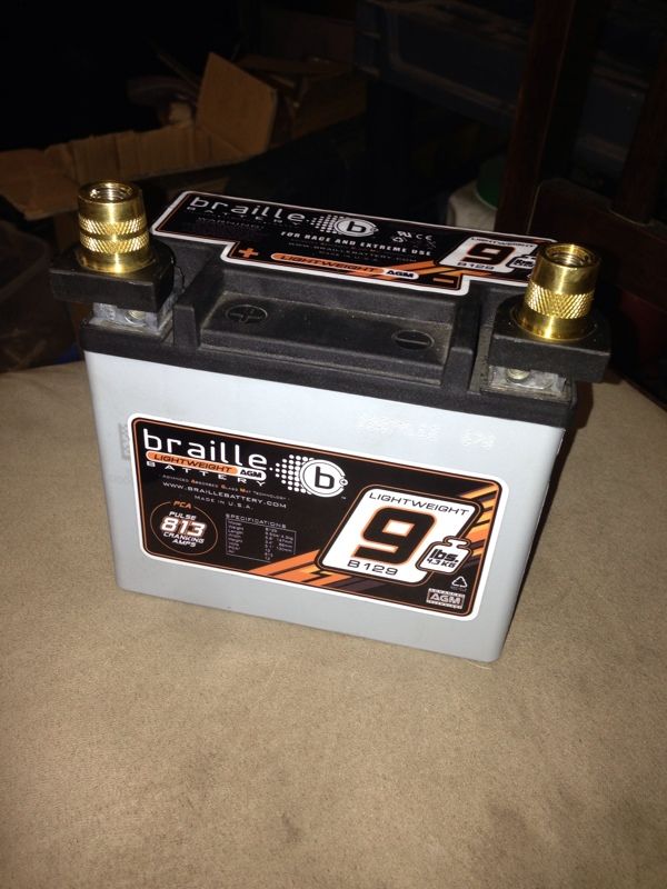

Got the fuel pump rewired, turbo timer in and functioning. Gauges are also wired and working. Hard wired my 1G cas harness in to the main harness.
I reciveived my Braille 9lb battery today in the mail. Crazy how small this thing is. Plan is to put it on the k member and be done.
Also got an idea from Joel (99gsxjoel) a few months ago so I decided to tackle that to.
Just being really slow with stuff but making sure I do it right so I won't have to do it again.
