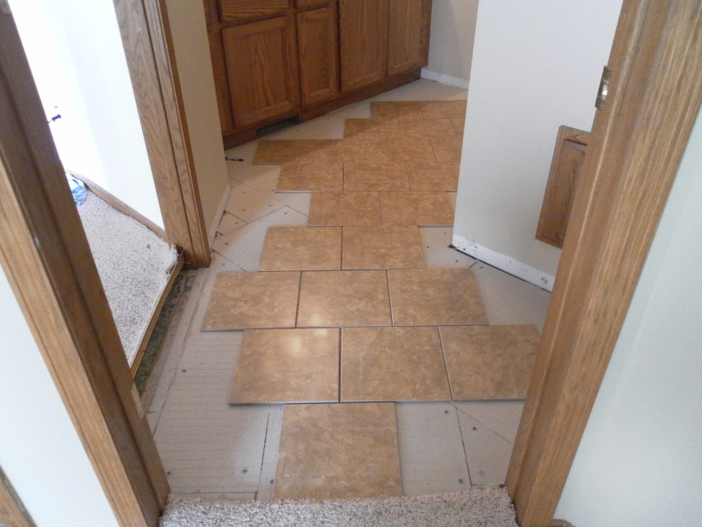

Started mocking up the tile to see how I want to lay it out. I think I like this pattern the best.

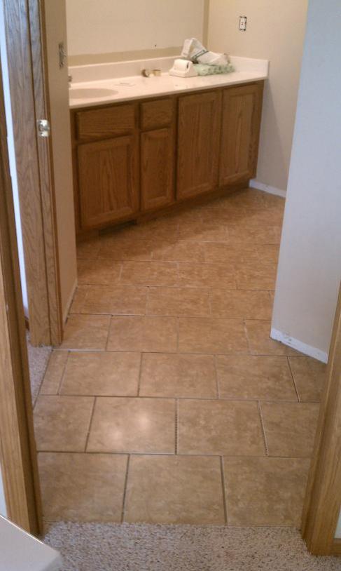

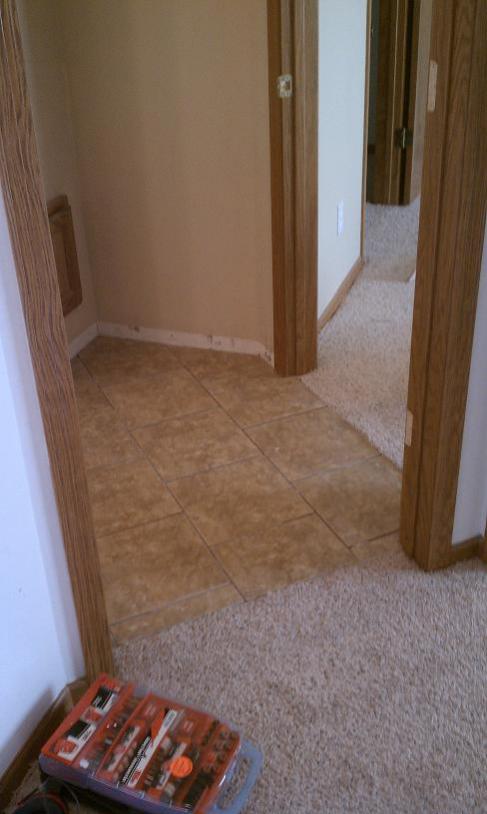

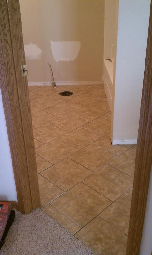

My bathroom project has been on the back-burner most of the summer. I went to town the last couple days though. All the tile is laid. Depending on how I feel tomorrow, I will either start grouting, or start painting.

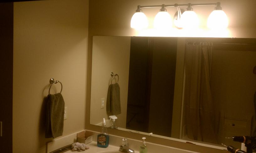

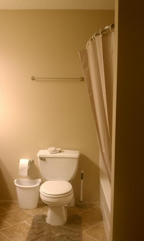

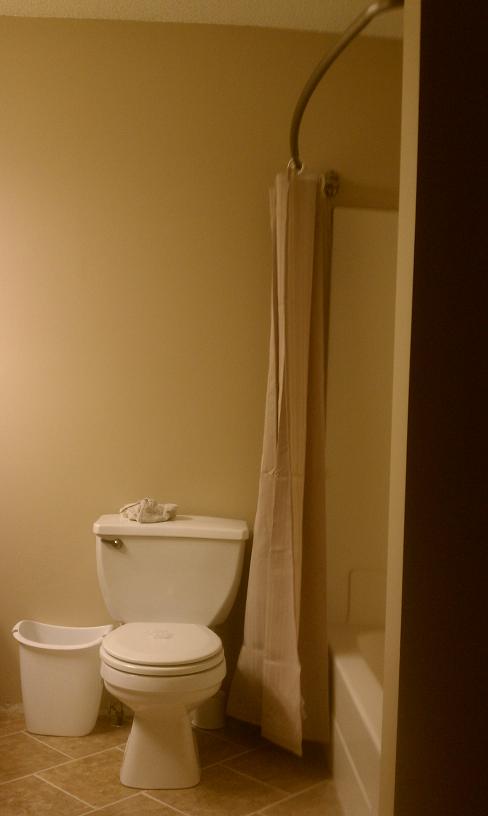

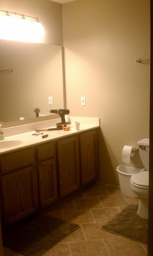

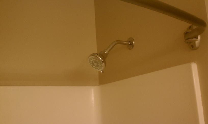

Update on the bathroom.
Tile is done and grouted. Toilet installed. New curved shower curtain rod and curtain installed, makes it feel so much bigger inside!!. New Towel Rack, TP holder, and Hand Towel Ring installed. New light fixture (found it on Uber Sale at Menards) installed. Old mirror put back up. New shower head installed. Also just grabbed the old floor mats and towels from before and put them back in. It'd be nice to get new ones, but trying to stay on a tight budget here. Walls painted Hirshfields Stone House 1039 Super Spec.
That's it for now. What's left is:
- Seal Grout
- Reinstall doors (need to trim since tile sits higher than old floor)
- Reinstall Trim
- CLEAN
