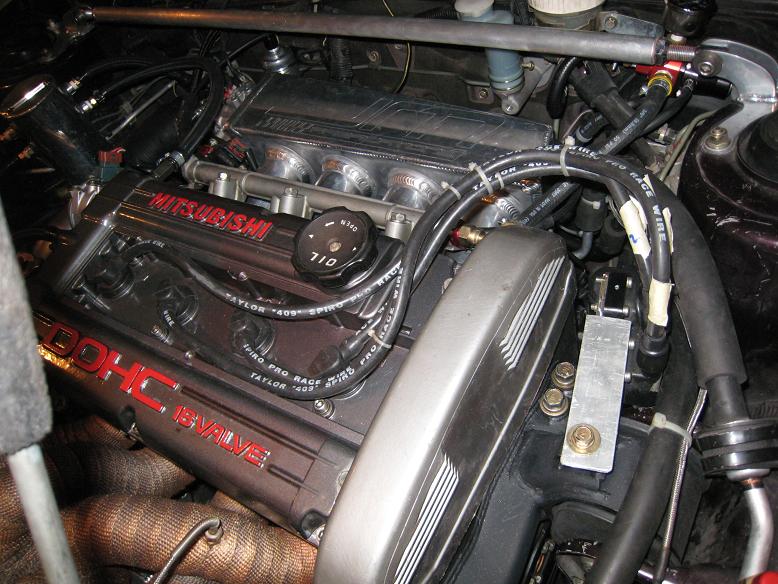

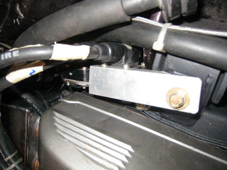

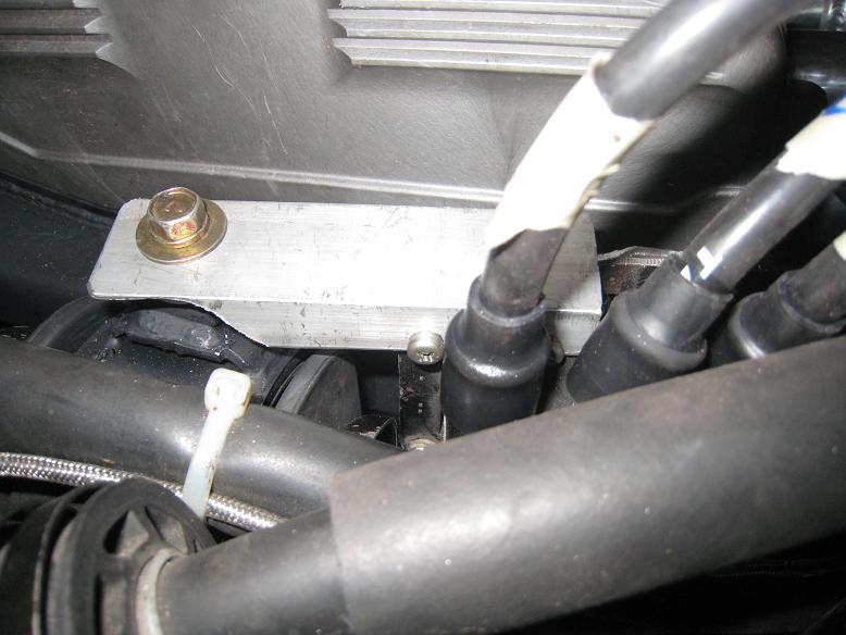

Made a new bracket to mount my coil pack to. I'll put up a picture once I can snap a picture of it. Pretty simple, but should work, so I'm happy.

Did a boost leak test, and as always, it leaked from the BOV flange. I sent the BOV back to Forge and they are putting a coupler style flange on it (like a 2g) so I can just couple/clamp it and never worry about a leak there again.
Also, here's a picture of my coil mount I made using some scrap aluminum I had laying around the garage. Just need to powder coat it black to make it less noticable. Anyhow, can't beat free

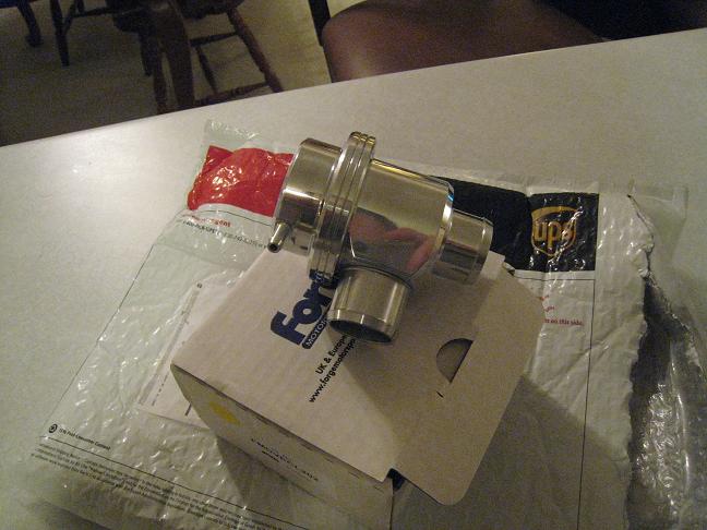

Also, just got my BOV back from Forge. Again, they didn't charge me a dime. And looking at what I just got in the mail, it doesn't look like the put a new flange on my 3 year old valve. It looks like they sent me a brand new friggin valve, for free!!! Definately would buy from these guys again!!!

Yup, turns out Forge just sent me a brand new valve, for free. Awesome.
