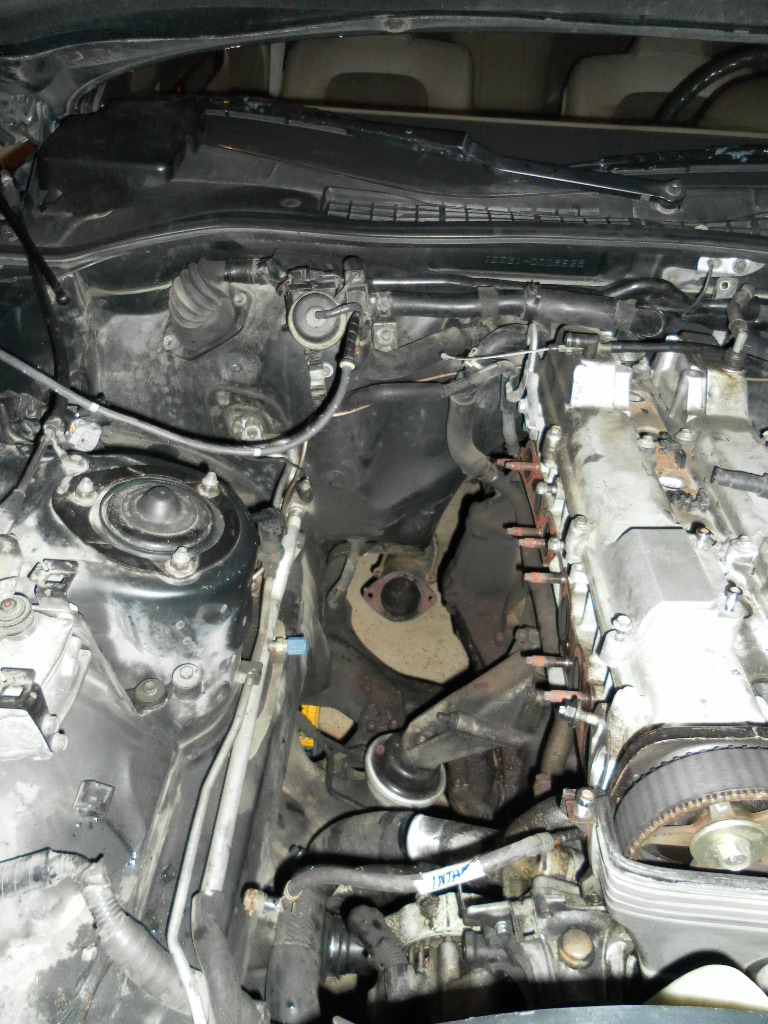

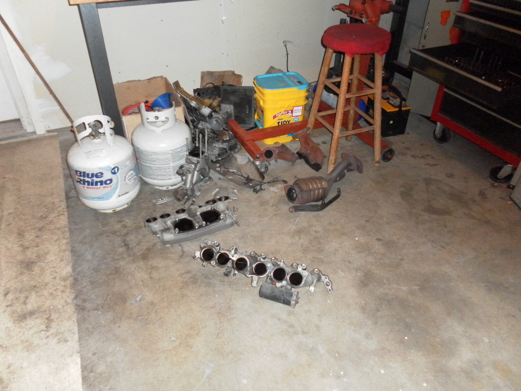

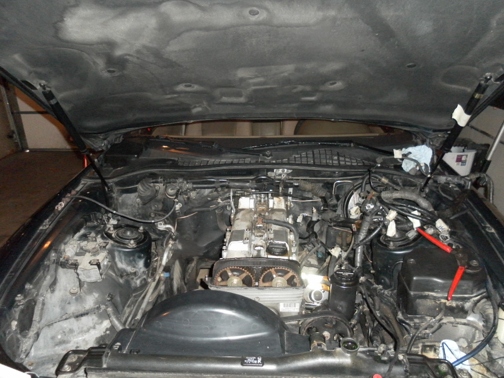

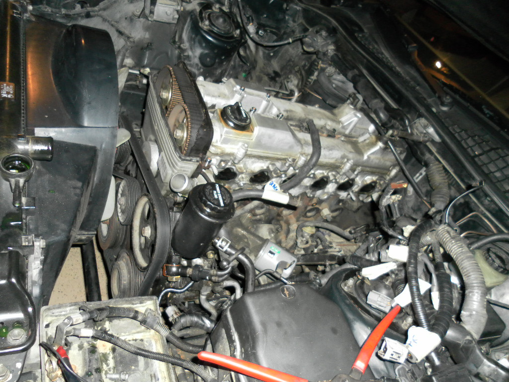

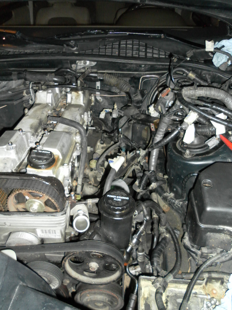

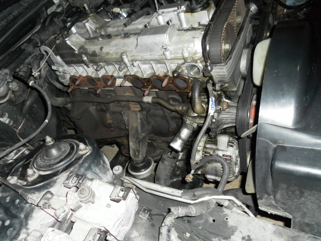

Exhaust and Intake side are torn down as far as I think I'm going to go. There seem to be so many random sensors all over the place, I'm wondering if they are all needed at this point?
Pics of how it sits right now after tear down:
One of the piles of shit that came out. That intake manifold can go to hell.
Big thanks to brownman for helping for a little bit. Also we got an idea. Stock mani's upside down fit perfect, so decided to go a different route. Got a line on some SBR 50 trims, should be sick!

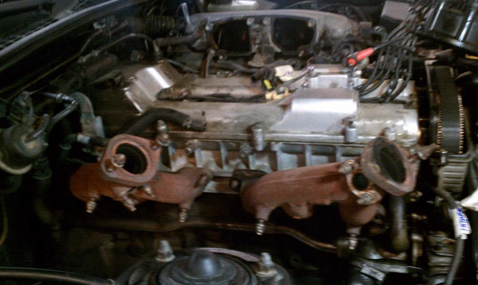

Those stock manifolds have baby WG flanges on them.

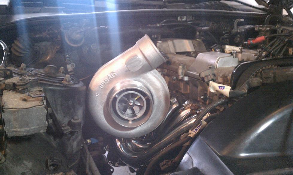

What are the specs on that turbo? Sorry if I missed it in the thread.
S300SX 84-75
Compressor: 61.4mm inducer, 84mm exducer, has ETT, rated at 72lb/min
Turbine: 75mm inducer, 68mm exducer (new style)
.91 AR Divided T4 exhaust housing.
For those that mostly know the Bullseye numbering, it would be somewhat similar to an S362.
